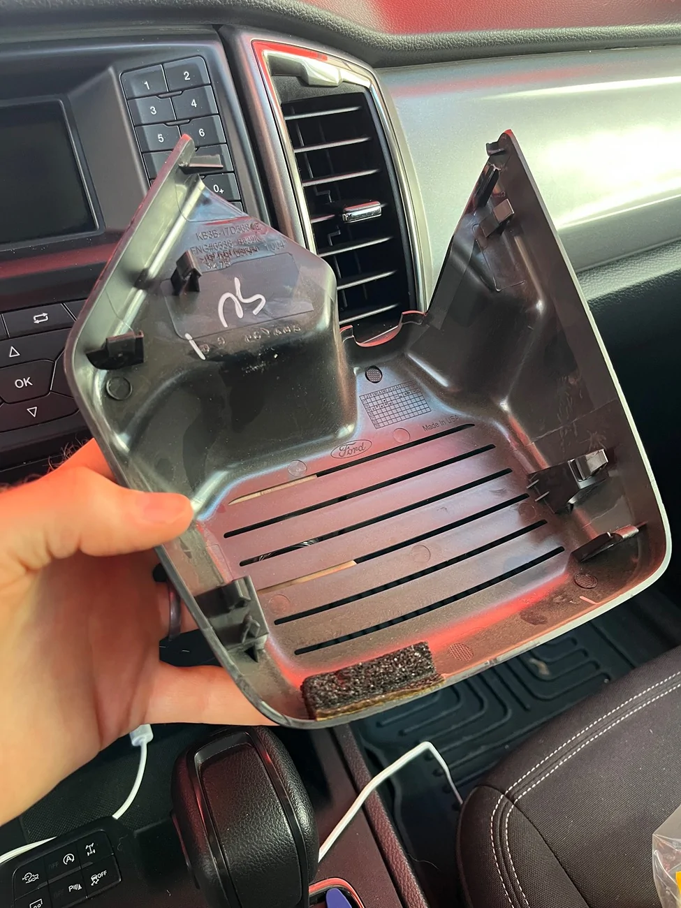

1) Remove the mirror covers
You need to remove the plastic covers surrounding the rear view mirror. Trim removal tools were all I needed.
The smaller, top piece was easier for me. The clips on the larger bottom piece required a lot of effort.
Take some care working against the windshield!
Helpful reference and images for removing covers: https://www.ranger5g.com/forum/threads/rear-view-mirror-swap.8686/post-167607
Here's what the larger bottom piece looks like removed:

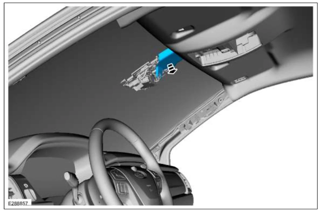

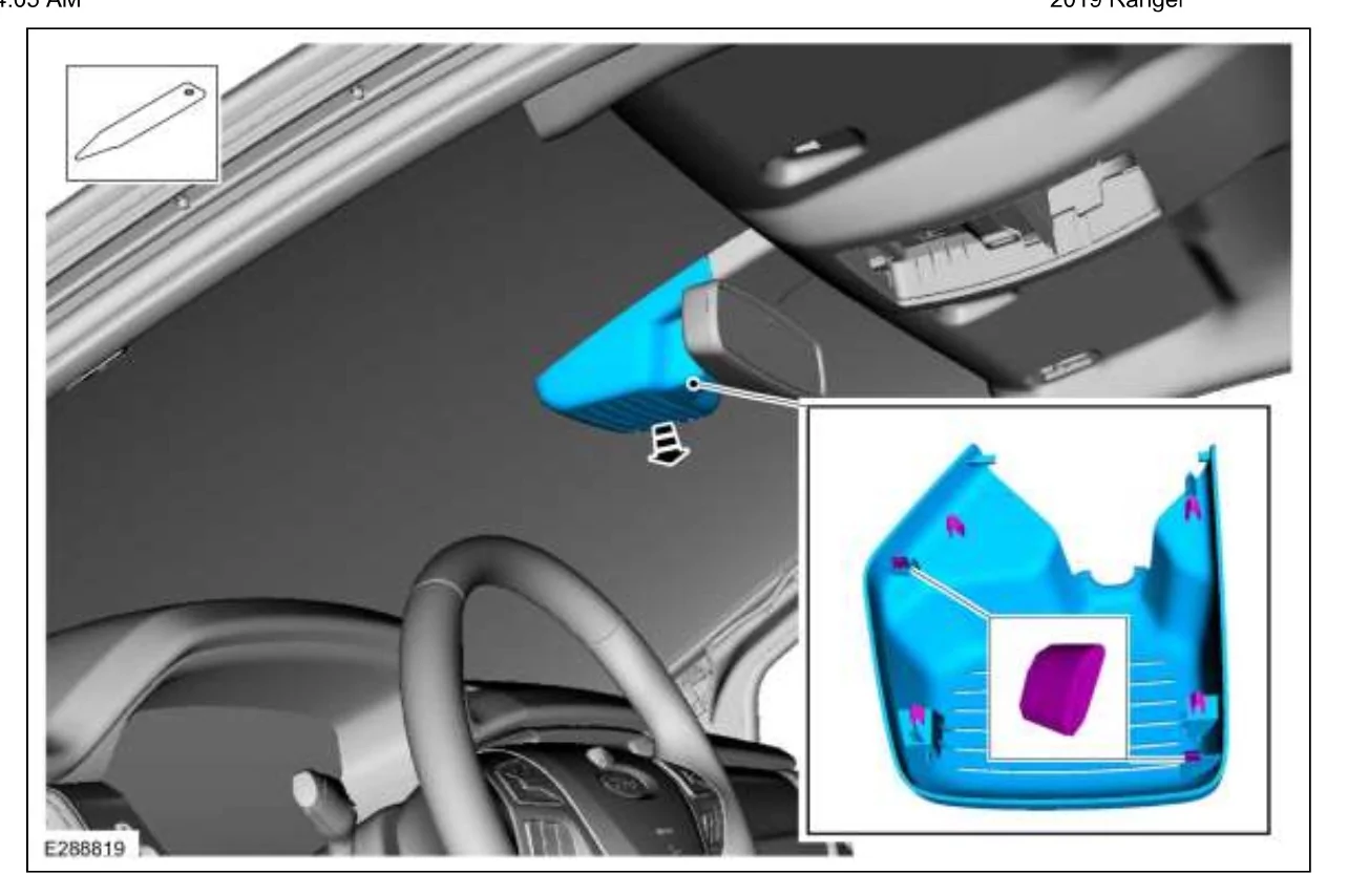

And some service manual screenshots for 2019 Ranger (501-05, Headliner Crew Cab):

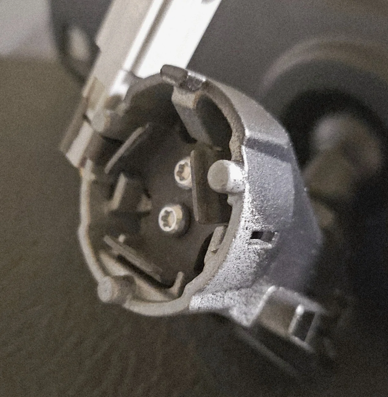

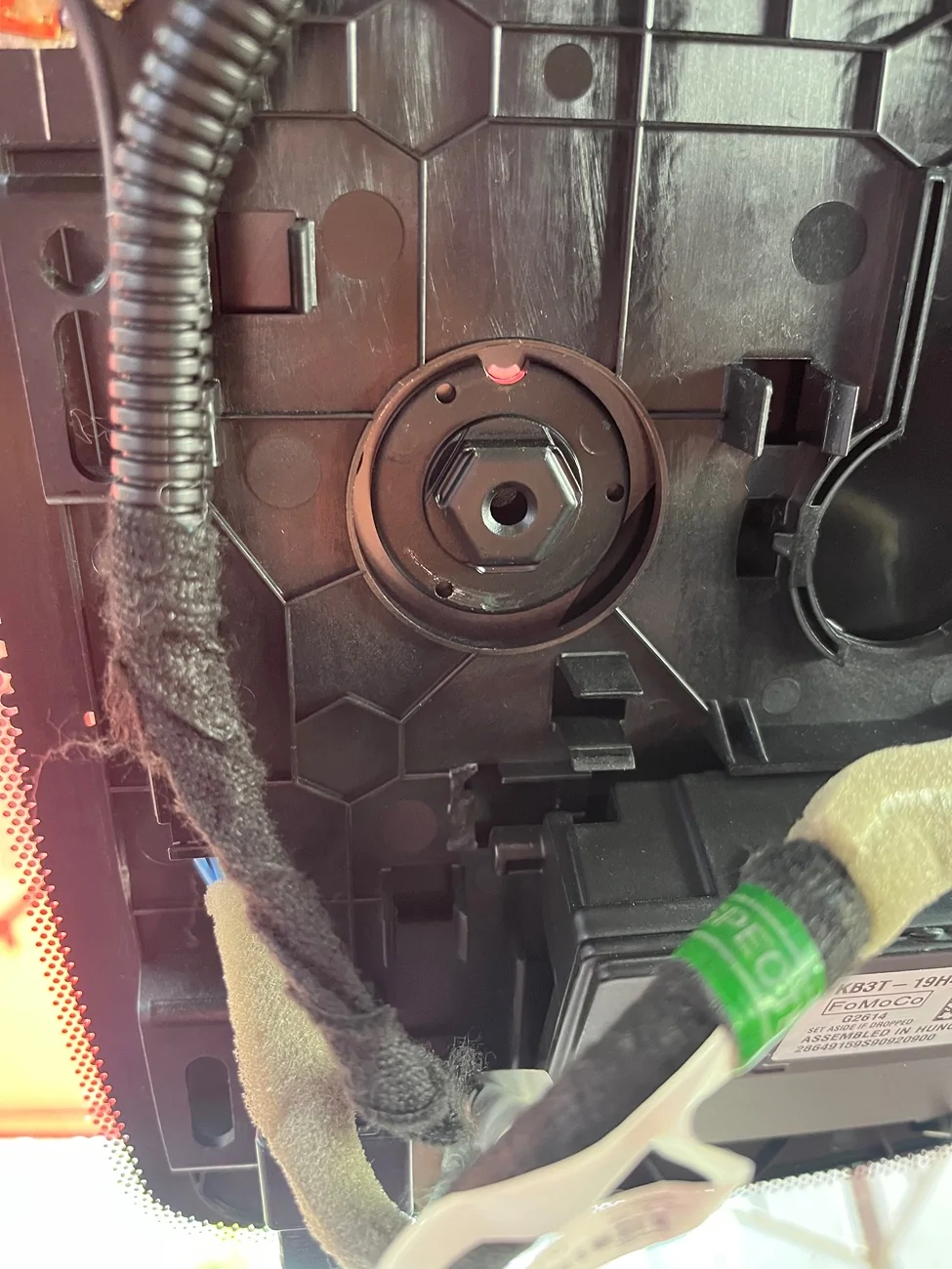

Picture of plastic base after removing mirror:

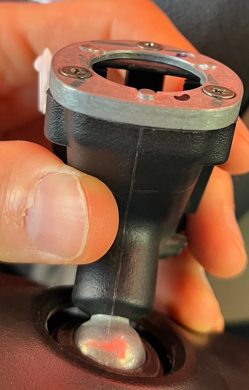

3) Inspect and Tighten Screws

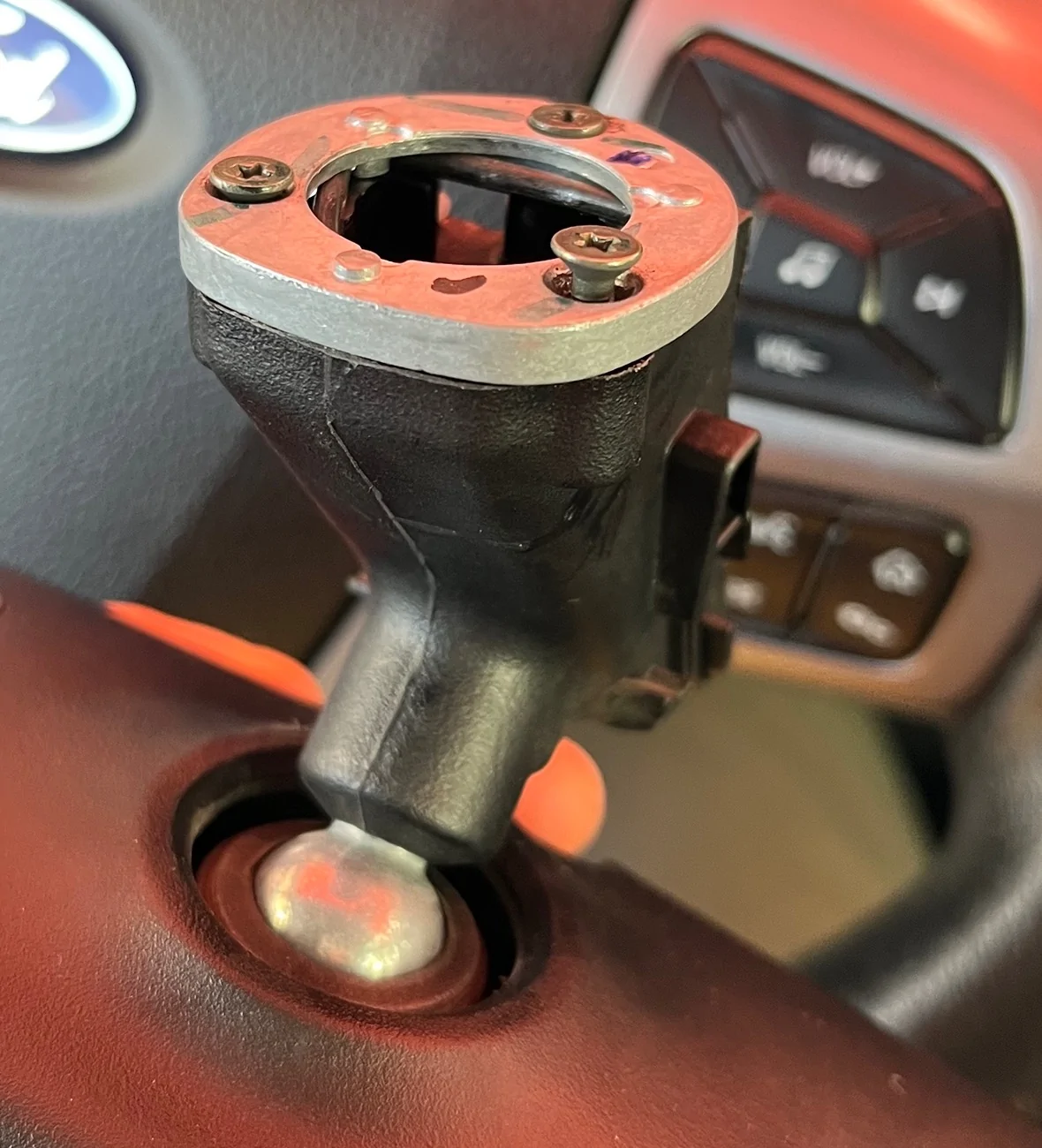

After removing the mirror, you'll see that it's connected to the windshield base with a small metal piece secured by 3 screws.
Here's a picture of what mine looked like after removal. No wonder it was rattling!
Check and tighten all 3 screws. Here's a picutre after tighening. There should be no more play between the plastic of the mirror and the metal plate:

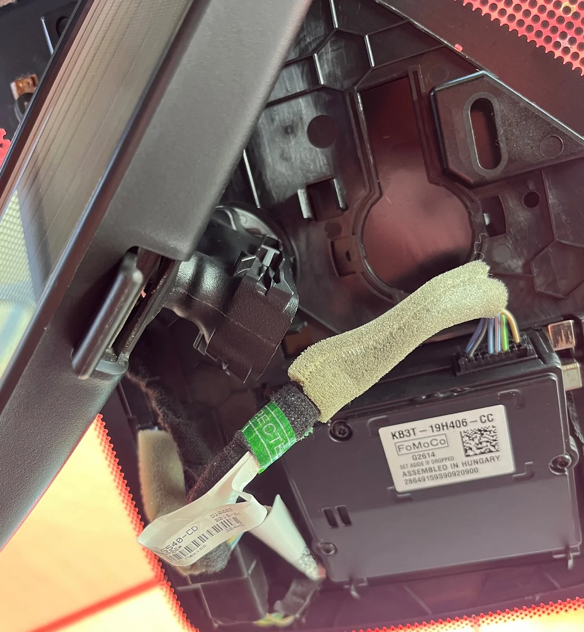

Nice write-up Kyle. It looks like you have the 300A pkg in your XLT. That’s a manual dimming rearview mirror, yes?
Hey @TDF017 - check out the mirror stalk on the non auto-dimming mirror above. It has a different interface than the auto-dimming, yes?

Thanks Duke! Yes, mine is a manual dimming rearview mirror.
Here's a photo of the mirror attached to the windshield:

I have the same one and was wondering if the stalk was much different than the auto-dimming mirror. It is! The auto-dimming mirror stalk is a one-piece unit.
