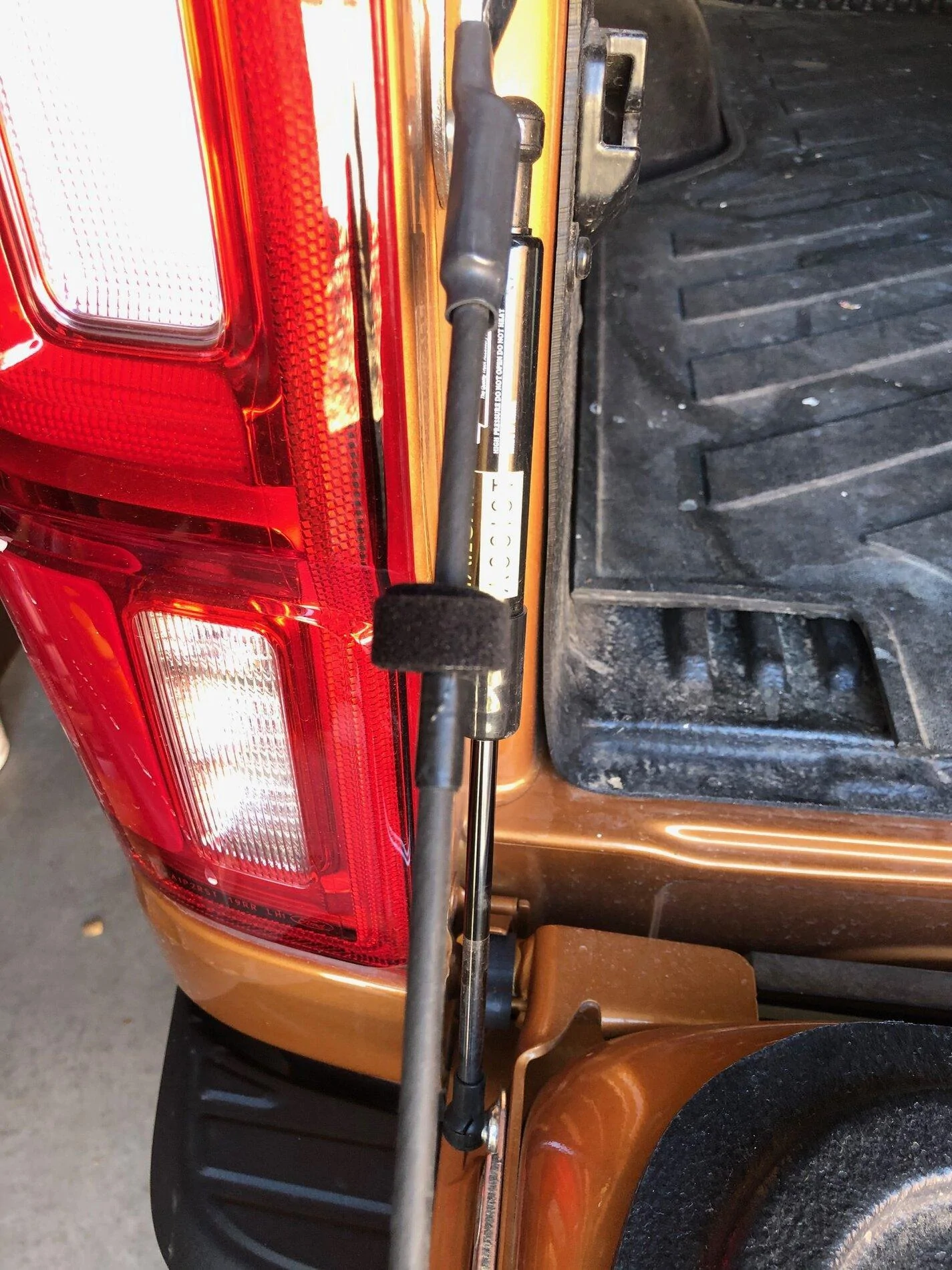

So, basically, train the cable by bending it out of the way when I close it?
Just add something like a velcro tie and it will guide the cable back to the side. I had a velcro tie from a HDMI cable and then added some black tape to the bottom this way it can't bind between the damper and the body.
Velcro:Tailgate Strap.jpg
