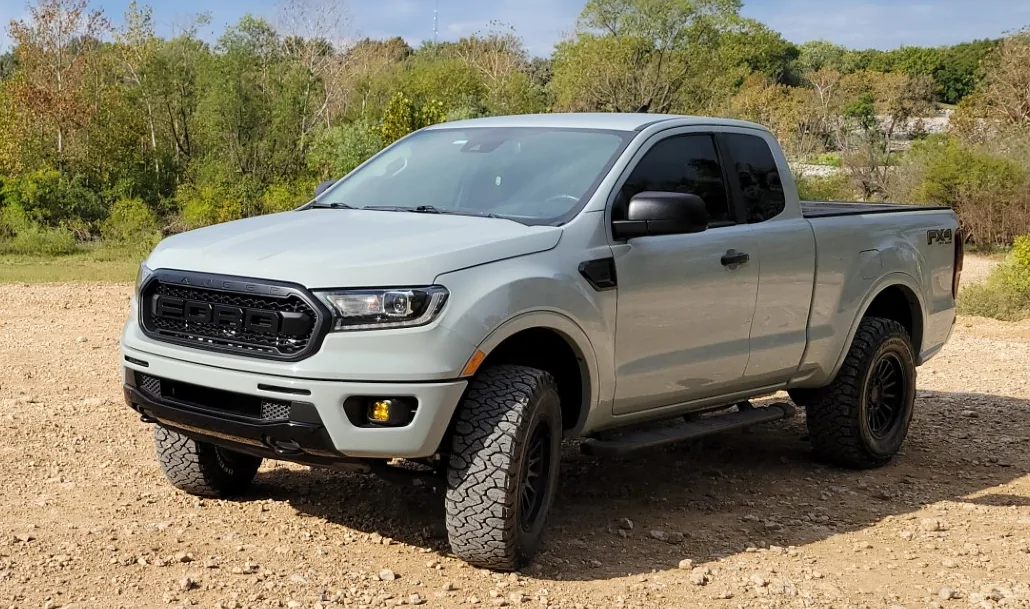

Getting ready to install the Fox 2.0 coil overs on my 23 Tremor and removing the leveling kit that is currently on the truck. I have about or close to an inch difference between front and rear. Want it leveled with the rear. After install I want to go with 275/70/17 with 1 inch or 1.5 wheel spacers. Would the tires clear the crash bars? Don't really want to change out if I don't have to. I do have new intrusion bars if all fails. I was going to go with 285's but changed my mind. Want to save some gas mileage. Thoughts.

I just did this, same tire size but my wheels have 25mm offset so no spacers were needed. I don't know if the tires would have rubbed or not as I just opted to install the readylift bars regardless. I installed the Eibach Stage 2R Pro truck kit. I would think you'd be fine since you're adding spacers.

Thanks, I will probably do a test fit at a local tire shop on one wheel then take it from there. If it works, all good. If not, guess the intrusion bars it is.

Tremor wheels are +42, not +55
Pretty sure that's correct. I have the ROW Ranger Raptor wheels that look just like Tremor wheels, but they are +55 while the Tremor version is +42.

I have 285/75 and love them, I don't notice any MPG dip, I notice the grade of gas more I get 19.1mpg with hig htest
