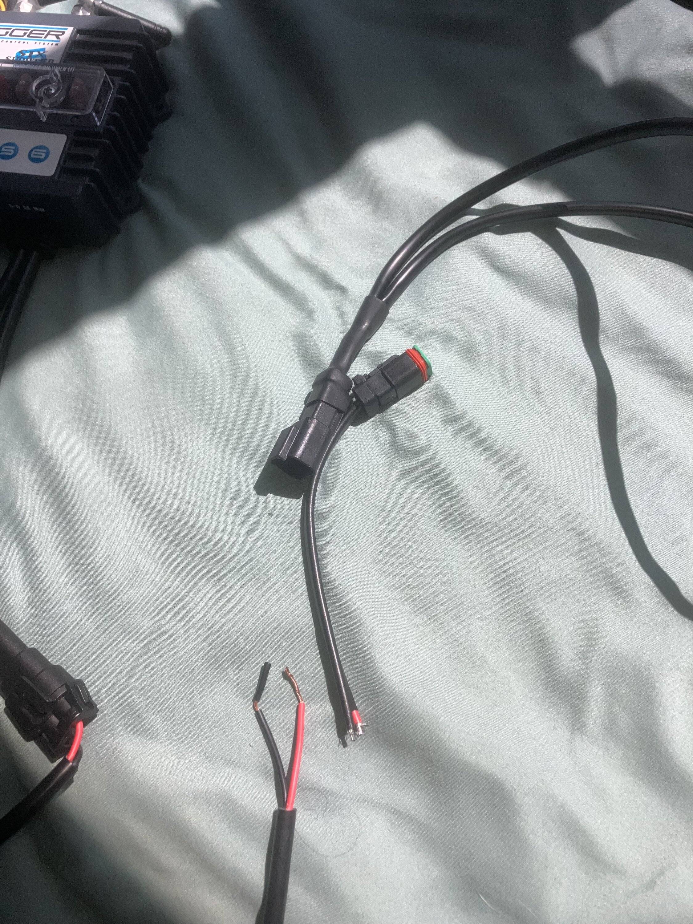

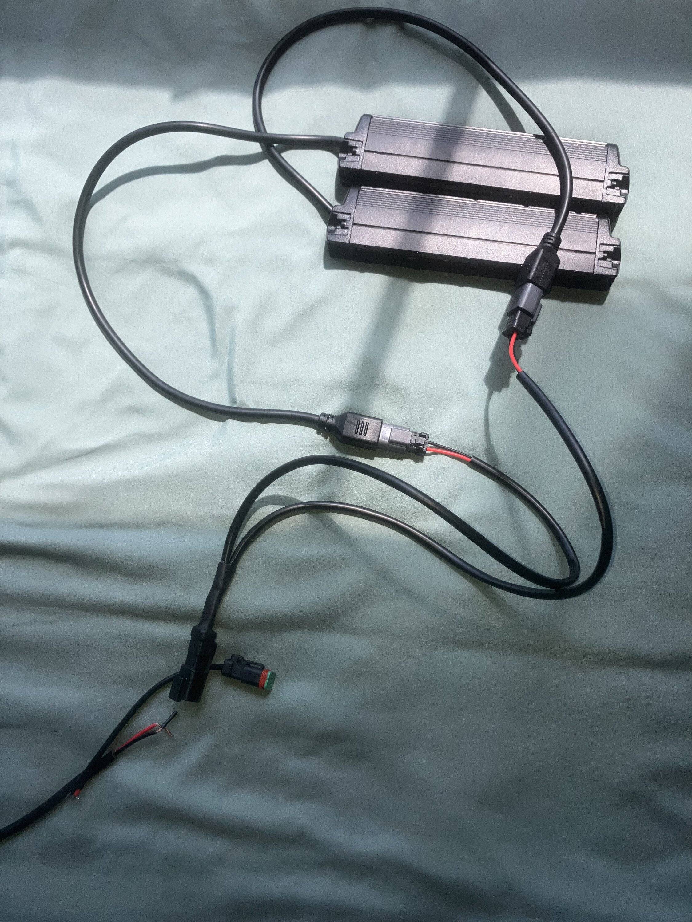

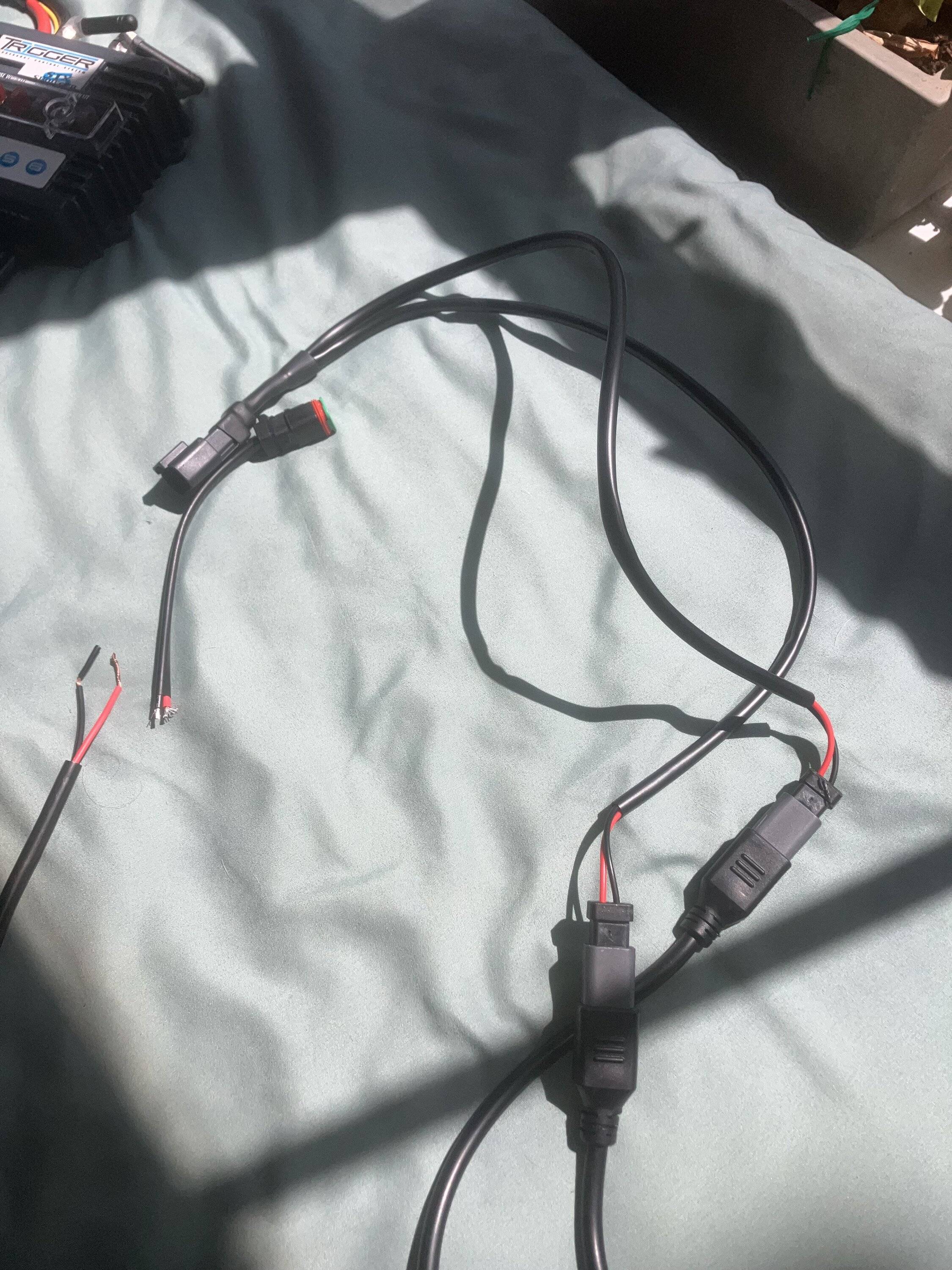

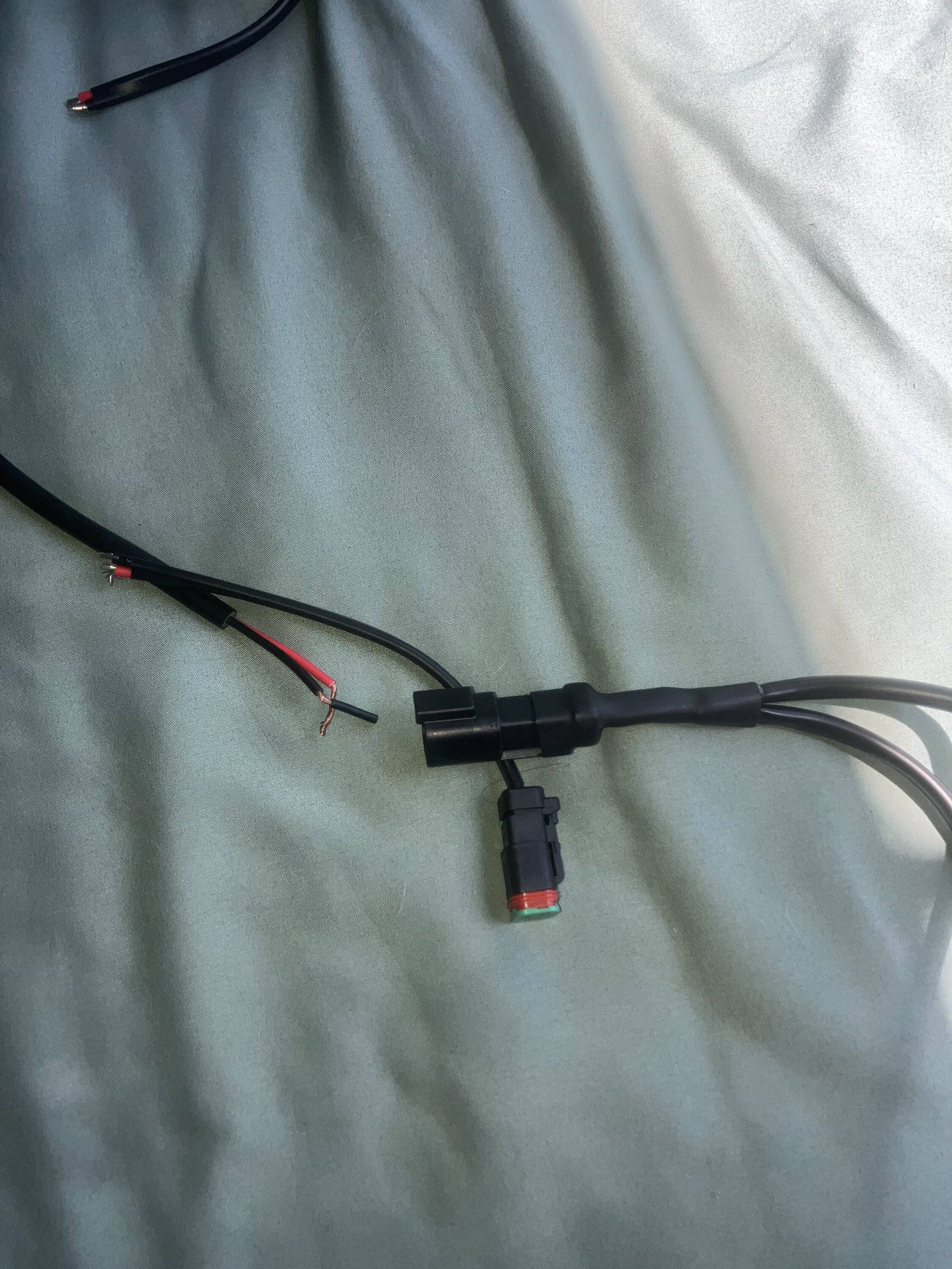

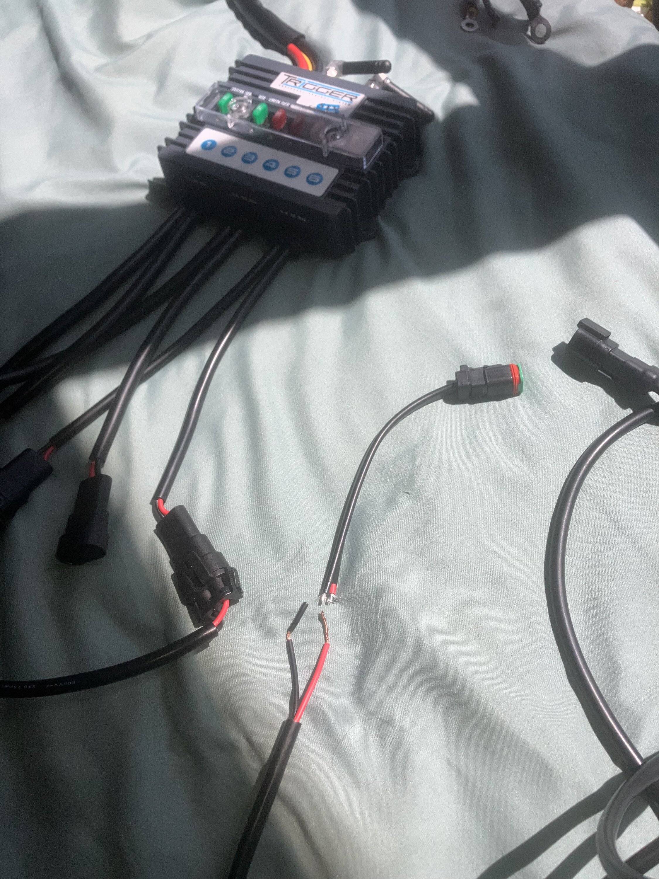

How would i be able to connect RC 6'' bumper lights to my 6-shooter switch, what wires should i cut? or should I not cut anything?
LED Light Kit | Bumper Mount | 6" Black Slimline Pair | Ford Ranger (19-23) | Rough Country
TRIGGER 6 SHOOTER Wireless Accessory Control System (triggercontroller.com)
What connectors are on the RC 6? You'll need to make sure it's compatible with the 6 shooter out...they're probably not so you can make your own adapter cable with one end that plugs into the light and other compatible with 6 shooter's harness...I'd use the #1 5amp outlet and save the others for higher draw lamps...
