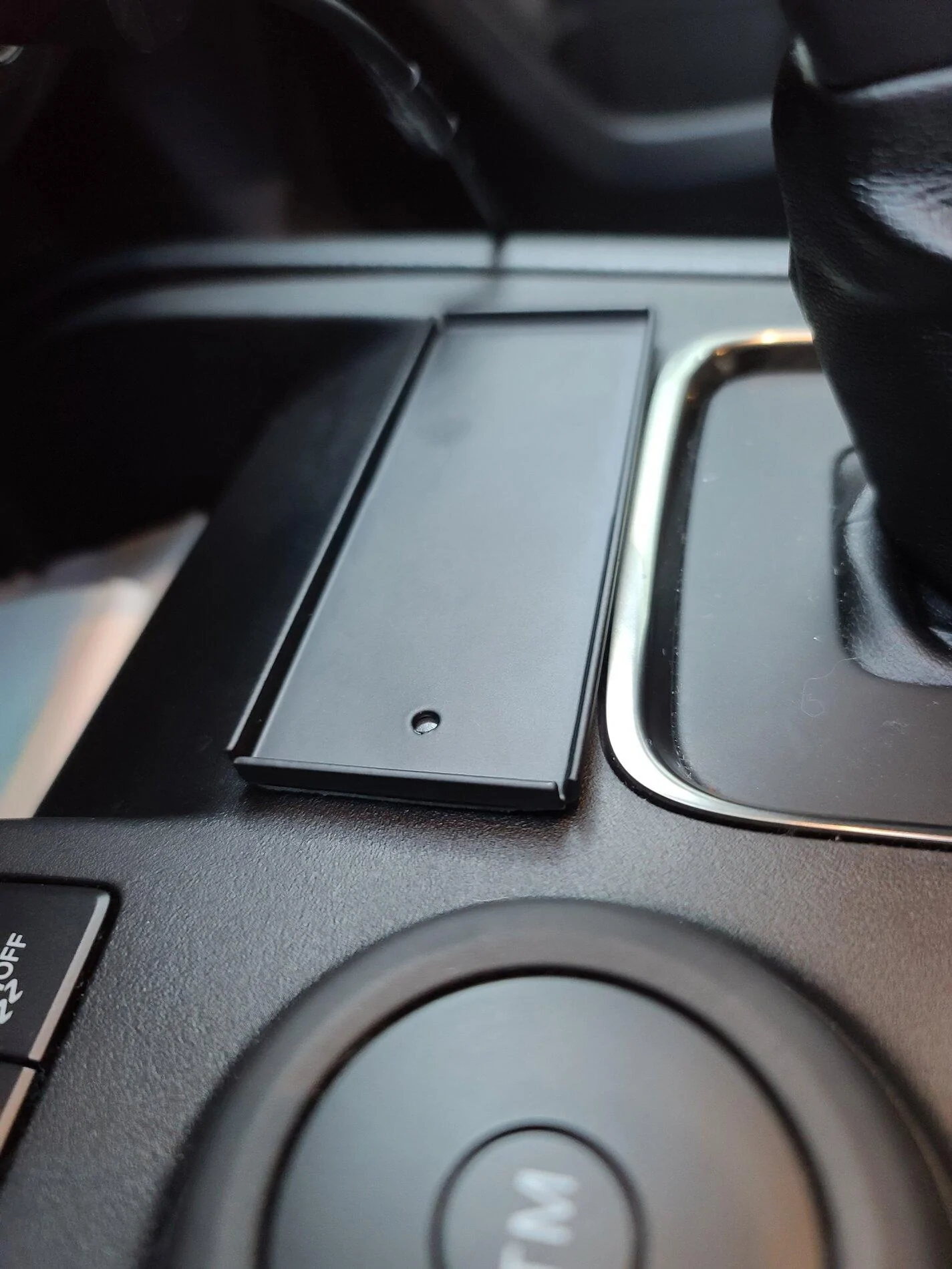

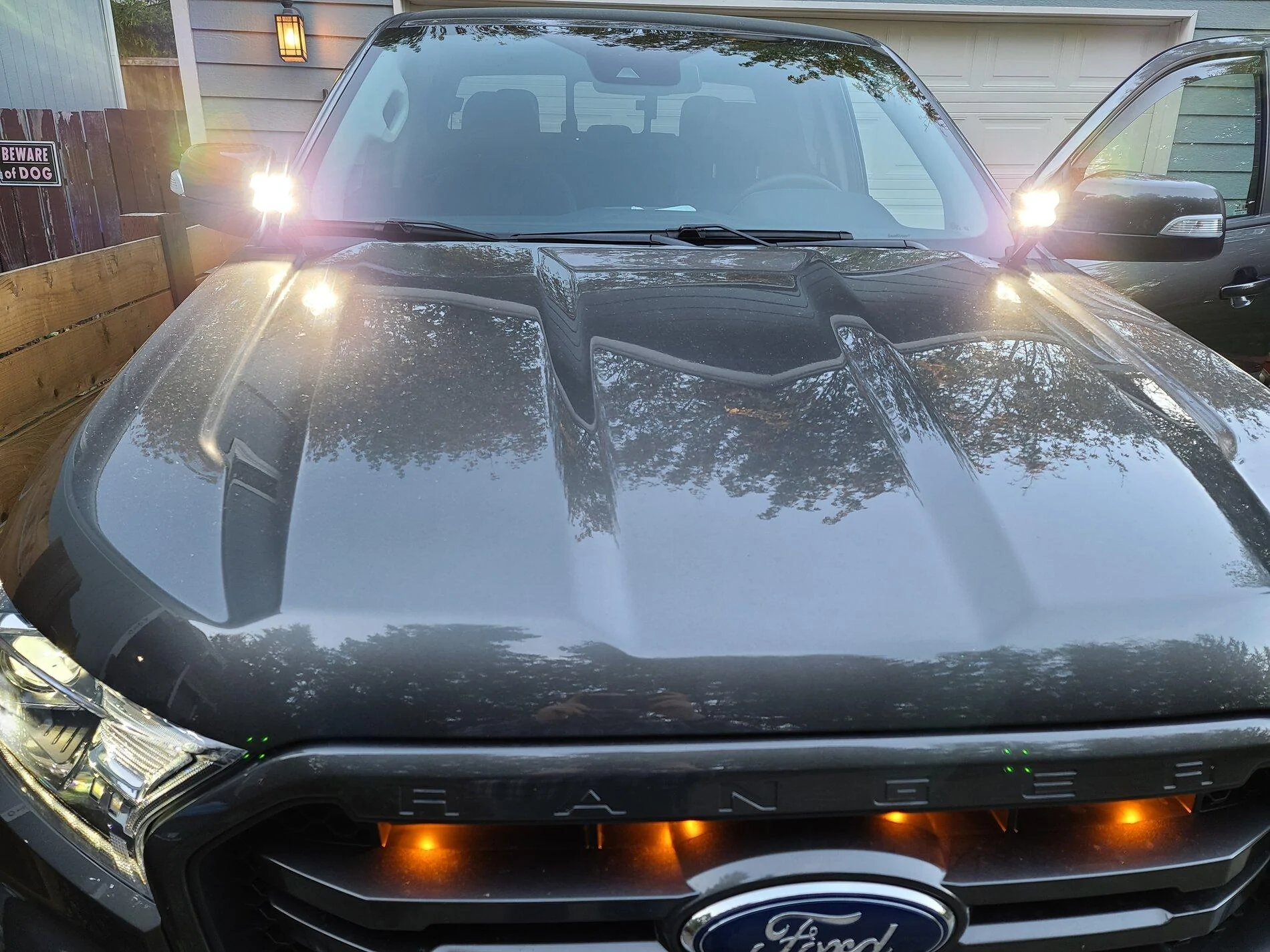

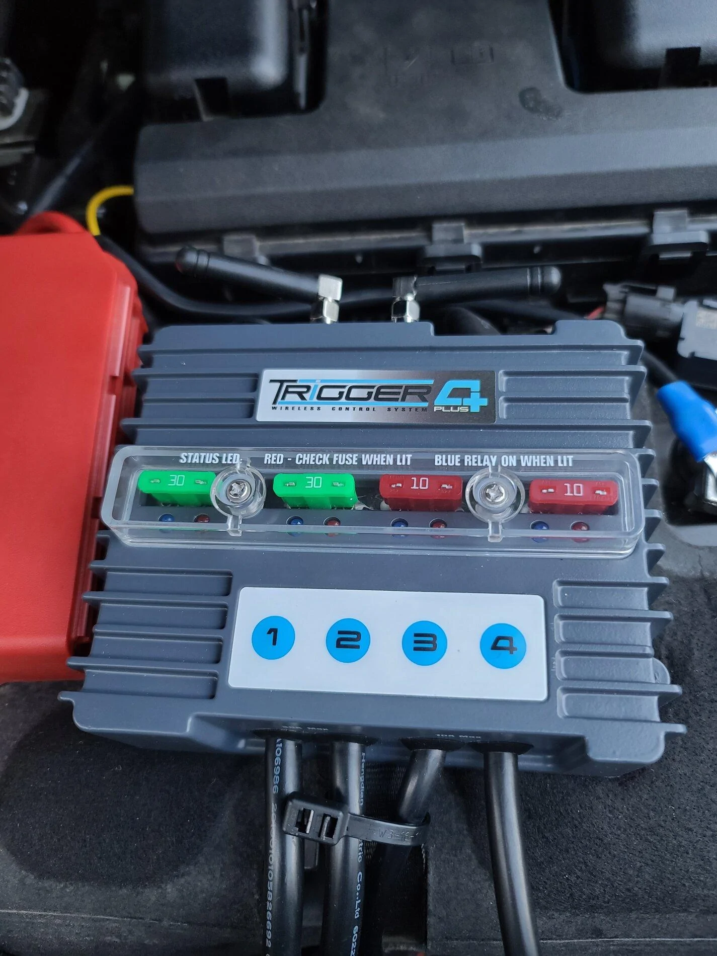

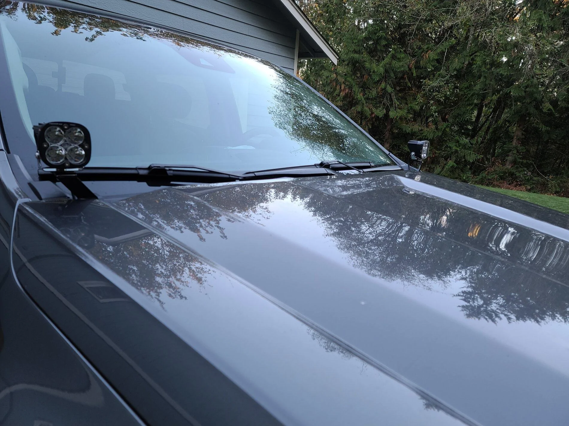

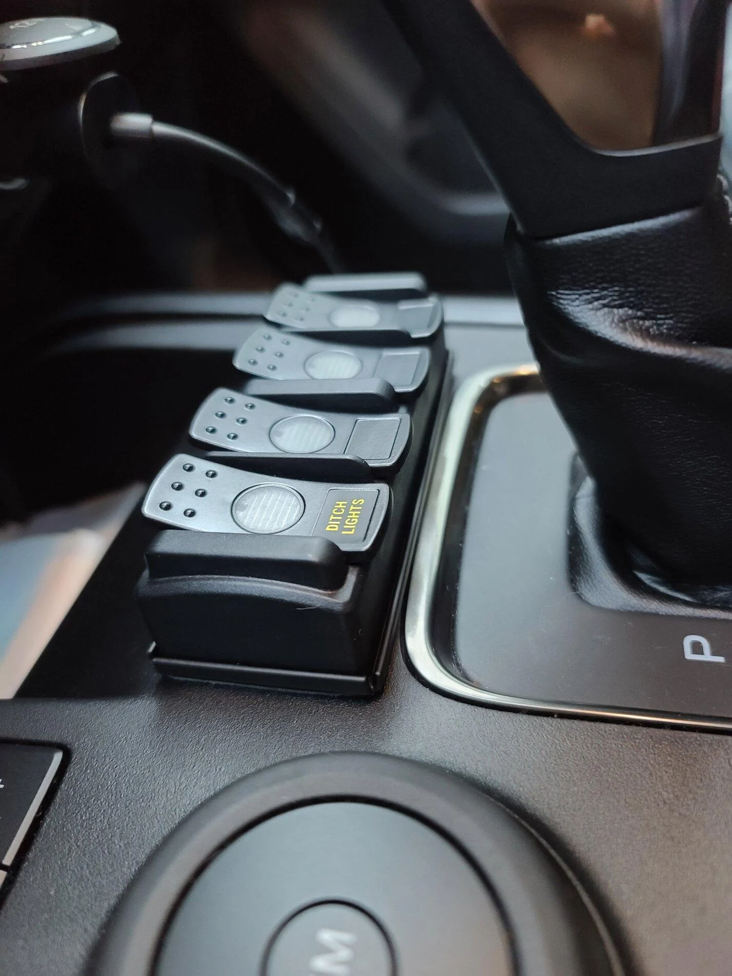

Added the Squadron pro A-pillar lights and the trigger 4 plus. I went the easy/lazy route and velcro and zip tied the controller on the battery. Did some sheet metal work and made an 0.050“ tray, powder coated or and double-back taped it in front of the shifter. Simple but very functional. I didn't tap into the fuse box in the cab, I used a fuse tap under the hood in #24(10A)
