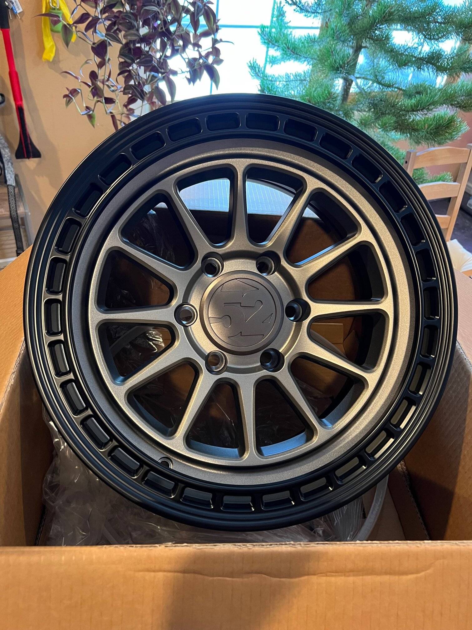

Got my new wheels today, 52Offroad Range HD, and I am getting them on tomorrow at 9! Stoked!!!

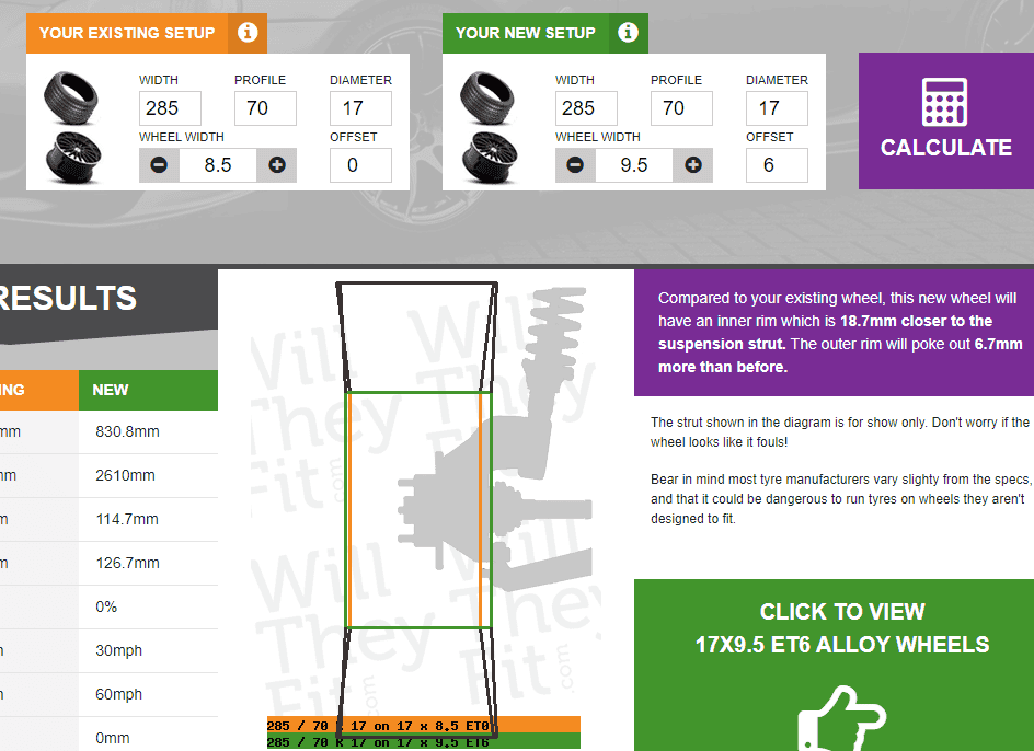

meant to quote this one here but what are the specs of both wheels and tire size? i have a calculator that will roughly show the difference
but without knowing the dimensions the thing that will change is how the tire looks on the 9.5 the tire will be a perfect square look vs a 8.5 will sunk in towards the wheel
The old wheels are 9.5 wide / +6 offset / 5.49 backspacing
New wheels are 8.5 wide / +0 offset / 4.75 backspacing

sadly this wont show backspacing but overall it shouldnt be to off maybe? with you taking away a inch in wheel width you make up in offset so you should poke the same or right around the same the only difference will be the way the tire looks mounted on the wheel

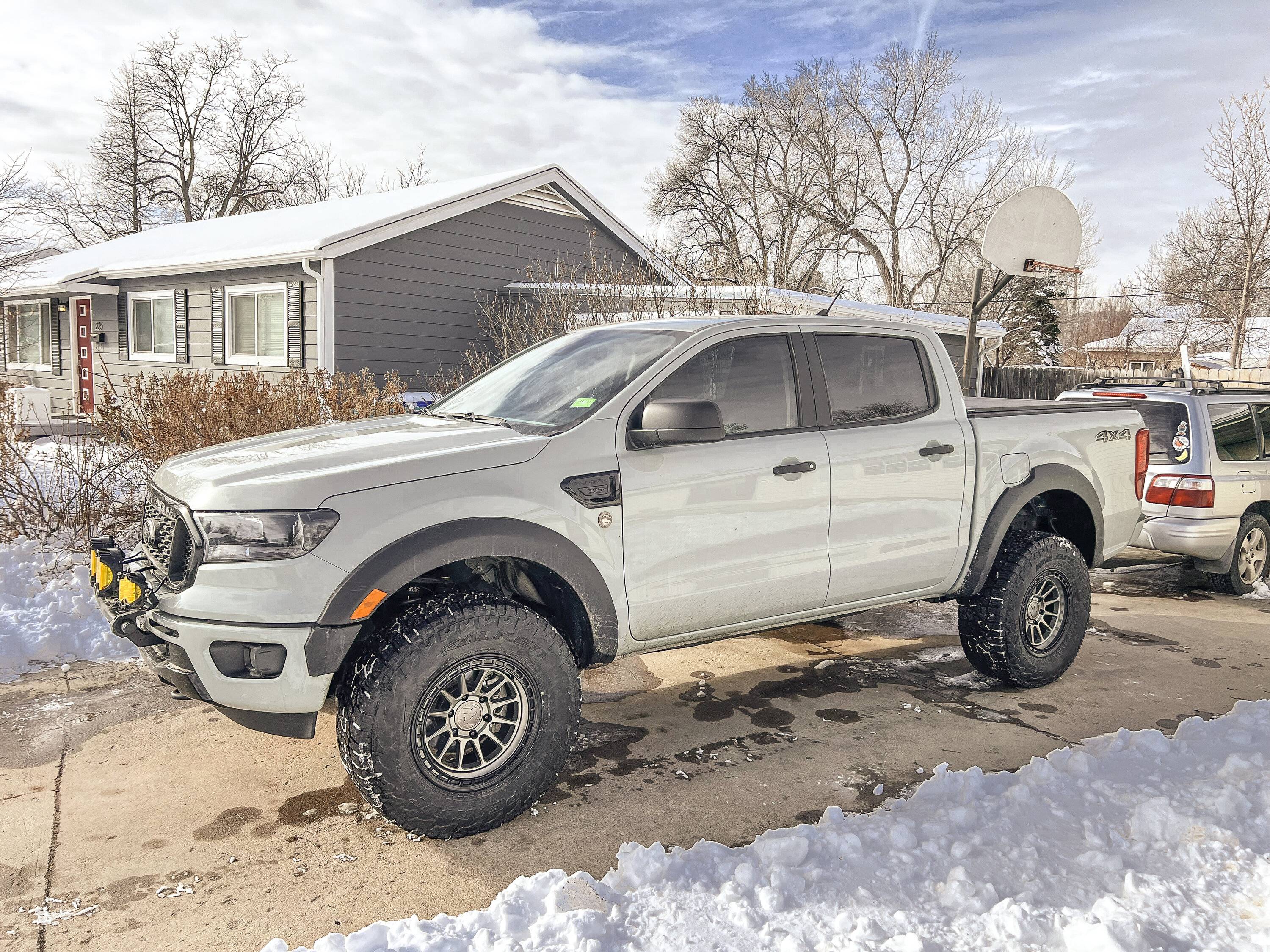

Slowly coming along. Got the new wheels on. Got the new Raptor grille coming in next week. Can’t wait for the canopy camper to get done in June so the dang rear sits lower, the rake is killing me.
hows the poke now? still pretty close to what it was?
also that front bar? thats not the svc thing is it? ive been wanting a set of lights in that area so its out of the way for when ever i order my winch mount
also also (lol sorry) how long the wait for the camper?
Exactly the same as it was! Quite happy how that turned out. Yup it’s the SVC bar, it will work with winches, I have mine sitting in the garage waiting to be installed but waiting for it to warm up.
