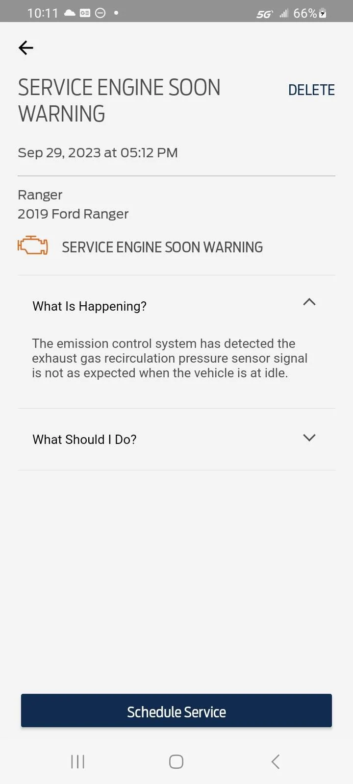

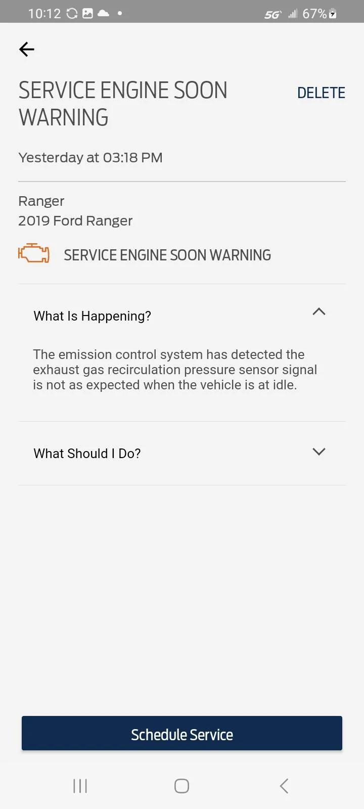

Twice the check engine light has come on, twice it has shut off by itself. Everything on the truck is stock except for the transmission pan that I replaced for a larger capacity aluminum one. Any ideas why this is happening? Id appreciate any feedback or advice. Thanks in advance.

The DPFE sensor , just search here , it’s plagued the Ranger.
If you pull the code it will be P139C
