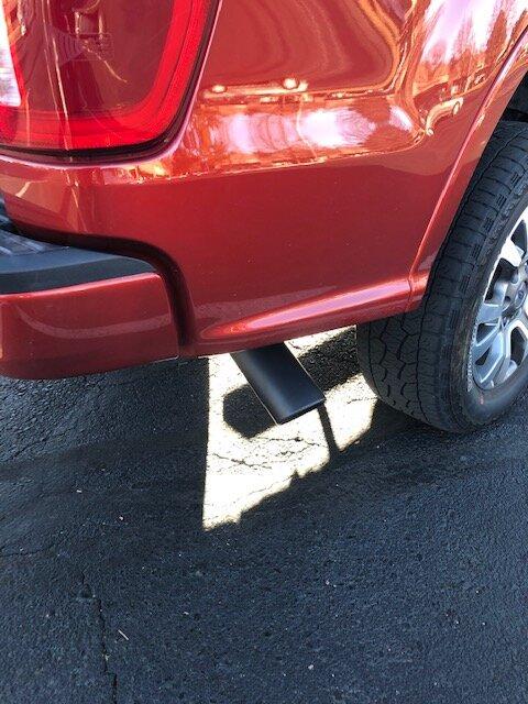

I installed the Gibson Black Elite Single Cat-Back system this past weekend. It was very easy without a lift. You need to cut-off the muffler at the rear with a hacksaw so you can get the stock system out, especially if you have side steps installed. Only issue I had was their instructions were not correct on order of install. Due to the rear pipe hanger being different, you need to install the pipe into the hanger then bring the muffler and the rear pipe together.
Love the sound she makes now, and lots of power in that 2k - 4k range.
