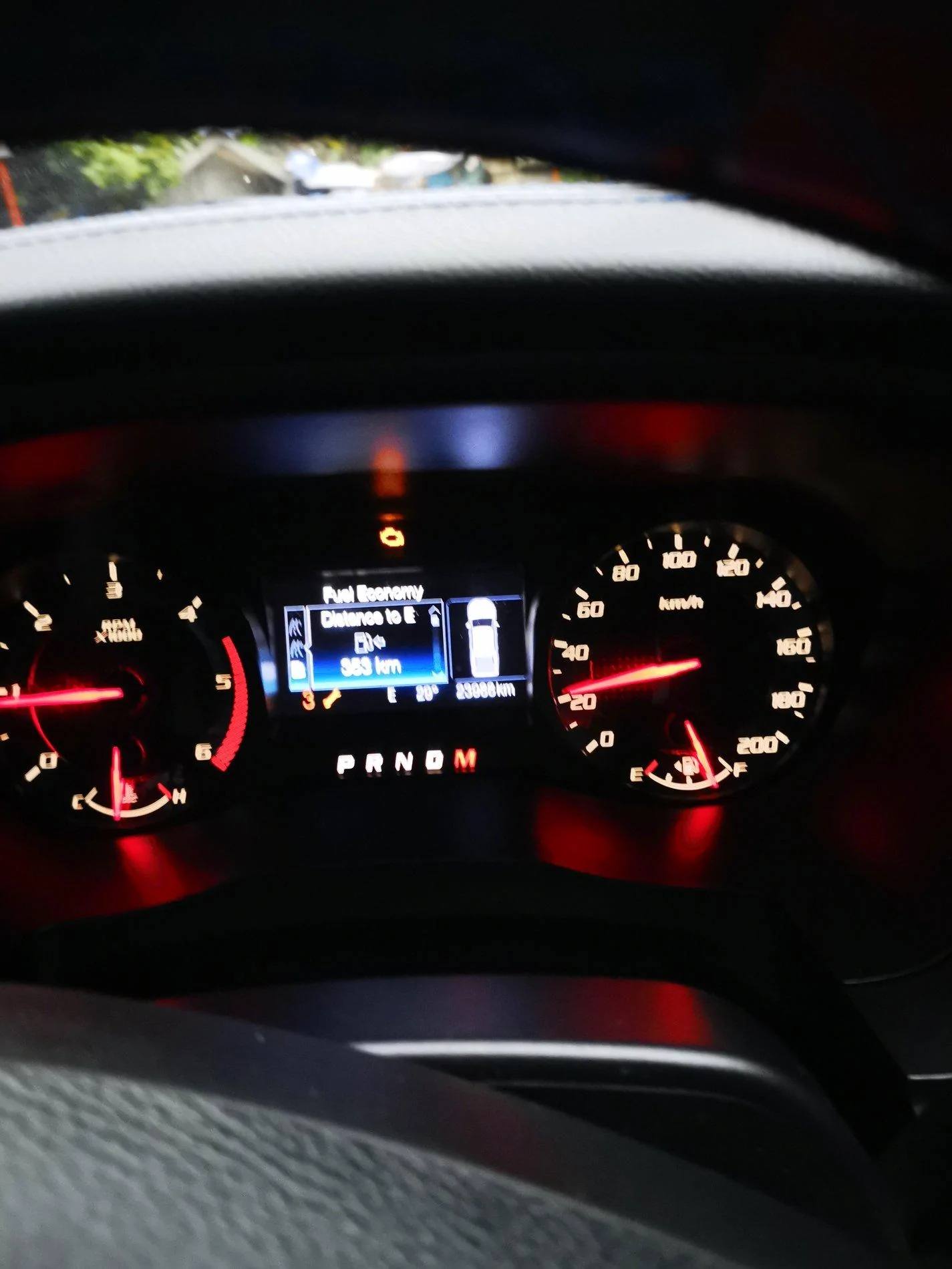

Can someone please help me, engine amd wrench icon on 2019 ford ranger raptor
Rod
Rodolfo
May 12, 2019
Philippines
This icon started to lit up when my mileage reached 23k,i brought it to ford for oil change but after 4 days it still come on, how do o reset the oil chanhe lofe because there's no oil reset in settings menu amd also i cant pressed both the brake and acceleration without turning on the engine because it's a push start

And by the way is this really for the oil change because ford pass oil says 0%

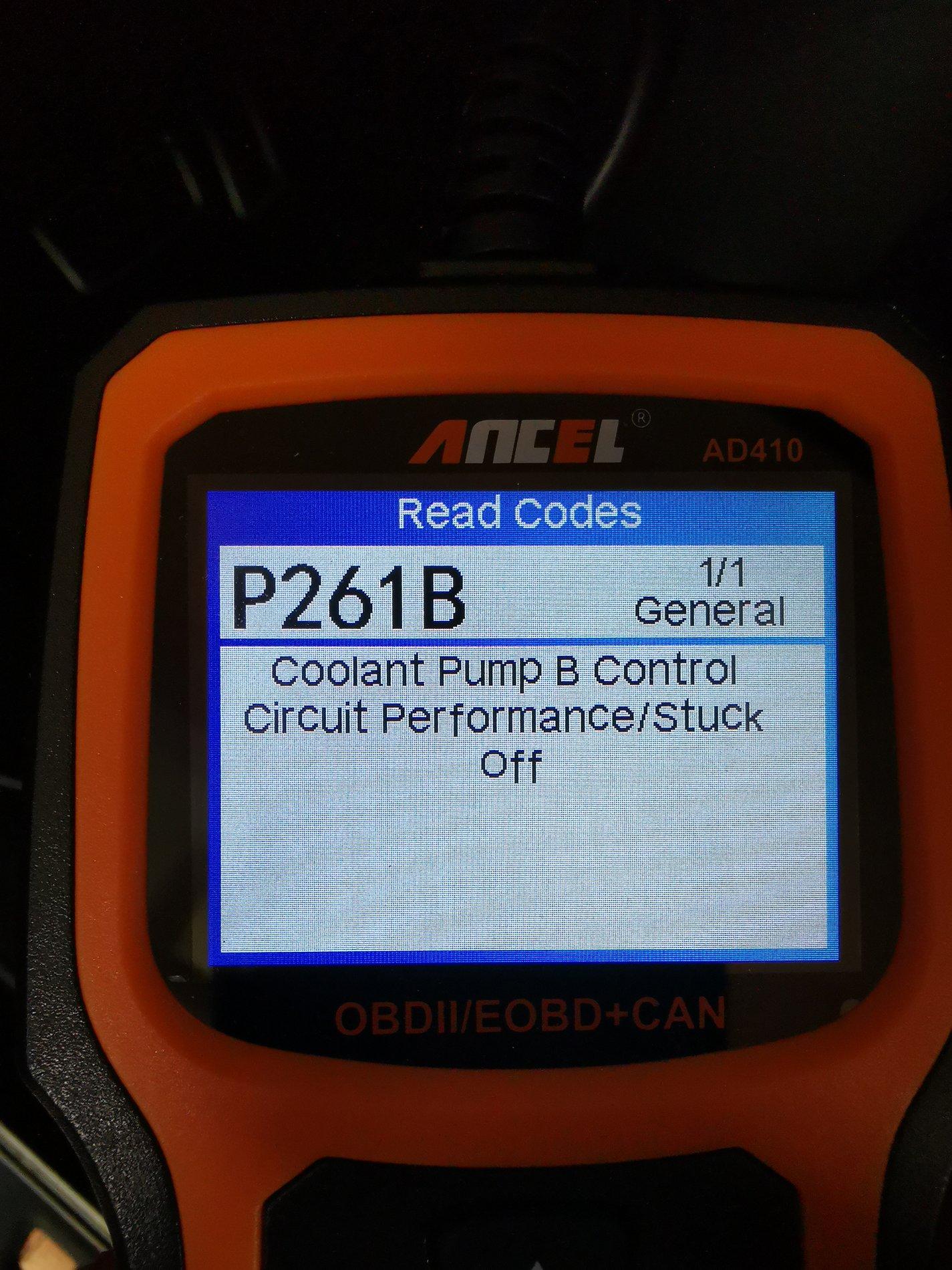

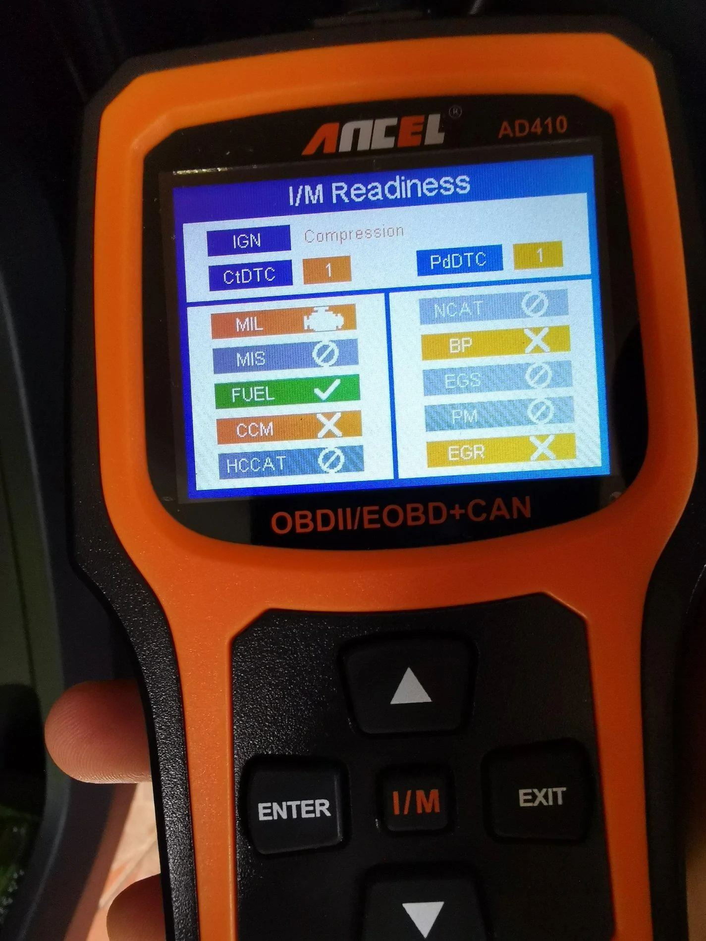

Thank you for the replies, a frirnd have a scan tool this is yje error can someone help if this is easy or should i bring to dealer??
