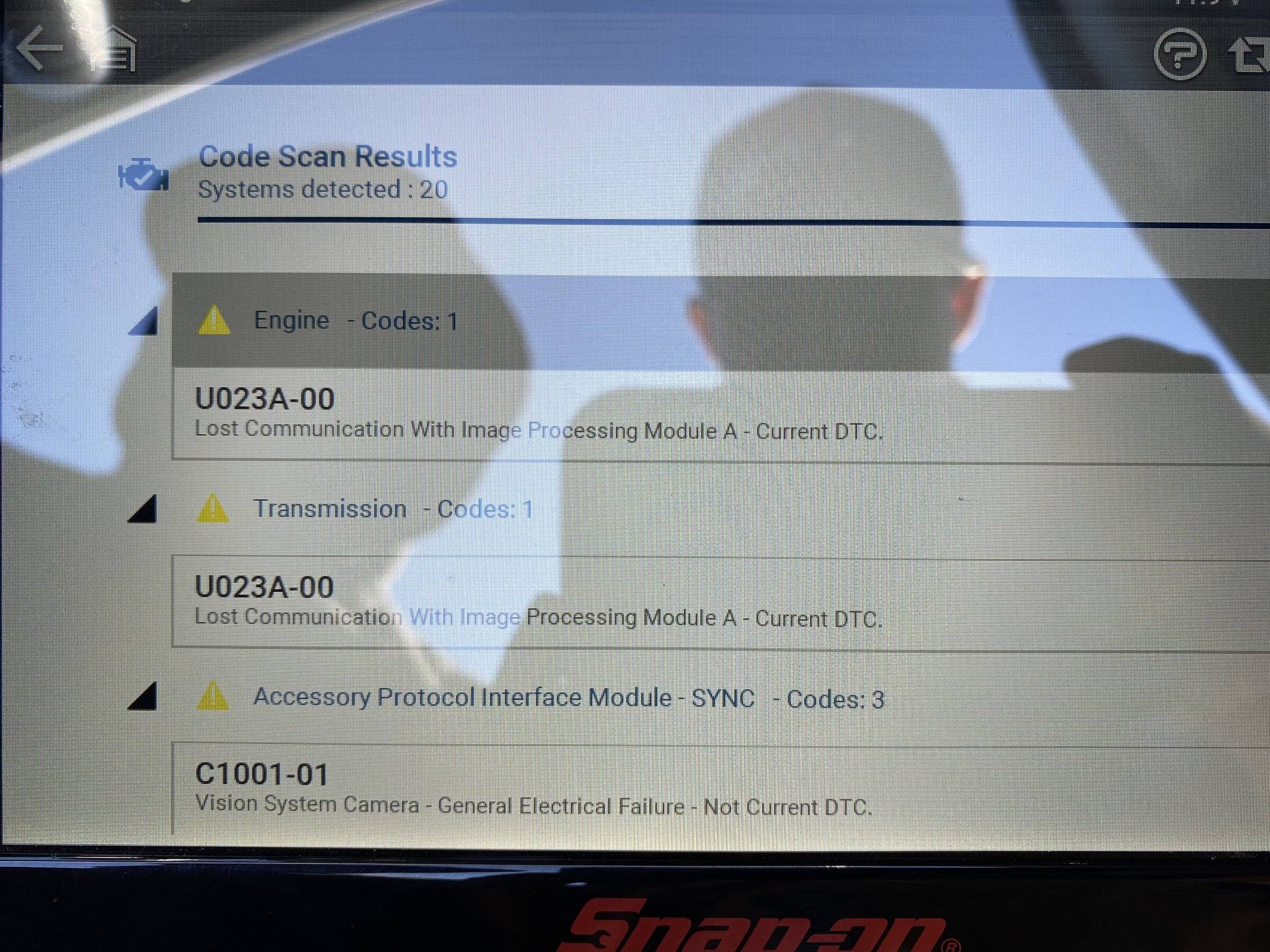

Update for anyone following:
the Ford dealership it’s at has yet to find anything, and is stating, with lack of evidence, that is is the amount of “accessories” the truck has that has overloaded the CAN bus system.
So I’m not an engineer, but I have worked in off-road shops and do a lot of my own work still, and this makes little sense to me. Everything is properly hooked up and fused, and ford even said themselves that the battery and alternator are good. This Is a list of what is installed, electrically, on the truck:

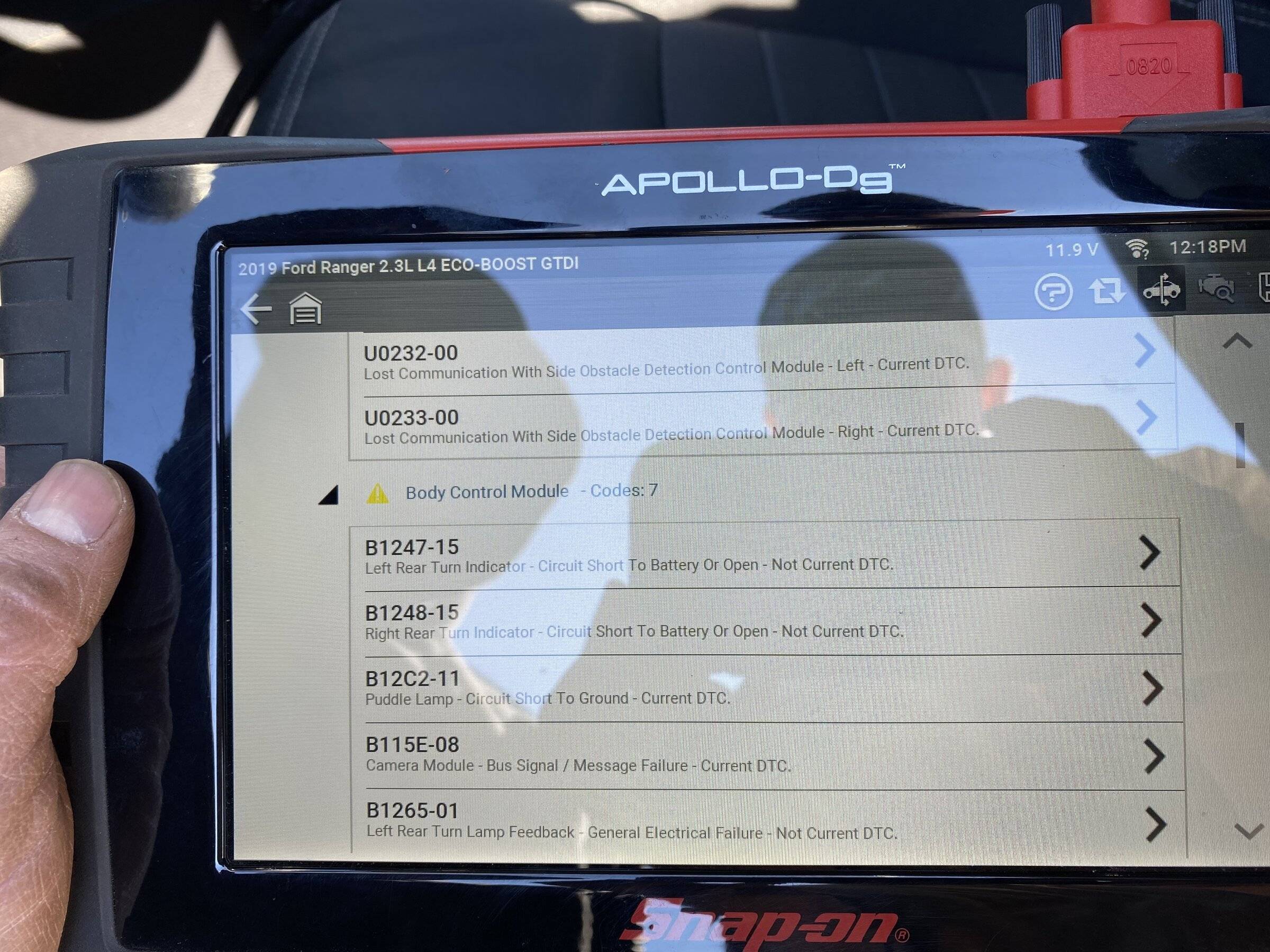

If I'm not mistaken most of those codes are BCM related besides the C### reverse signal (APIM) which gets its status from the BCM.
Are any of your accessories tied into the BCM?
My money would be you have a fried BCM with that many error codes.

Just looking at the errors you can trace everything related back to a BCM component. Only reason I mention BCM.
I can't see how you have overloaded the CANBUS. Folks on here have a lot more amp draw going on than you do, and CAN is just the communications method that all the controllers talk to each other. So saying a CAN overload sounds like a generic (was going to say "canned") response. So one of the modules is failing and with all the codes pointing to BCM components, I would say BCM.
It's possible everything started with the reverse camera, but would it affect the other circuits is the unknown.
It would be impossible to really tell since there is no known schematic for the BCM. But general parts of the BCM would be the MCU (microcontroller), Interface (CAN, LIN, etc), some sort of protection circuit for the power (battery), eFuses (FET's) for lighting and ancillary devices, load drivers (windows, locks, etc). With your errors the CAN is getting messages about mostly shorts to ground and all related to the rear of the vehicle. I would venture a guess that some hard component in the BCM has failed to have that many circuits failing.

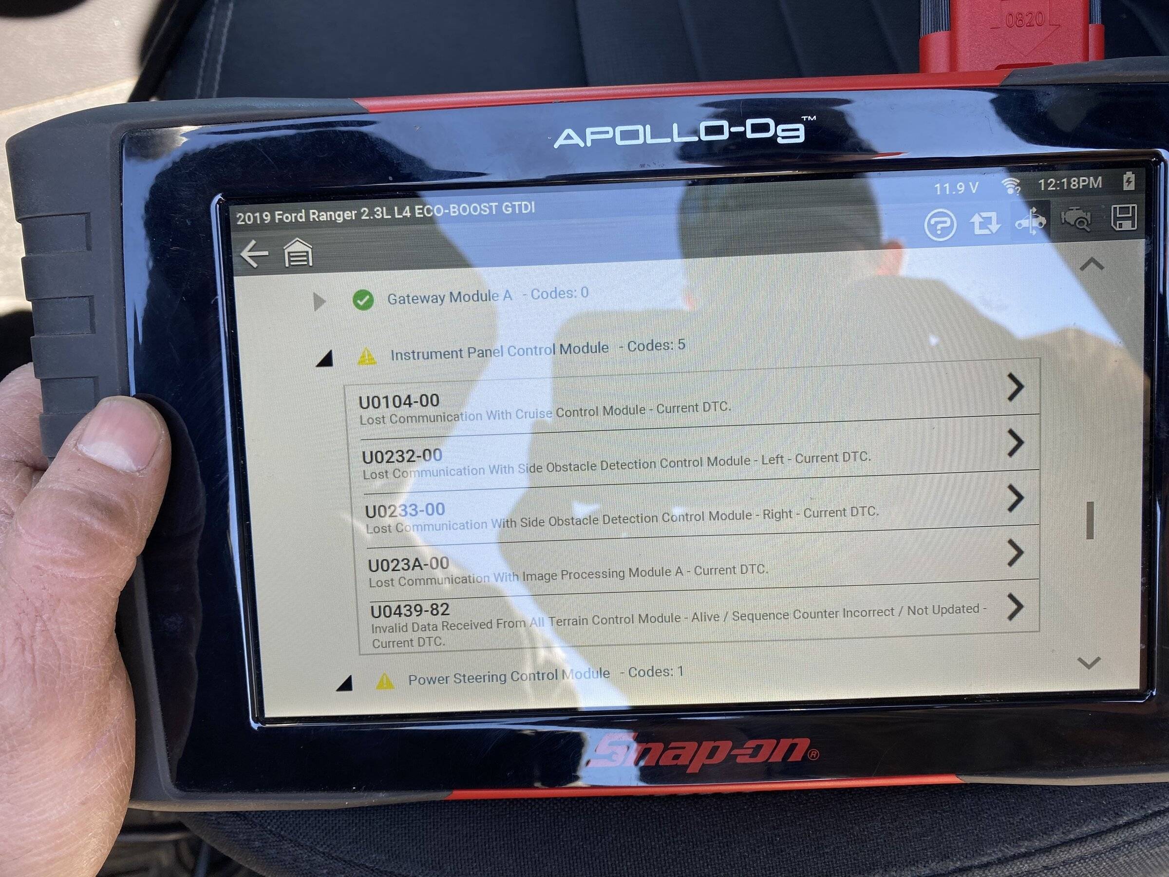

Get FORSCAN. Try to read data from every module. If you are getting errors from multiple modules you probably have a wiring problem. There are (iirc) 3 CAN buses on the truck. Hopefully the wiring problem is just on 1 bus. There is also a chance that a 12V wire shorted with a CAN wire and that would cause 12V to potentially damage modules that are only designed to handle low voltage CAN data. Again, that would only be likely if you had errors on 1 bus only. Very unlikely that you had a short on multiple buses. But if your are only seeing errors from one module then it's most likely just the one module that's bad.
Also, what did the dealer actually do to troubleshoot this? I can't imagine they don't have a diagnostic tool to do what I described above automatically. Either that or the technician doing the troubleshooting has no idea what he's doing. Data buses are easy. You either have good data or you don't.

What would be a way of going around to test if the BCM is the culprit in all this? The verbatim response that I got from the service manager, they wouldn’t even let me talk to the techs physically working on it, was that they “ couldn’t get any of the modules to wake up“. I don’t think they physically opened anything up yet and they are being incredibly vague when they are telling me what exactly all they have done. Truck has been in the shop for over 10 days now and they haven’t called me a single time other than me stopping in once. Getting a little frustrated that nothing is going to end up done to it
So the service Manager there hasn’t even let me talk to a tech yet, which was incredibly annoying. From what I gathered there is multiple modules that are not responding, and I don’t think they are able to read anything off of them. He described it as not being able to wake up the modules, so I’m not sure if they are just not sending any information, or if they’re totally off-line. I guess it’s always possible that some thing that was put on aftermarket electronically could have shorted something out, but all the wiring I do gets shoved in Lume everything is heat wrapped and protected. There is some wiring that the company who installed the flatbed did that was pretty sketchy, but I have since ripped all that out and replaced it. There is nothing that I have done that runs anywhere near the factory wiring harness except going in through a grommet in the firewall under the drivers side foot well. That is all been loomed and stuffed in corrugated plastic.
Oh man that is incredibly frustrating.
I would only be speculating as I've never seen a schematic of the modules and wiring on these trucks. My world in non automotive revolves around programming, mostly embedded systems, I do have a broad understanding of electronics, enough where I can hook up a o-scope and do diagnostics, re-solder components, etc. I tend to leave the hardware side to others.
But my understanding is that while the BCM has internal fuses (FETs) to monitor and control items like marker lighting, ambient lighting, doors, windows, (etc), it can also serve as a gateway for communications between other modules like the APIM, PCM/ECM, Trailer Brake, and on and on.
So if they can't talk with any of the modules then it sounds like the BCM has failed. Now that is clearly an assumption and there could be another hub/gateway that is the central communications point.
