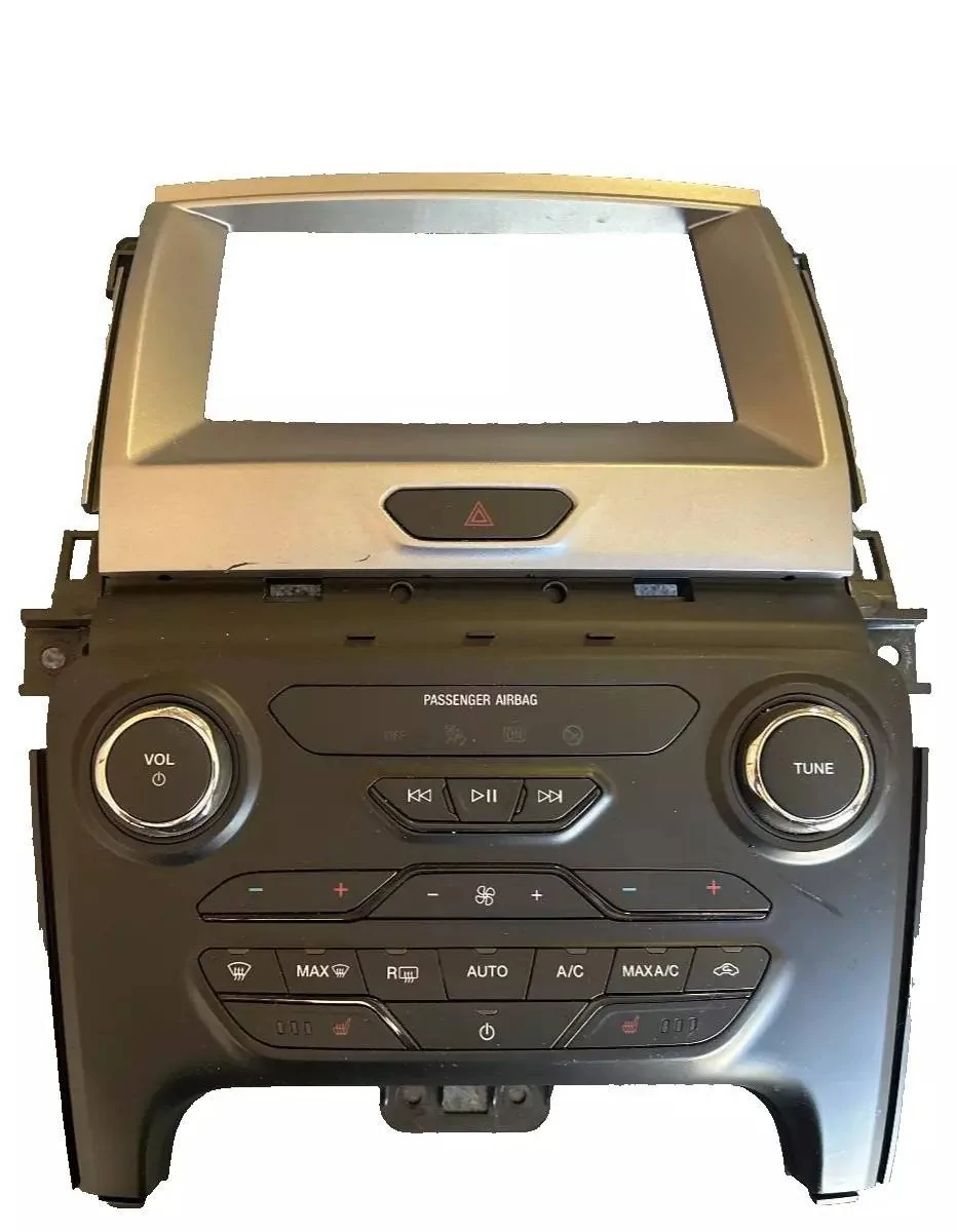

So I know I need forscan for this and I know that several companies offer these mods preprogrammed. But I can afford or justify 1500 dollar plus shipping and taxes for a infotainment screen. So I have found several car scrap yards that have my model of ranger and part them out and sell the parts. I just don't know what to ask for. Like I dont want to message them "I need the infortainment system" and then they only send me the screen and computer (idk if that's the right term for it but the brain behind the screen) and not include any of the cables and any mounting hardware / facia. So what exactly do I ask for to make sure im getting all I need. Specific names or part numbers would be greatly appreciated.

You need the screen and the apim module, and if the bezel is different you'll need that also. Those are the pieces I used when I did this to my mustang. You'll also need the VIN from the donor vehicle in order to update sync.

For the Ranger - In order to get the Bezel for the 8 In screen, its incorporated into the FCIM as a unit
The FCIM = The Switch Panel, main control for the (Climate) is the FCIM and the display screen is a repeater of the FCIM for touch screen control over the physical buttons.
As stated, any FCIM from a salvaged truck is going to have that VIN# programed to it.
The untested & unknown is - when this is plugged into the truck, it is definitely going to code for mismatch of (Vin#) data.
So - Will Forscan communicate to this module with a different VIN# so you can reprogram it to your actual VIN#.
As it takes - Ignition Switch Position - Run (ISP-R) data on the Can Bus to even get it to power up and it has to be powered to communicate to it.
For the vendors that sell these - they use a software program to (preload) the data to avoid the communication issue - There is a name for this (cloning) software, I just cannot think of it at the moment.
Is this going to be a true issue - IDK, but it may present a roadblock, one may try saving the As-Built data from the (Off) before pulling it out and hopefully when you install the new (salvage) FCIM it will overwrite it - but it may roadblock due to the VIN#.
This step is uncharted territory, and I do not know (100%) how the truck is going to react as I am only going by other members issues with this - after a collision repair.
Either the FCIM (Timing) failed, and it is dead, or a technician went to clear some locked in codes and he (reprogrammed) the FCIM back to the OE FCIM, now its locked and will not power up to even T-Shoot the issue.
So, from my office chair - I cannot pinpoint which of the (2) happened, I can say that this is most likely not a plug n play module - you will need to reprogram it somehow, how easy is that will depend on if the truck lets it power via Can Bus data. (Which is the Switch) to turn it on and off.
This is done by a series of (data messages in code)

If I just change out the stop portion of the bezel would my FCIM work with the new sync 3 APIM once it’s updated to my VIN , and does anyone know what wiring harness is needed to go from the 4” sync to the 8” sync 3 cause I’m seeing one style in videos and another when I do a search ?
