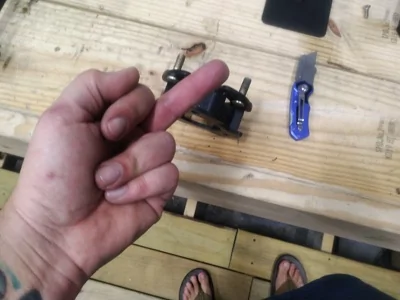

1.) I hope the dealer tech who installed the spacer struts on my truck chokes on a bag of dicks. He screwed up one of the pressed in studs on the passenger side so I was left with a nut that spun with the stud. To make matters worse, it was the rear most stud so accessing the head of the stud was not possible. After much cursing, some fire may or may not have been involved, and literally smashing the nut with a wrench I was slowly able to walk it off.

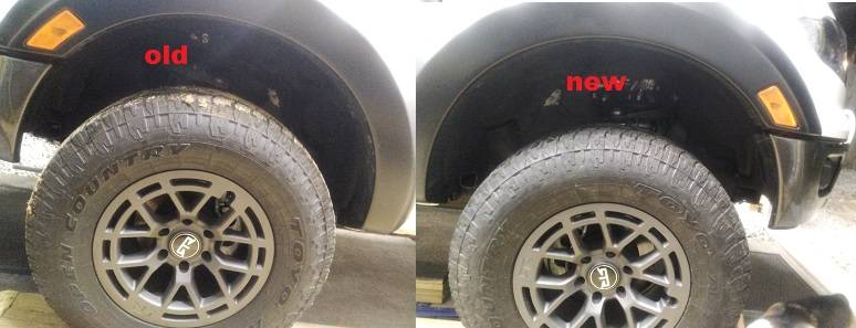

2.) Guilty until proven innocent; Another reason to keep assuming dealers will lie to until proven otherwise. Prior to purchasing my truck the dealer installed a 2.5" front level and 285 tires. Yea, well that was a lie, the strut spacers were 1.5" - go figure. I'm considering being a passive aggressive dick and mailing them the spacers back with a note about said tech's install ability as well as a simple book on how to read measurements. The good news is, my new Eibach setup put me from 7.5" between the wheel and fender all the way to right at 9".

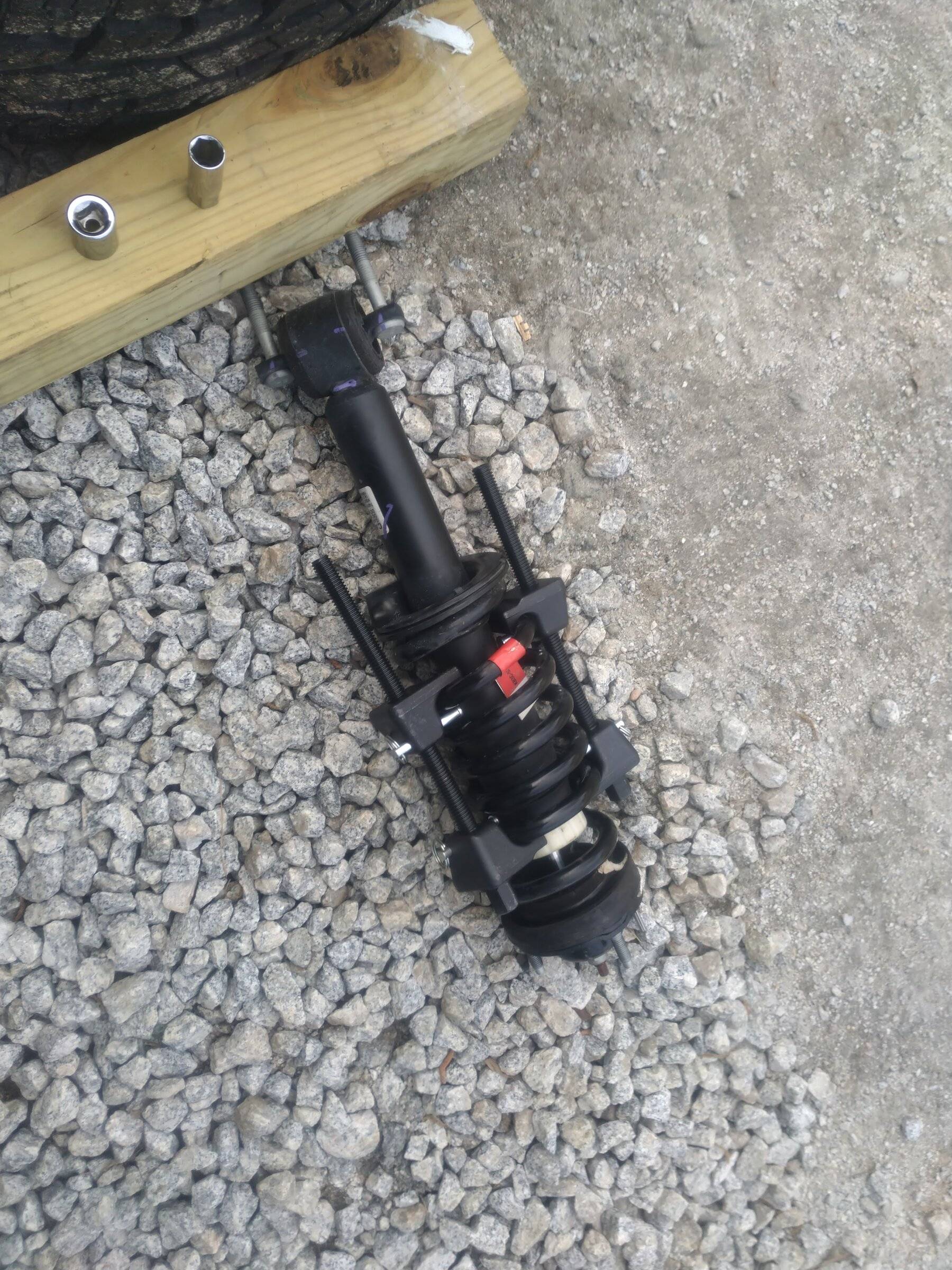

3.) I used the dreaded manual spring compressors. Well, that was about as anti-climatic as ever. At no point did I ever feel like they were going to fail, I guess horror stories get passed around because bubba did the same thing with a pair of leather belts. I dunno.
