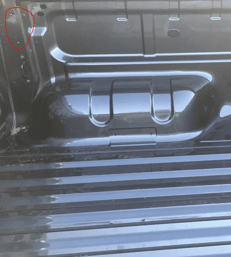

Anyone know offhand if these bolt holes are made for the standard tie down hooks or something else? They appear a bit more spaced out to me.

I dont know exactly what they are for but im sure Ford has a purpose for them. As for the tie downs most trucks have 4 from the factory and you can add 2 for the center. That is what I do know.

Got some tie downs this week. Holes are about 3.75 on tie downs. Those rear mounts are 4" spaced. The tie downs won't work without modifying the holes. Ended up putting on a D-Ring tie down on the top one.

Do you remember the thread pitch

Believe the bolts are all M8x25mm, pitch 1.25.
