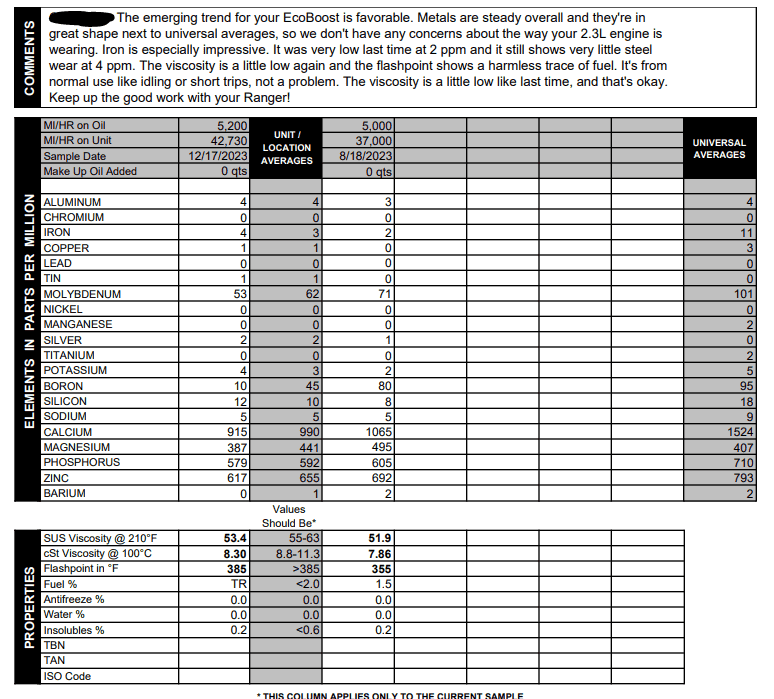

Just got another analysis back. Pennzoil Platinum, Wix filter. Trace amounts of fuel, I assume less than last time? Not really clear.
I am a TINY bit concerned about the silver, tin and copper in my oil? Even though very small amounts and near average, aren't those bearing materials?
