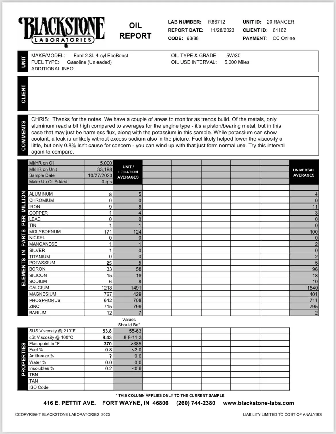

First oil change since ownership. Assuming they used Motorcraft 5w30 since it was dealer changed - but, who knows?
I stuck with that oil for this change because I have a few pre-paid changes rolling over from our 2016 Transit. I noticed in the report that they also put in BG MOA additive and 44k in the fuel tank…I didn’t ask for that. But, I guess we’ll see what it does on the next analysis.
I plan to switching to Motul after the pre-paid runs out.
