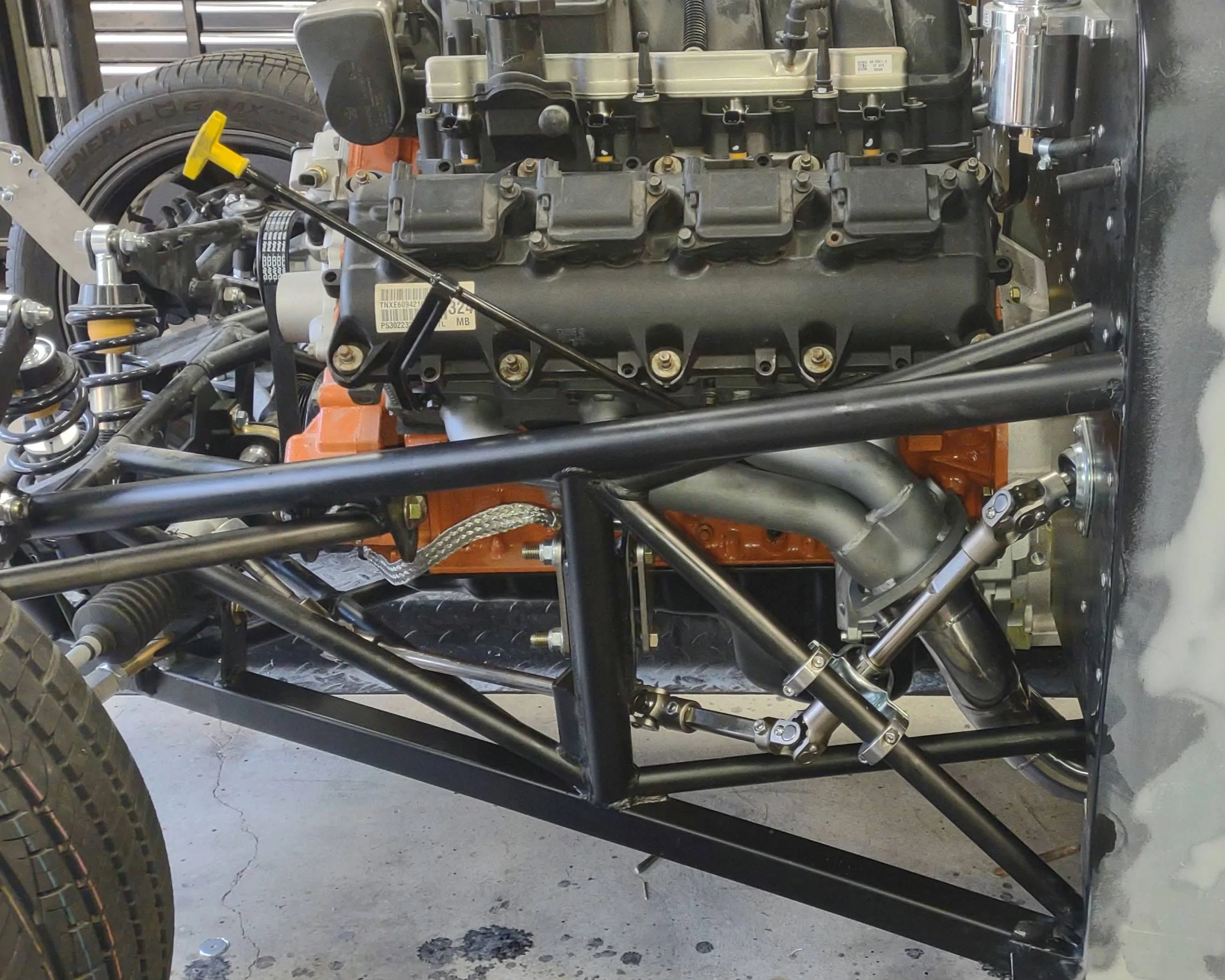

Interesting you mention u-joints being out of phase. I am building a Factory Five Racing 33 Speedstar kit. There are 5 u-joints in the steering from the end of the steering column to the input to the steering rack. Folks that have older kits all the joints are in phase and they report slight binding every revolution of the wheel. My kit came with a twisted double D shaft that goes between the second and third joints and puts those two joints out of phase. My steering is silky smooth from lock to lock.
I asked FFR why they made the change when the steering u-joint manufacturer was so adamant about them all being in phase. They simple said it works better with one pair being out of phase.
