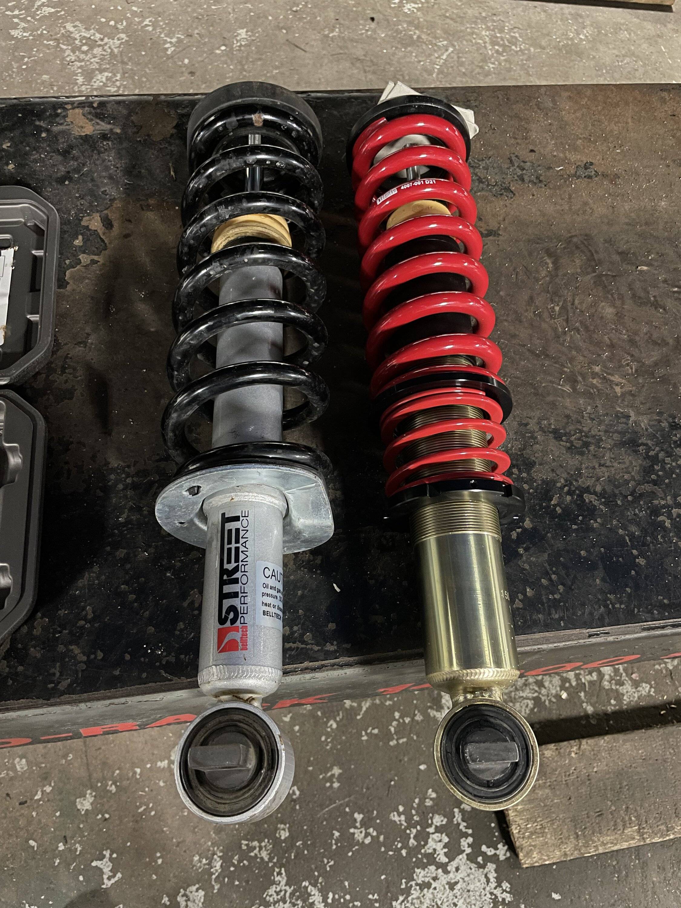

Thank you! I have the red and gold ones from Belltech but they just make them too long. I’m either making a custom upper mount for more travel or I’ll make brackets and run Vikings or Ridetech ones.
I have the same issue with the front Belltech coilovers. I would like to replace mine with adjustable units. So far I have not found any that fit. Any suggestions about parts would be appreciated.

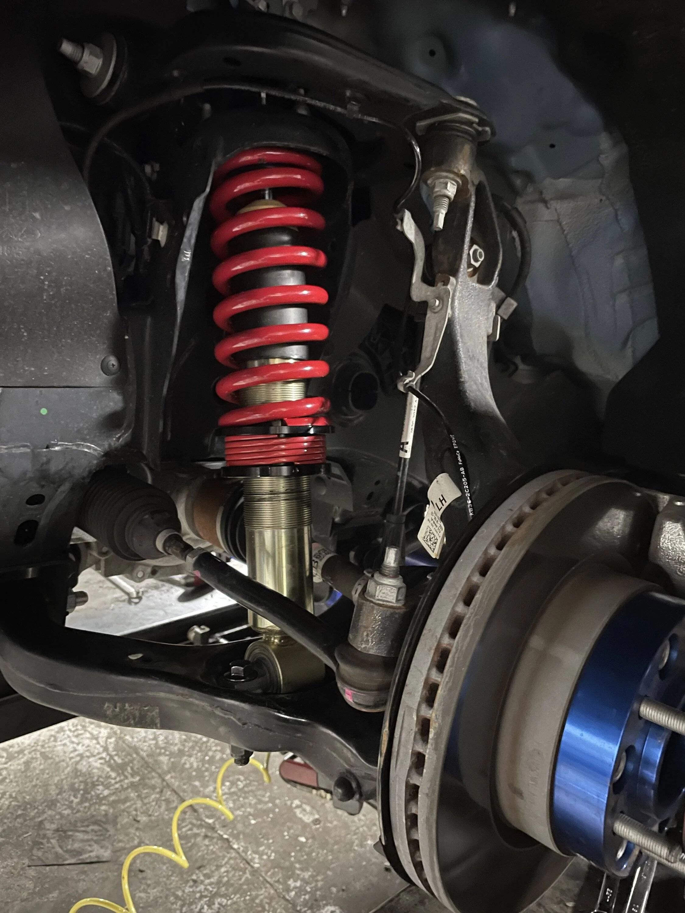

I’ll be making a kit eventually but in the meantime, Freak ride has a kit that works well. It has adjustable Vikings.
