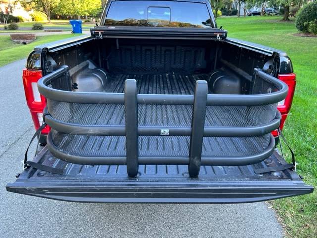

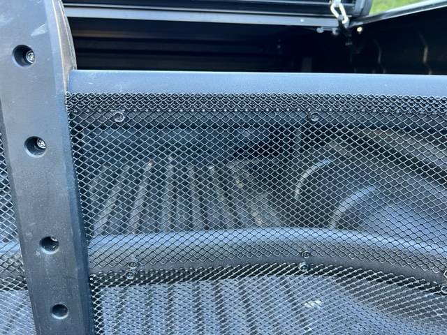

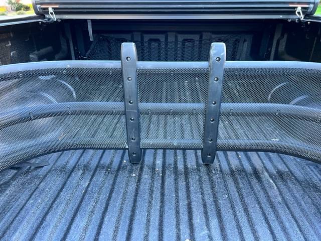

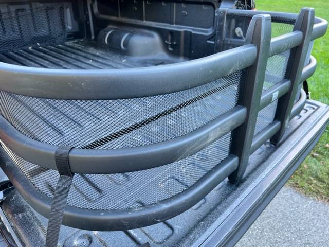

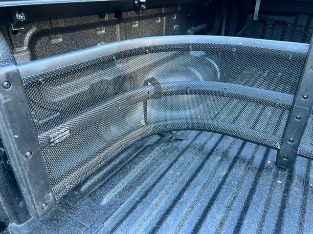

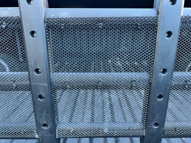

I've got the AMP Research bed extender, also, and like it a lot for the same reasons as GregP; does a good job of extending the bed when needed, and keeps the groceries and tools from sliding around when you don't need the full bed capacity. I added some black wire mesh to help it contain things. See attached pics. Like the look of it, too.
The mesh is actually Spectra armour gutter guard (black mesh style) which turns out to be the right width, and I then cut to length and secured to the extender with #10-3/4 self tapping screws (spray painted the heads black first to make them blend in).
