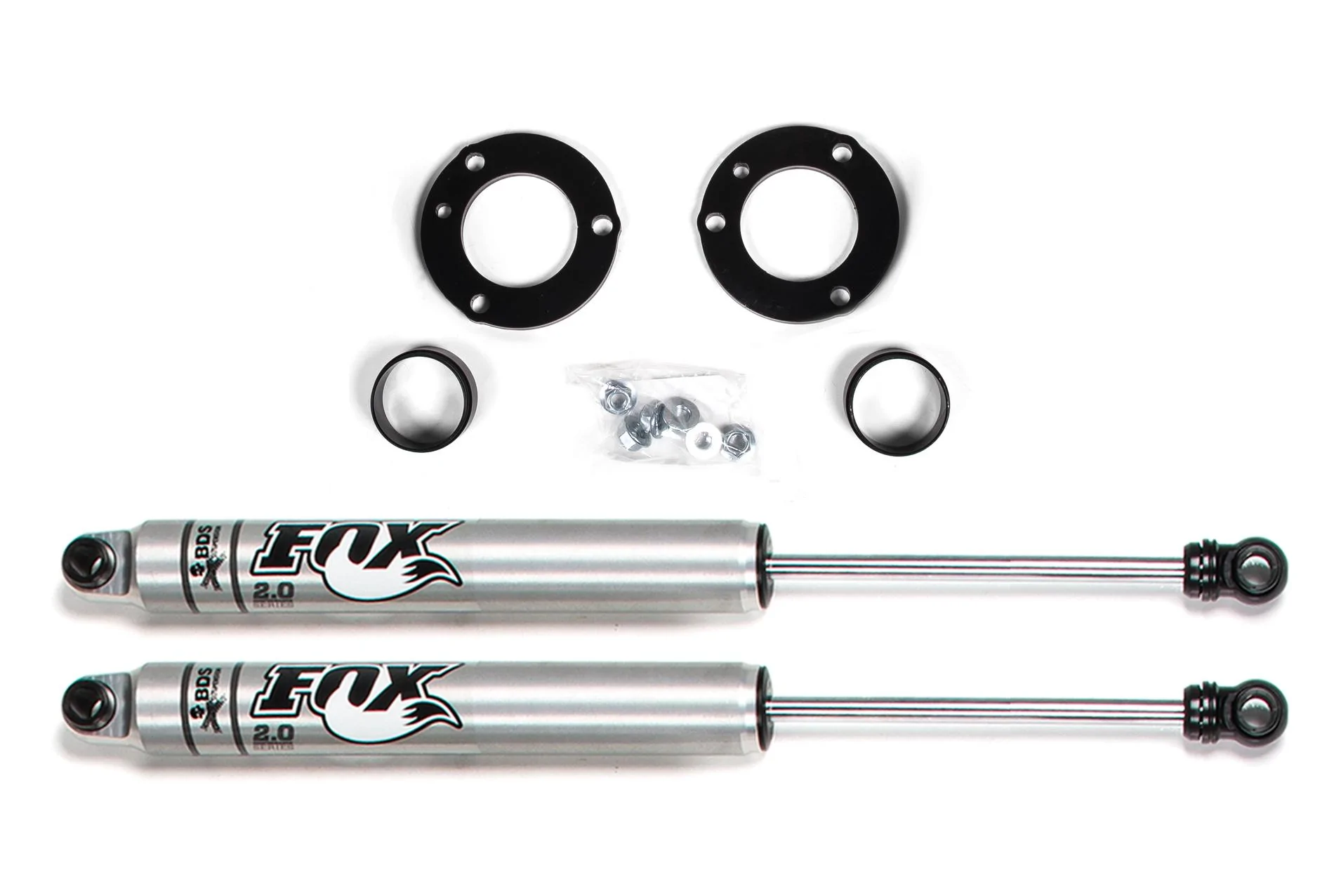

The video describes the 2" leveling kit spacers (about $158, including rear shocks), but also points out advantages of the OPTIONAL upper control arms (another $736). http://bds-suspension.com/product?ma=3&mo=25&ty=1&yr=2019
If I intend to use my Ranger as a daily driver, with little-to-no off-roading, do I need to upgrade the UCAs?

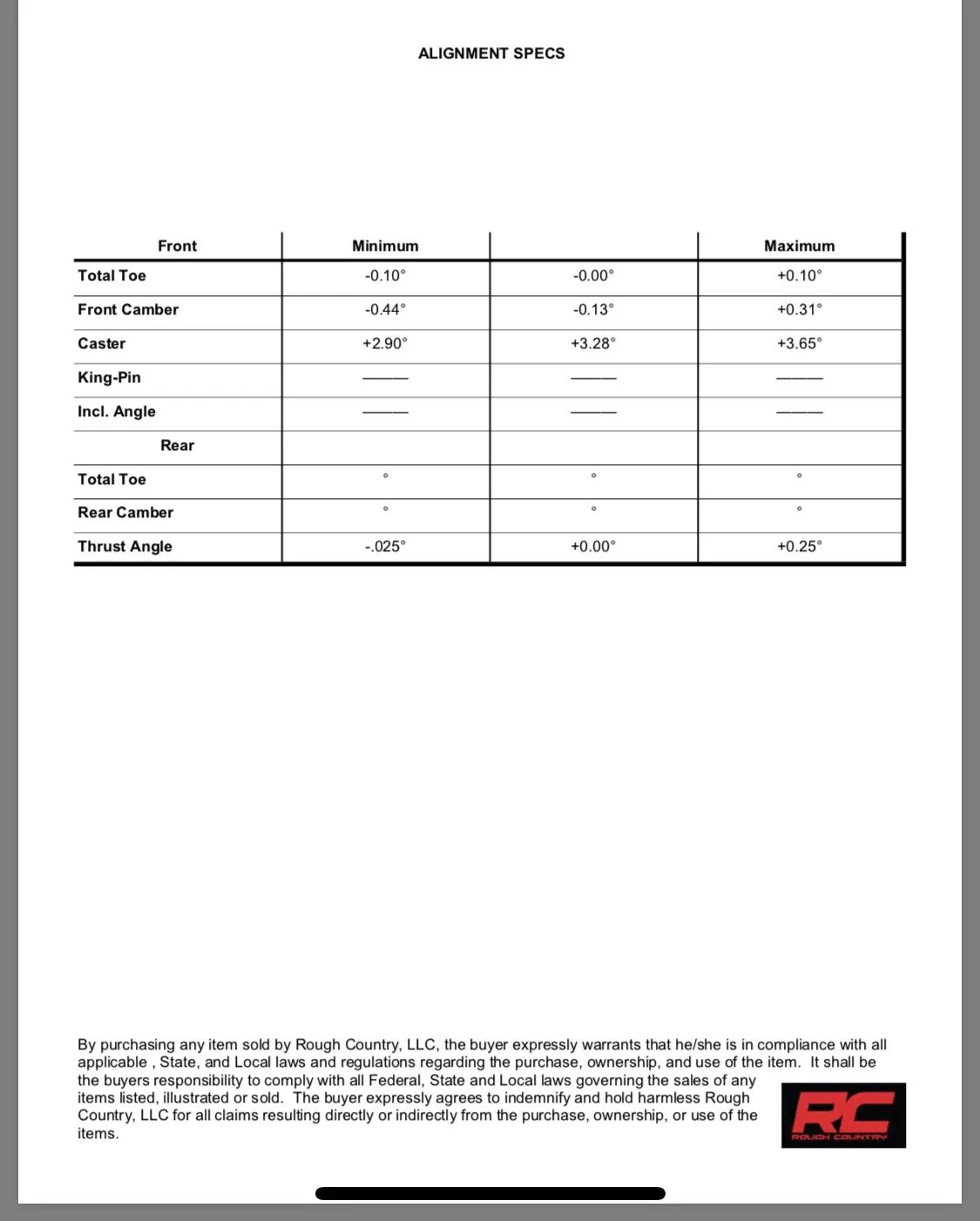

Did bds provide specs for alignment? I know rough country did and I took my truck to a mavis and he followed as close as he could to the specs I’ll have to get a photo of my actual alignment it’s in the truck
I expected as much, but have gotten nothing. They did not include any specs with the kit, and the tech guys had no specs to pass on to me either.

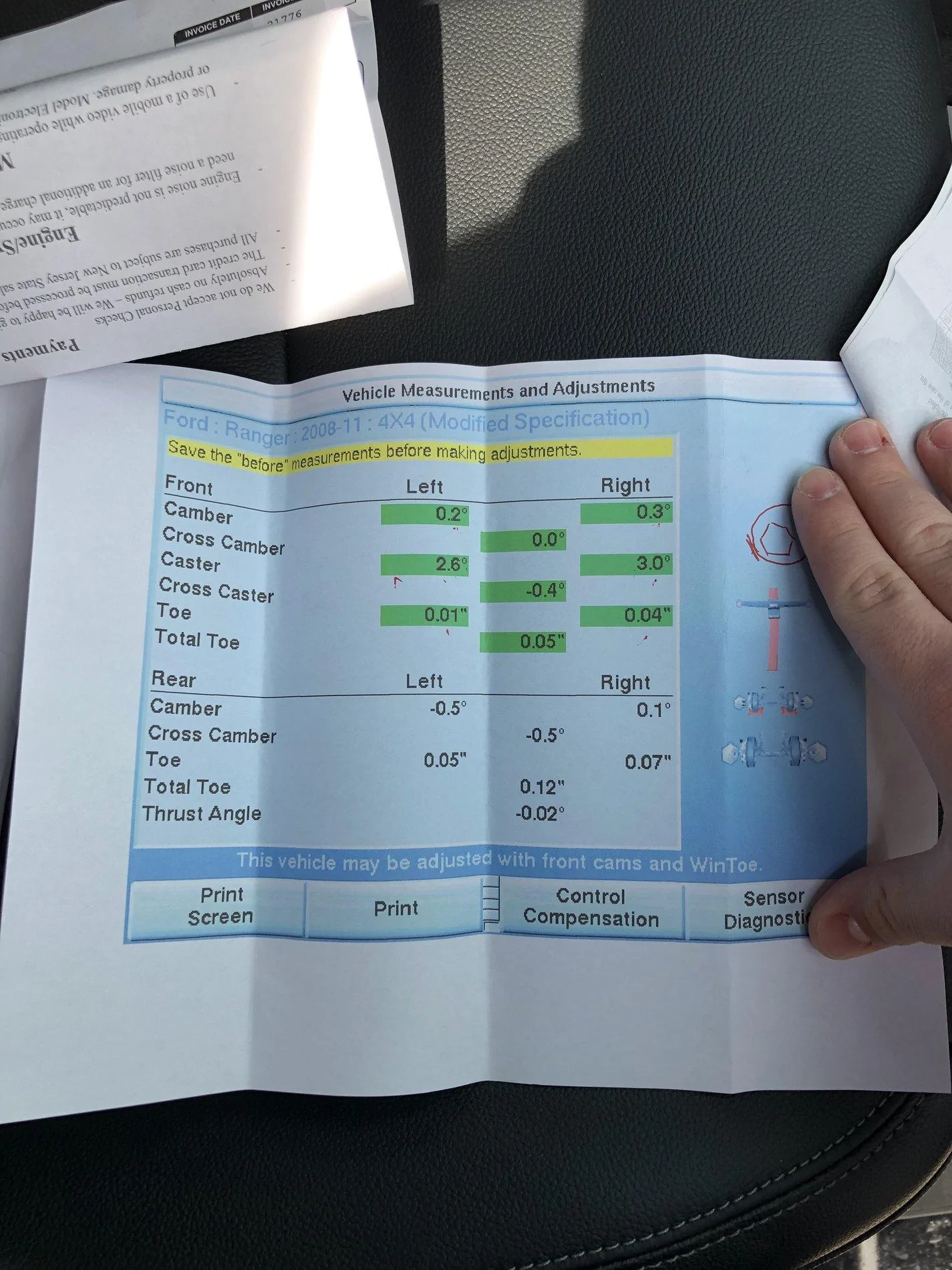

Here are the rough country specs and what I got from mavis
