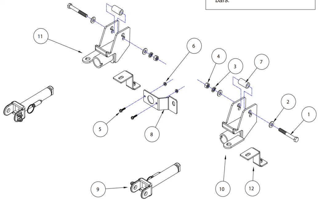

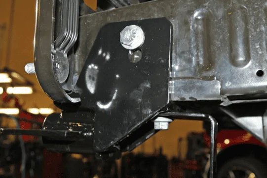

In order to mount a Base Plate for Flat towing my Ranger I had to remove the tow hooks.
Is it OK to use the Base Plate connections as a recovery point for the time I get stuck and need a pull?
Pictures show how the Base Plate is connected and it seems to me that it is attached as well as the original tow hooks but if you have an opinion I'd like to hear it.
If it doesn't appear that it would work does anyone know if after market recovery points such as ARB makes would work in this situation?
How the base plate is attached. The bolt through the side has a tube spacer (#7 above) to reinforce the frame.
The arms (#9 from above) are locked into the base plate.

If it's good enough to tow your vehicle with...... it should be good enough to use as a recovery point. In both cases they are pulling the weight of the vehicle.
I'd suggest you address the question to the folks that make the towing components you are using.

The only concern I can think of is in recovery procedures you may be putting more load on the brackets than when towing. From the drawing you submitted it appears that you are using a Roadmaster QD bracket. Those are what I have on my Ranger. From what I've seen I believe the mounting of the bracket to the frame is stronger than the way the tow hooks were mounted. I don't have any idea about the strength of the connections of the brackets but the same brackets are used on heavier vehicles than the Ranger.
So in short, I would use the brackets if needed for recovery.

I think towing the vehicle and pulling it out of mud are different animals. I was taught in the Army that a tank stuck in mud to the top of the tracks would double the weight of the tank so maybe pulling a truck from mud would put more strain on the tow points than just pulling it down the road.
I'm not sure that the company that makes this in order to tow a car behind an RV would go out on a limb and say it could be used to recover the truck since they haven't tested it as such.
