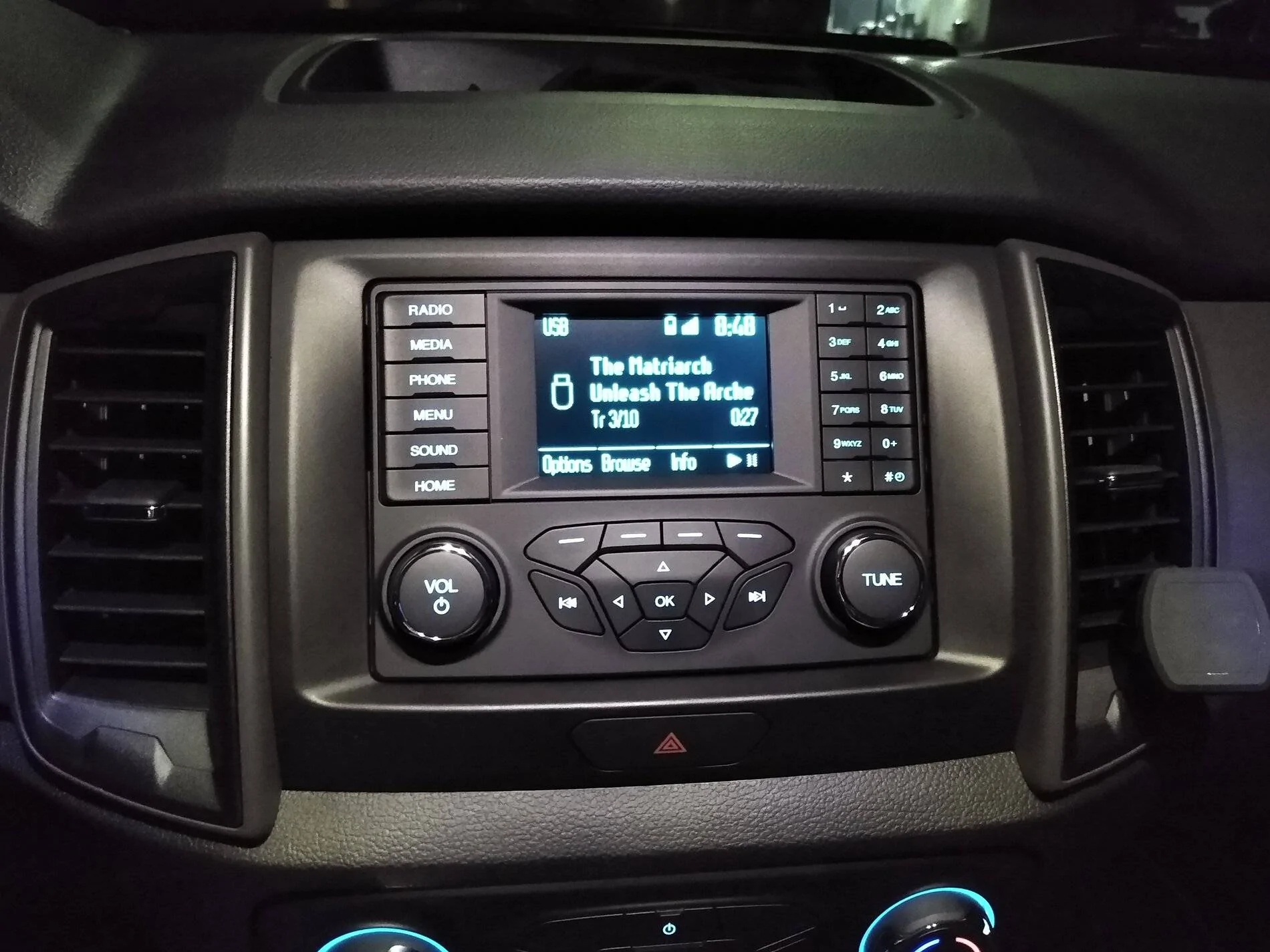

Has anyone replaced the blue screen radio on the base model Ranger? According to Crutchfield it can't be done. The mounting kit for the 4" sync will fit but there aren't any wiring adaptors available for the blue screen model.

You can replace it with the SYNC 3 8" screen, but those run around $2K

I swapped mine out but it's kind of a pain in the ass. I used the install kit for the smaller sync radio. The wiring kit worked fine. The 2 bottom screws have nowhere to thread into so I ran zip ties through the holes which ended up working really well. The trim hides it anyway. The hazard button for the blue screen radio is bigger and won't fit the kit at all. The sync version is soldered on with no connector. I layed fiberglass over the hazard button hole, repainted it and drilled a round hole for an aftermarket illuminated button. If you were really good with a dremel the factory button could be reused. But I didn't think I could make it look right.

Thanks machinist85. Good to know that wiring kit works. I'll see what I can figure out with the trim. I'm good at destroying things with a dremel. Nothing is ever easy any more.
