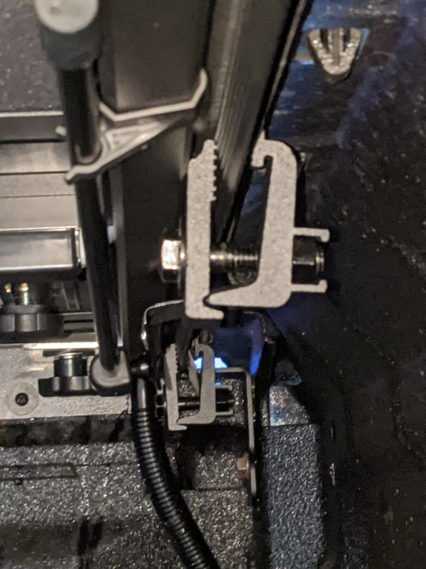

I am trying to install the rails and the back clamp won’t meet the metal of the bed.
I’ve included a pic to show where it lands once tightened.
Did I get the wrong brackets?
I did have a whim between the plastic cap and metal of the bed and it did the same thing.(This was an easier spot for the picture)

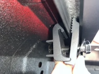

Here is a pic of my MX4 rail clamp, took a quick pic of rear clamp on the passenger side. You need a third hand to push up on the clamp as you begin to tighten the clamp and I used one or two pieces of the spacer material between the two pieces of metal.

Awesome thank you :)
I’m gonna try again

Comparing your clamp to mine. Your back one(that holds the nut) seems to be taller. And the base part longer. ??
Did I get the wrong clamps

Give Backflip customer service a call tomorrow to confirm, are all of the clamps you have the same?

I had to grind off about 1/16” of the clamps to make it work. Then it was perfect.

What did you grind off?
mine seem to be to short?

The top of the inside of the clamp.
