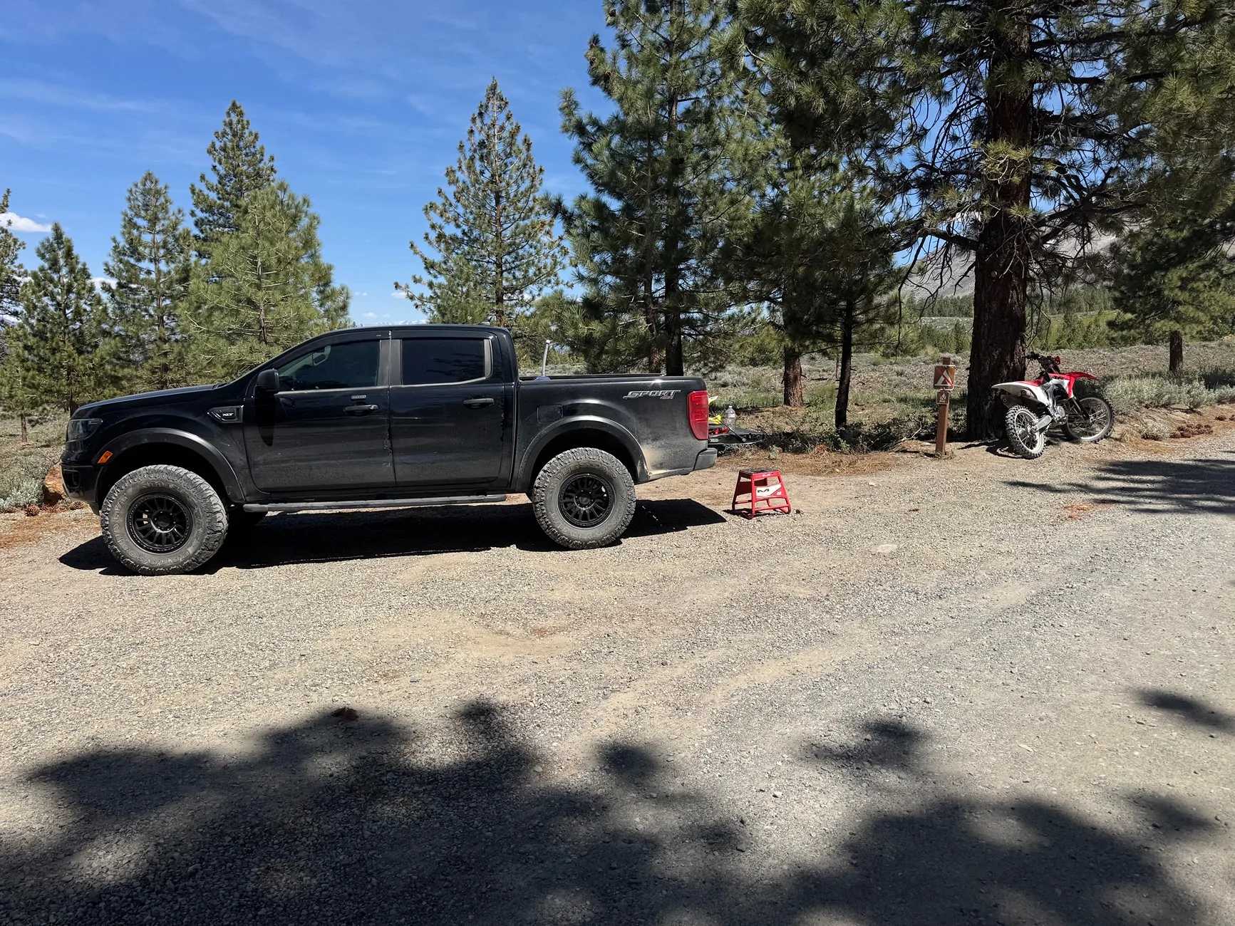

Hi tonight, I was driving to Grove grab food in my 2020 Ranger XLT as I was leaving the restaurant from the drive-through notification popped up on the cluster saying check 4 x 4 has anyone else had this problem thank you in advance pick is of ranger
