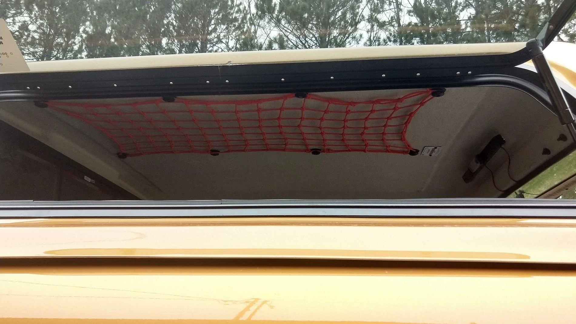

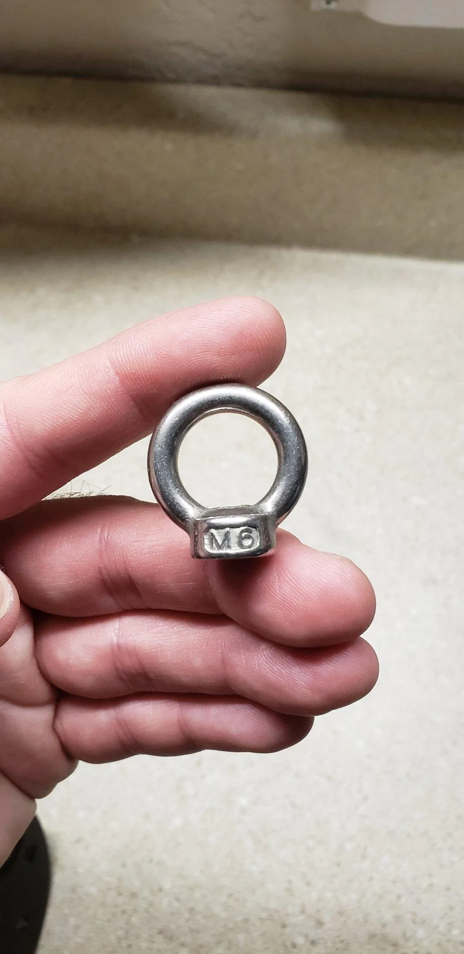

Just wanted to share this quick mod... cargo net, M6 eyelet rings and caribeaners from Amazon.

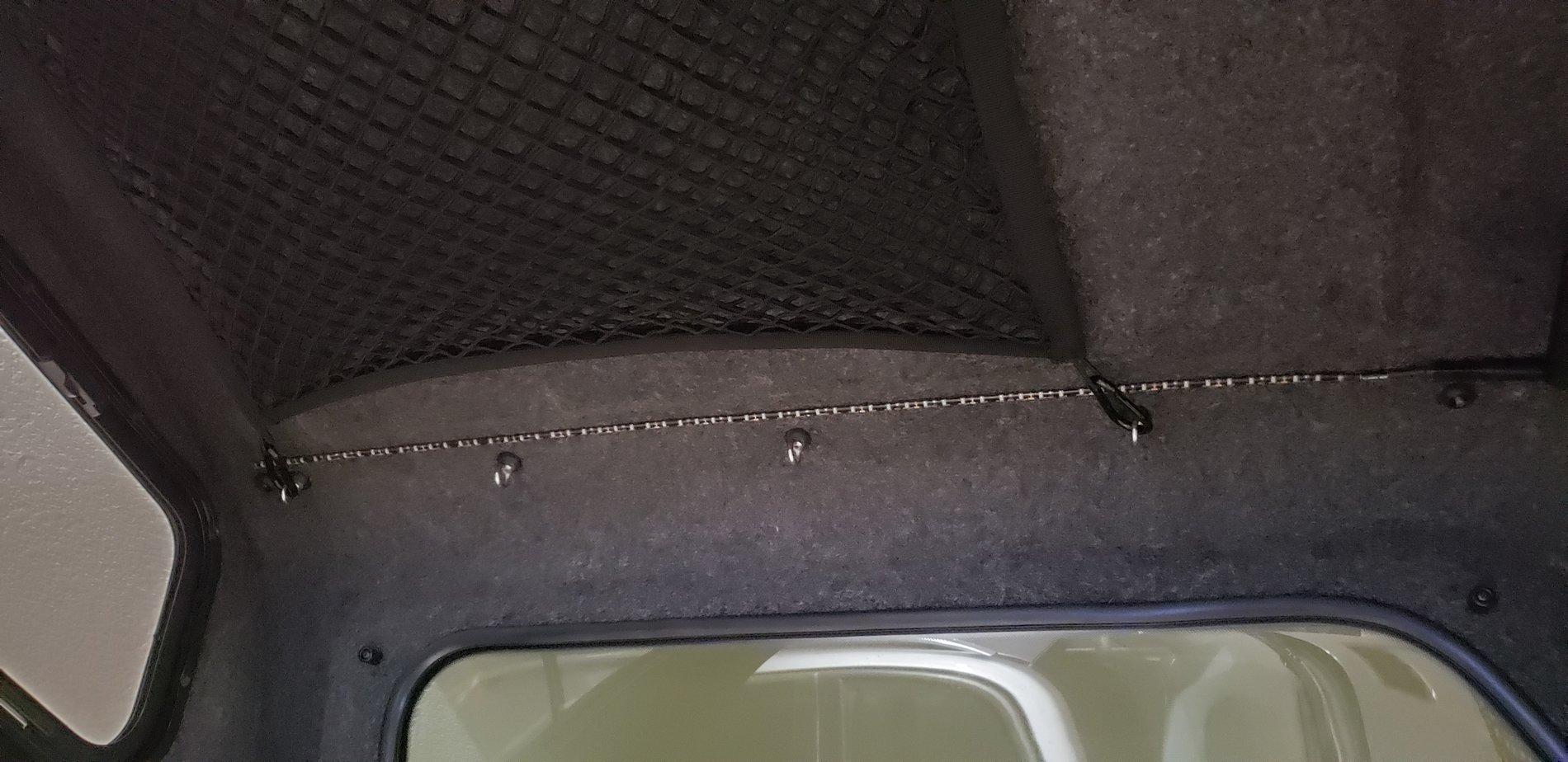

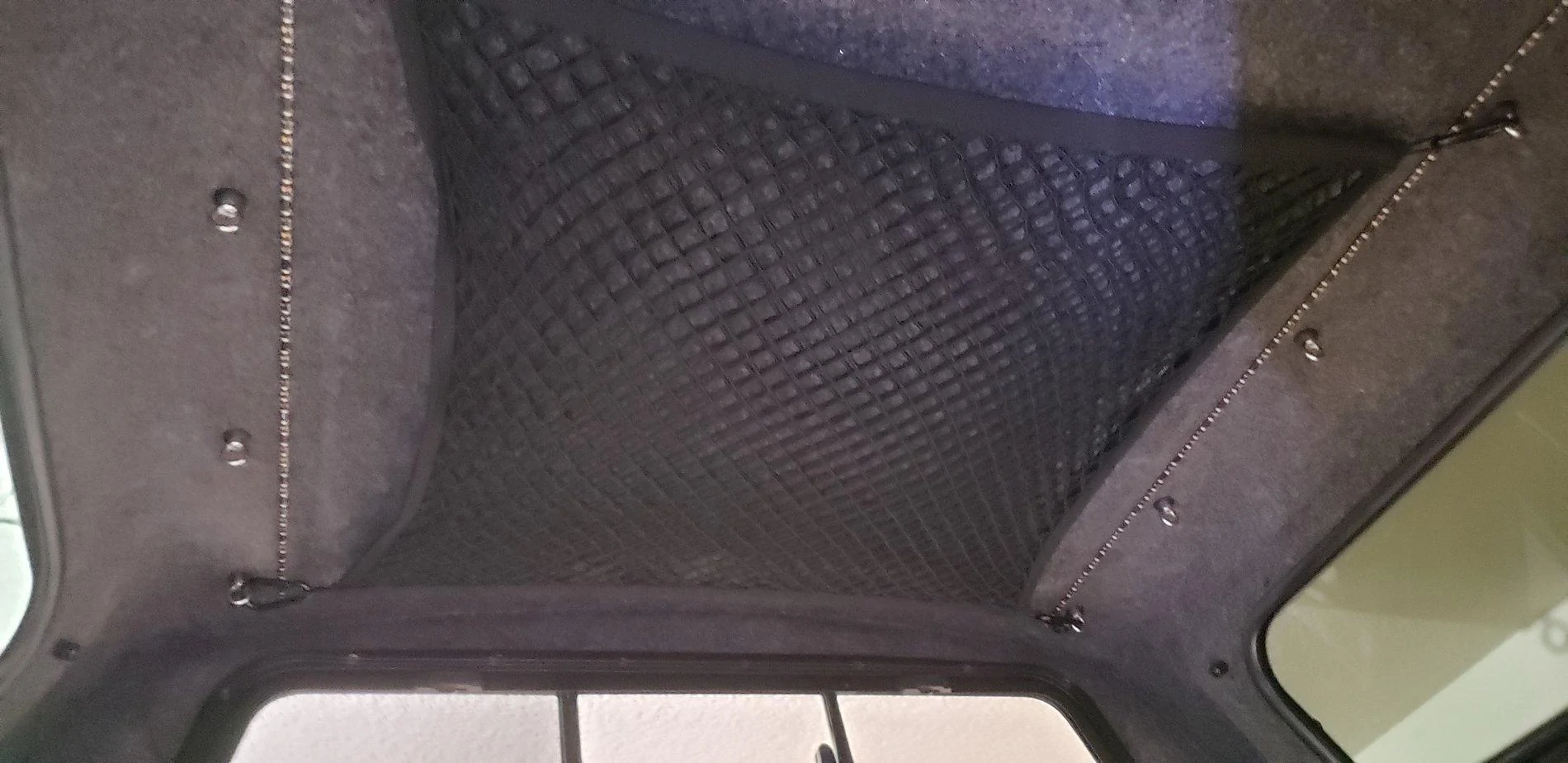

You did it yourself? I know that Leer offers a ceiling cargo net option from factory which uses the butt ends of the roof track bolts. I had considered getting that when I ordered my topper, but once I realized it wouldn't be that hard to add myself and that I could get a set of tracks, towers, and bars for cheaper than Leer was charging, I abandoned that option. I have plans to do a similar setup once all my mounting hardware shows up.

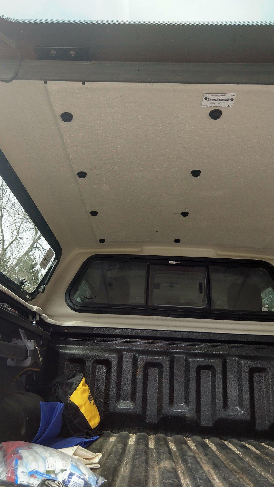

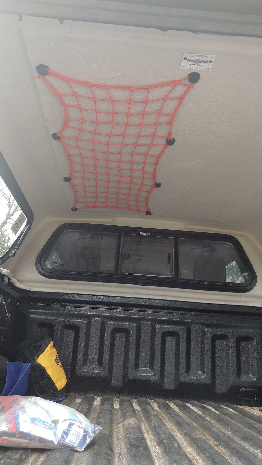

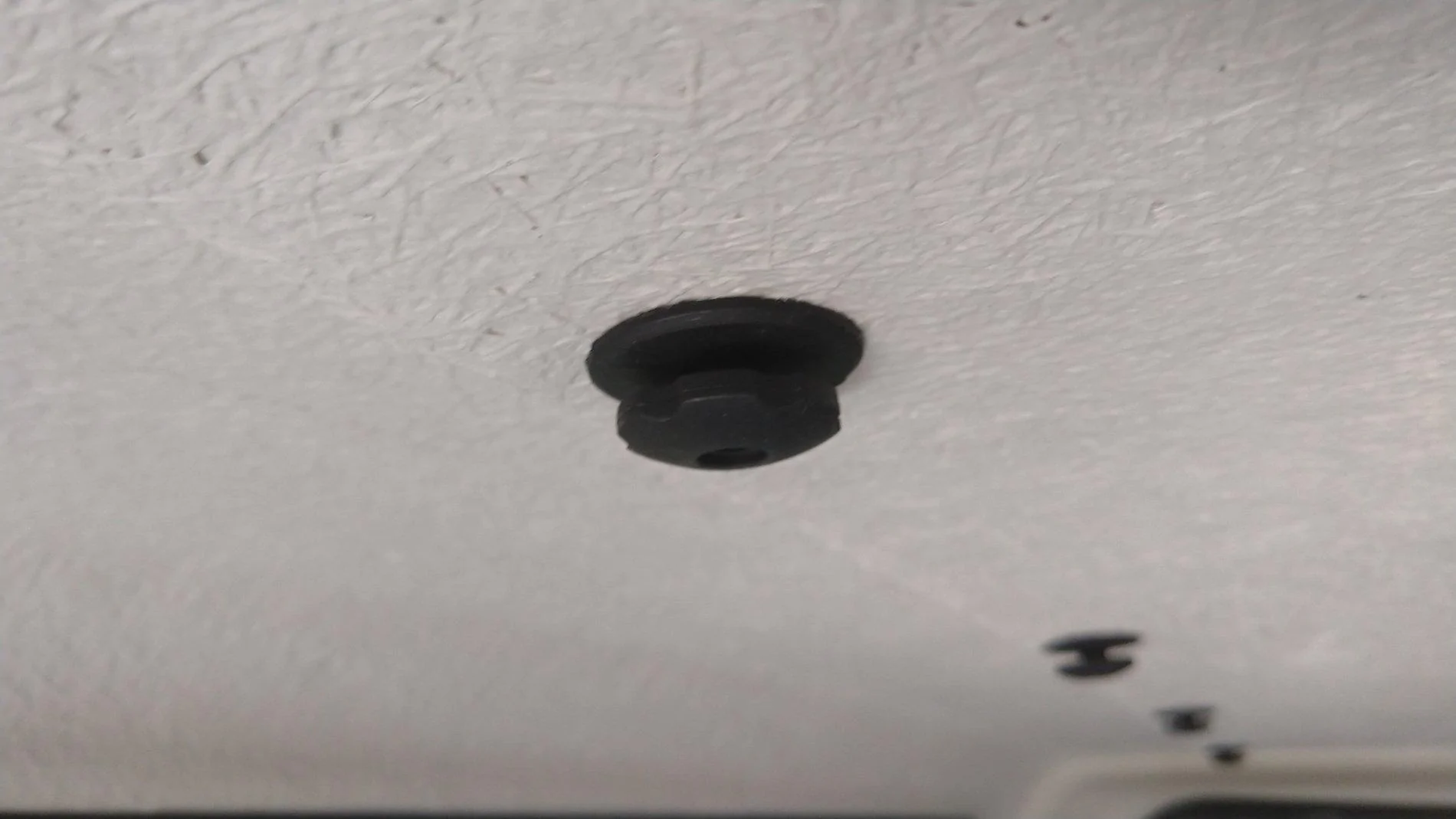

All my parts finally arrived and I was able to find time to get it done. I bonded 8 anchors onto the ceiling of my topper using JB Weld plastic bonder.
Let it sit for a few hours since it was relatively chilly out (~45deg). Then attached an elastic cargo net I'd been using other places and fit perfectly for my idea here.
I'll wait until tomorrow to put things up there, let it cure for a bit longer just in case. Beauty of it is it can be accessed from the back or from the driver's side windoor.
