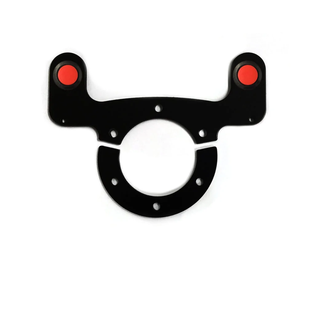

i like the idea and when you get it all squared away i wanna see. but, could moving the switches some place easier to reach be a fix?
