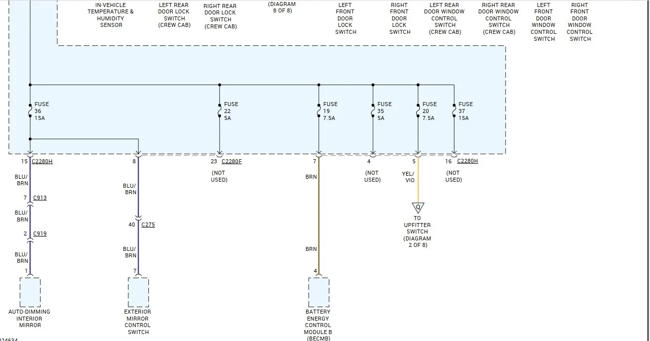

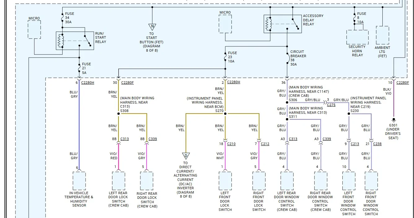

Note: This is (Internal BCM) switched power feeds and fuse 35 comes from the (Micro Control) BCM (Ignition - ISP-R) signal - basically it should drop power with key off
I want to also note that Fuse 36 - if you are tapped at the mirror for the dash cam - this is the fuse it is using.
In order to get a clear pic, I had to split the diagram in half

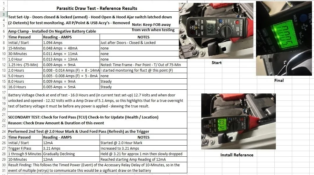

This is a normal draw - example - taken at the battery

For a true parasitic draw test, you need a good (Low Amp) Probe that can read low current.
This is what I have and used in my testing
It will read as low as 1 mA - expensive but works great
Ref my chart above for expected (normal) readings - far less than the Klein will show for any true diagnostics
The Klein CL390 will not read any lower than 300mA accurately and will display (0) for anything lower than 200mA
