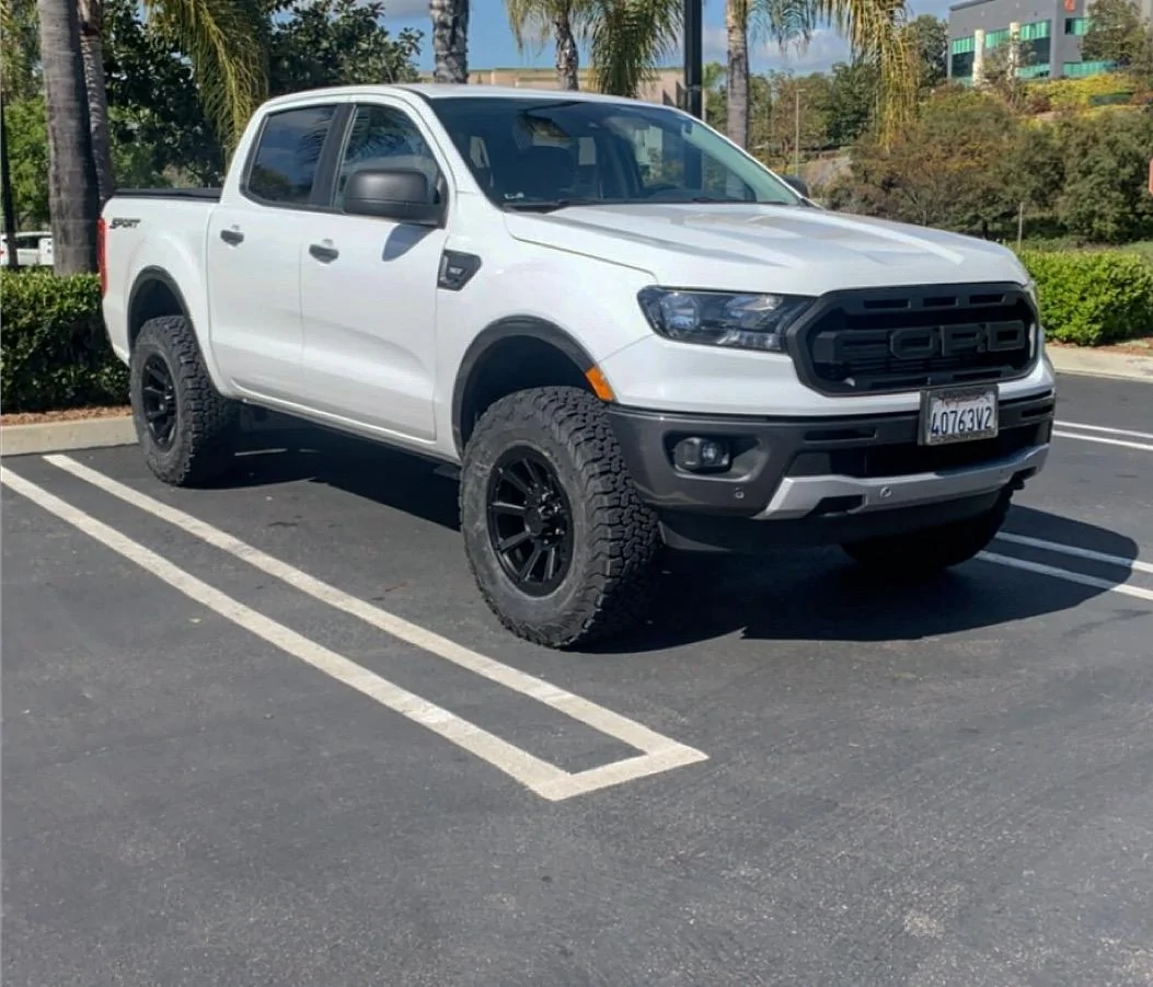

I put 285/70R17 KO2’s on mine and it not only looks incredibly aggressive but it also handles great off road in my 4x2!

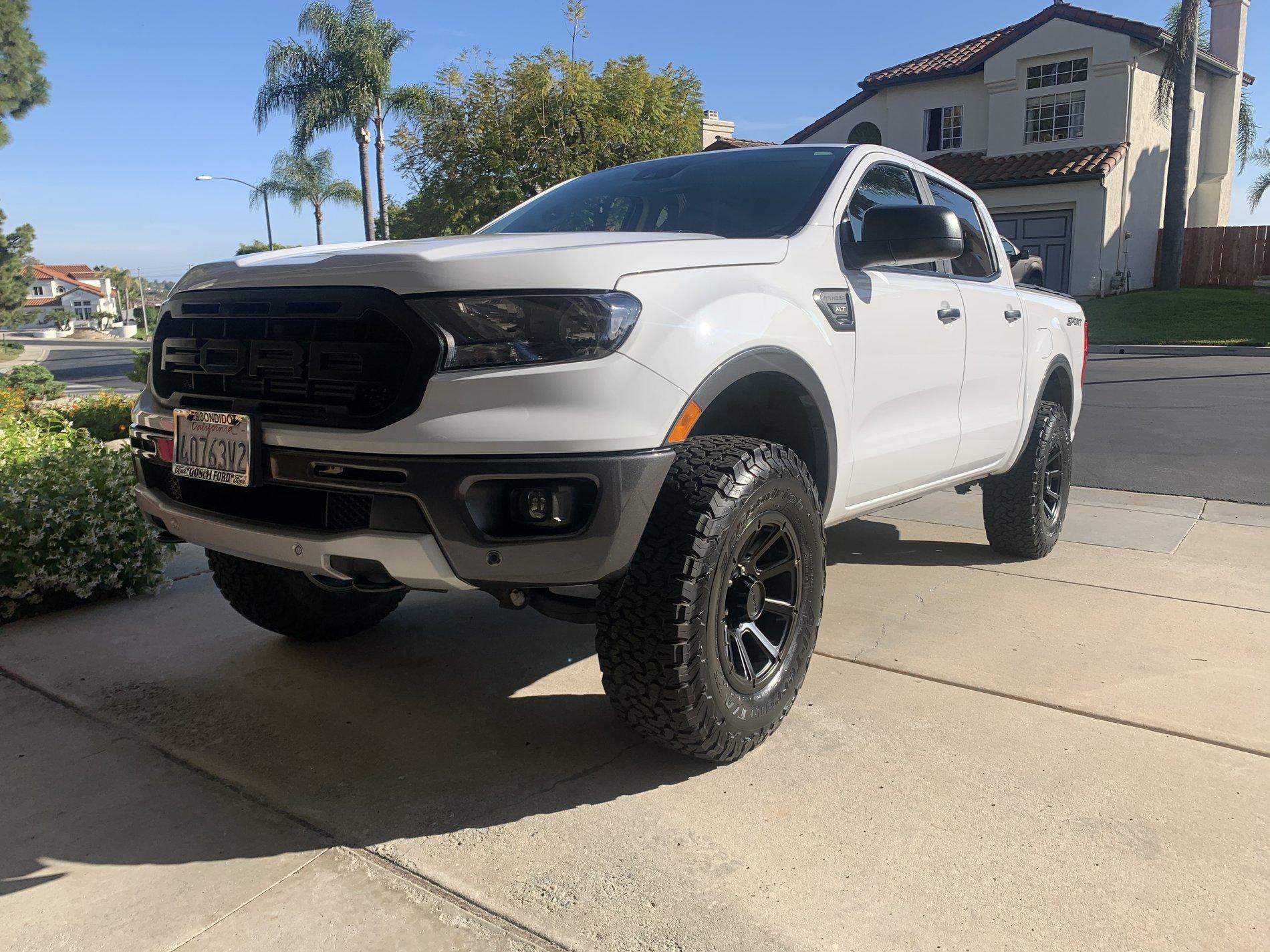

All I can say is do your tire research.
For me, I went with the newer Toyo Open Country AT/III that came out last June. If you are familiar with the Open Country AT/II's, you need to compare them with the AT/III's as they are a very different animal.
Here are mine:
https://www.ranger5g.com/forum/showcase/texas-ranger.279/#lg=1&slide=32
I figured I would hear more road noise with this tire and I was prepared for that, but what I was not prepared for was how quiet these actually are ...not much more noise at all, if any, in comparison to the stock duelers.
Ride feels like I am more connected to the road and handling is better, probably due to the wider stance. The stock duelers weighed in at 38lbs and these weigh 43 lbs, and I have not seen any difference in fuel economy ...still average 22.6mpg and I am loving the ride quality!
I know y'all will ask, so here you go:
~ Toyo Open Country A/T III, 285/60R18, 120S XL
https://www.toyotires.com/product/open-country-at3
~ KMC KM535 GRENADE OR Matte Bronze Wheels, 18x8.5, 35mm offset, 4.75 backspace
I didn't want to do this, but yeah I did have to modify the front intrusion bars. All I did was loosen and remove the outer-most bolt, pushed the bars in as far as possible, and then retightened the inner bolt. I may get the ReadyLIFT bars later https://www.readylift.com/high-clearance-anti-intrusion-beams-ford-ranger-2wd-4wd-2019-2021.html

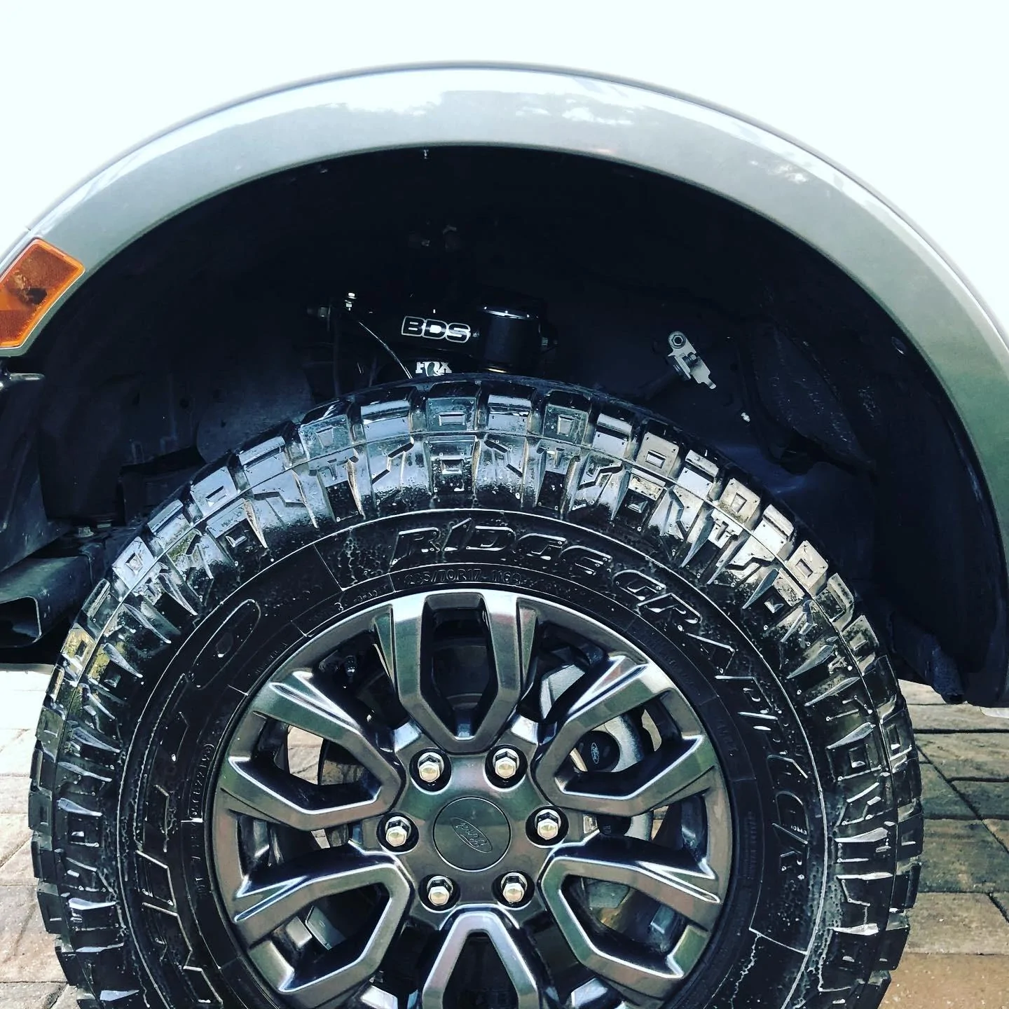

I wish I could say I have enjoyed my ridge grapplers, but the vibrations I get on the highway make it embarrassing to have people in my truck. They have been traditionally and road force balanced many times at many different shops, I have tried all ranges of tire pressure and the ride is just terrible. Many people seem to love them, so I may have just gotten a junk pair, but I am looking to switch in the near future as well.
