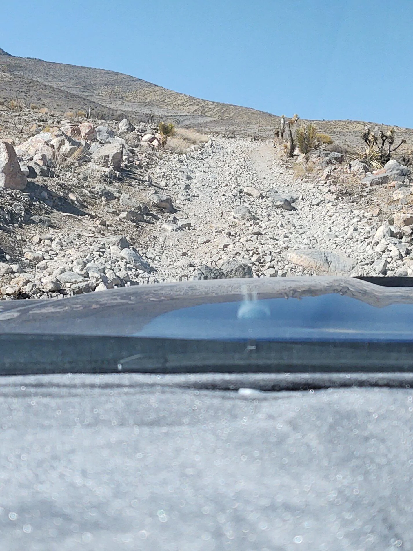

But I definitely tore them up on the trails this weekend. Lots of sharp rocks. But, didn't go all the way through so I was fine.

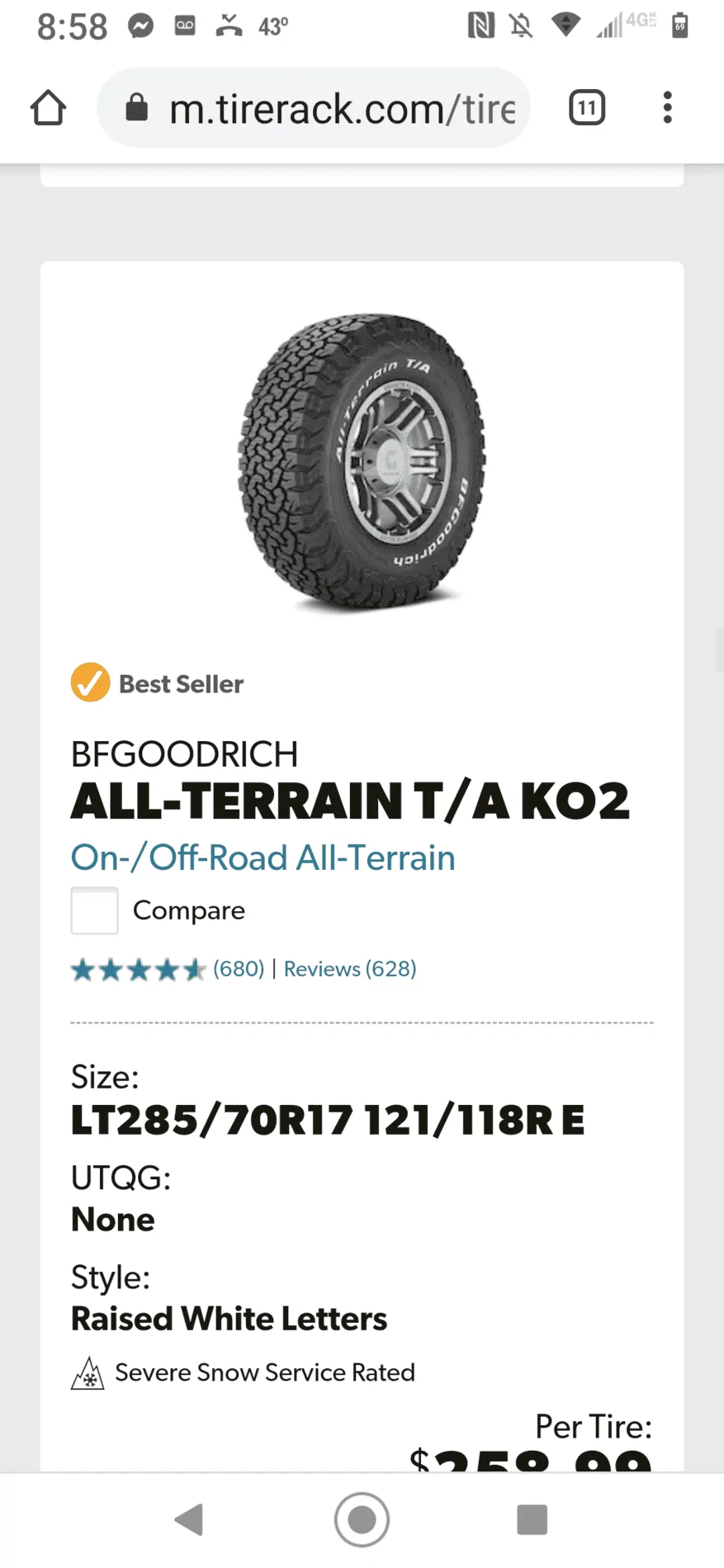

BFG KO seem to have the best sidewall protection. That's what I need out here. Lots of pokey stabby rocks.

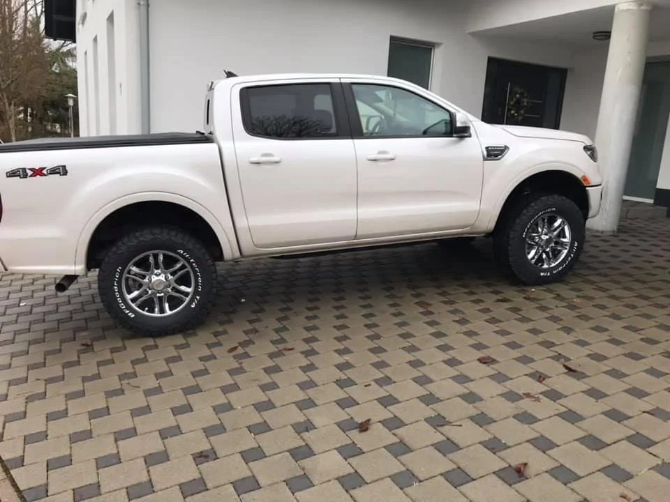

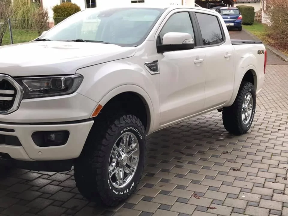

These are 18x8.5 with +30 offset.
Tires are 285/65/18
They sit right at the wheel well and clear the steering knuckles by an inch
I am running the Rangerlift.com 3” front spacer with Eibach pro truck shocks on the rear
