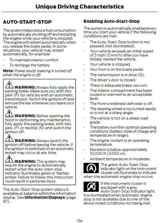

Its the auto stop start, it shuts off your engine which means the A/C too, there's a few threads on how to disable that feature.

Not just Ford, MANY other automakers use the same technology.
I came from an old ford fusion with absolutely no bells and whistles. So still adjusting to this new world. Thanks for the info! Just seemed weird to me to stop the blowers, but it makes sense. Just still getting use to it.

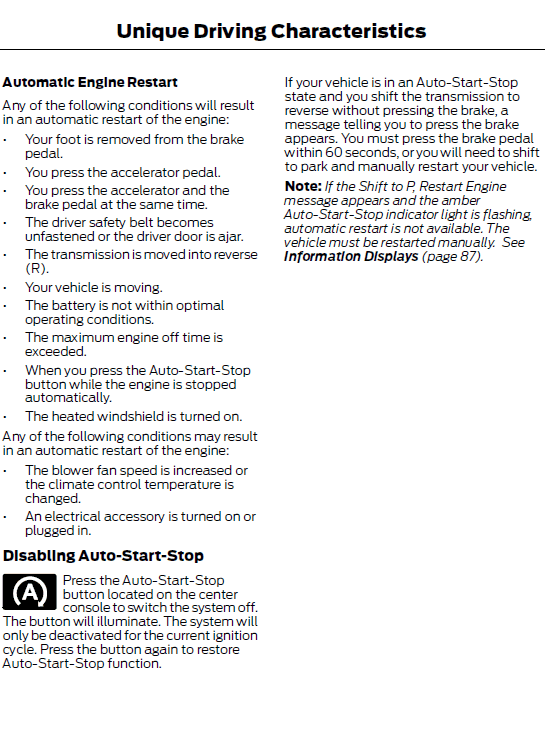

Hey, Keith, sure sounds like it is the auto stop/start at work. Just to be sure, when you start up today, either press the off button before engaging, or move the shift into Sport. Either of these will cancel the AS/S for the duration of the drive. A lot of members use more exotic means to turn theirs off for good, but I just stick to these basics.

my ac (at least the fan) continues to run during an auto shutoff and blows cold air, the engine restarts when more cooling is required
the temp change in the cabin is barely noticeable. theres no massive swings in hot or cold.
I would suggest you have a problem with your system and sensors, or in your understanding of how it works

Same. On mine, there may be a slight reduction in fan speed to save some power, but it doesn't affect the overall cabin temperature and it's certainly not a drastic or noticeable change it you aren't paying attention to it. If it senses the climate system isn't cutting it, then the engine will turn back on, I've had that happen before as well.
OP, you're free to disable the start/stop anyways in any manner others have noted, and it will subsequently keep the A/C on full when you stop at a light, but I'm not sure that's the real issue, if you're accounting is correct in how drastic the change is when the engine turns off. Seems like there might be something else going on.
