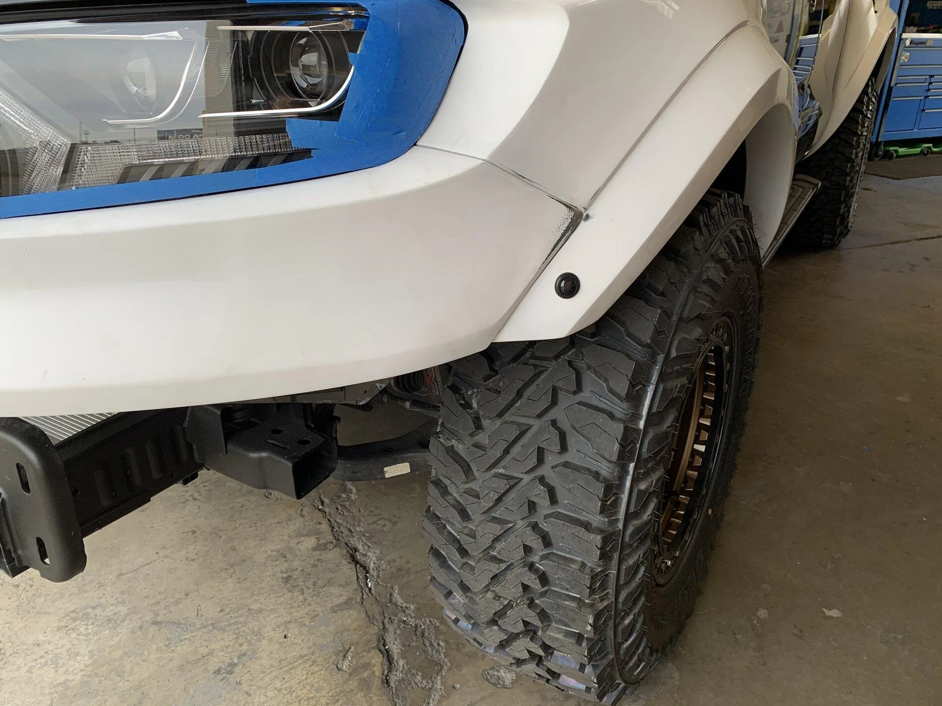

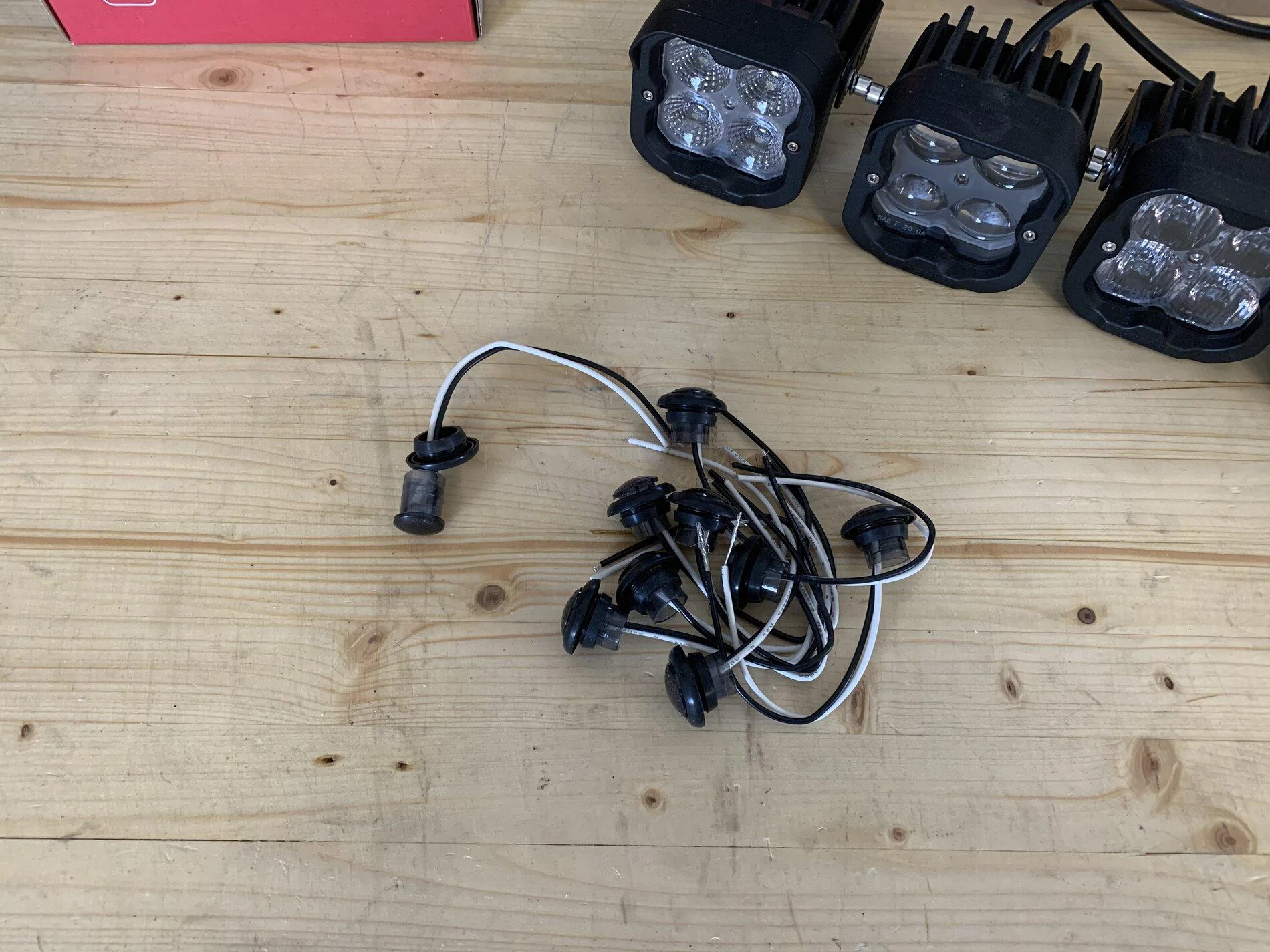

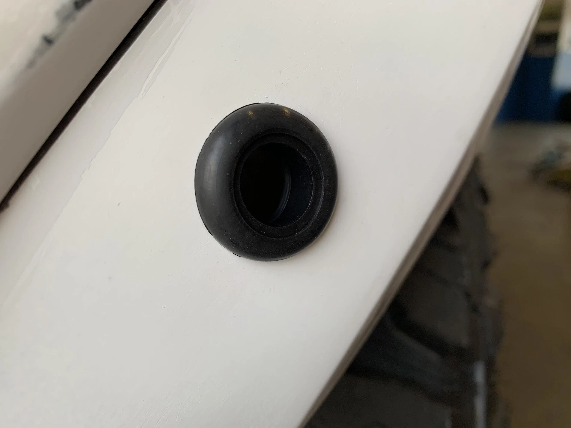

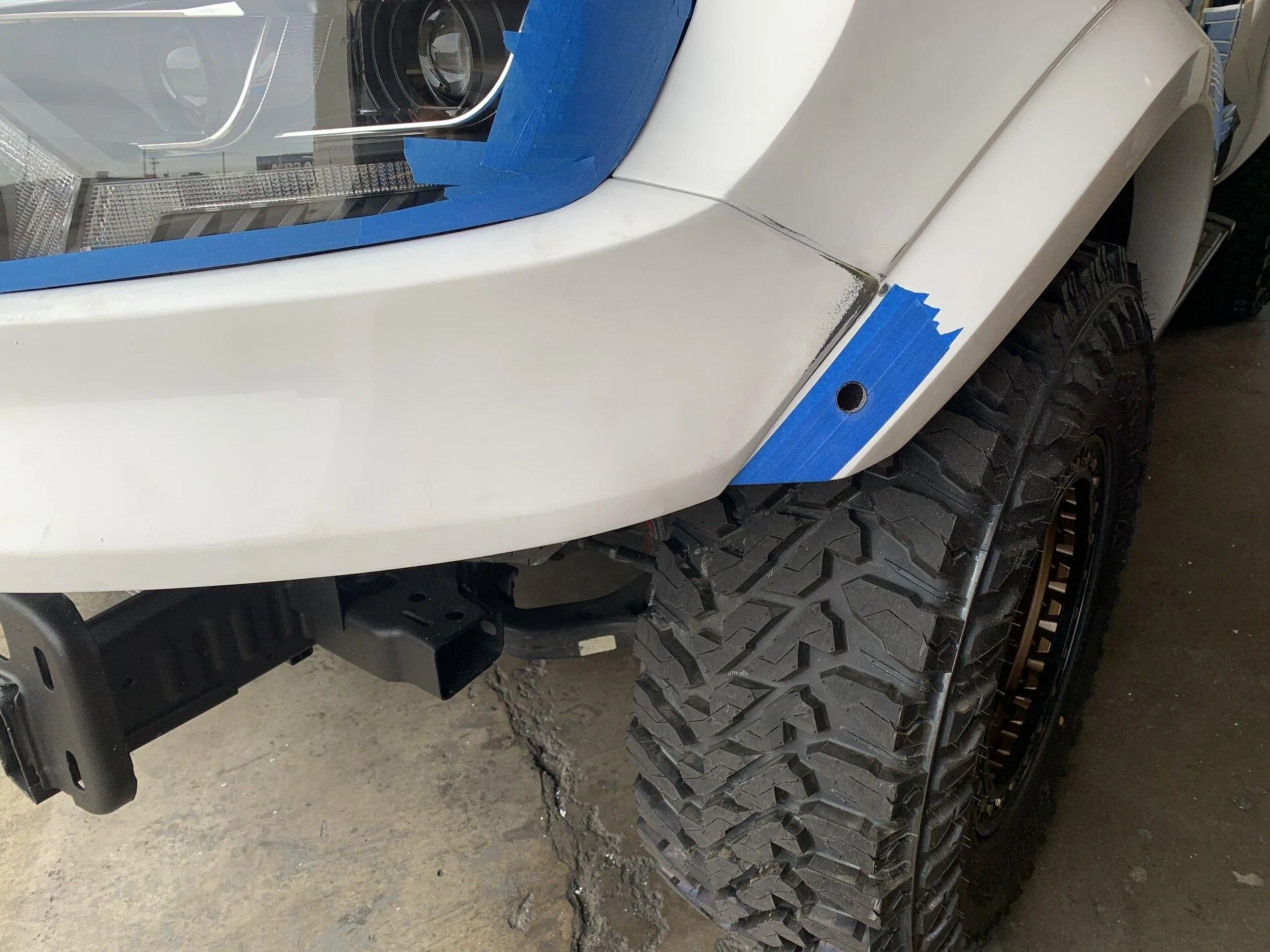

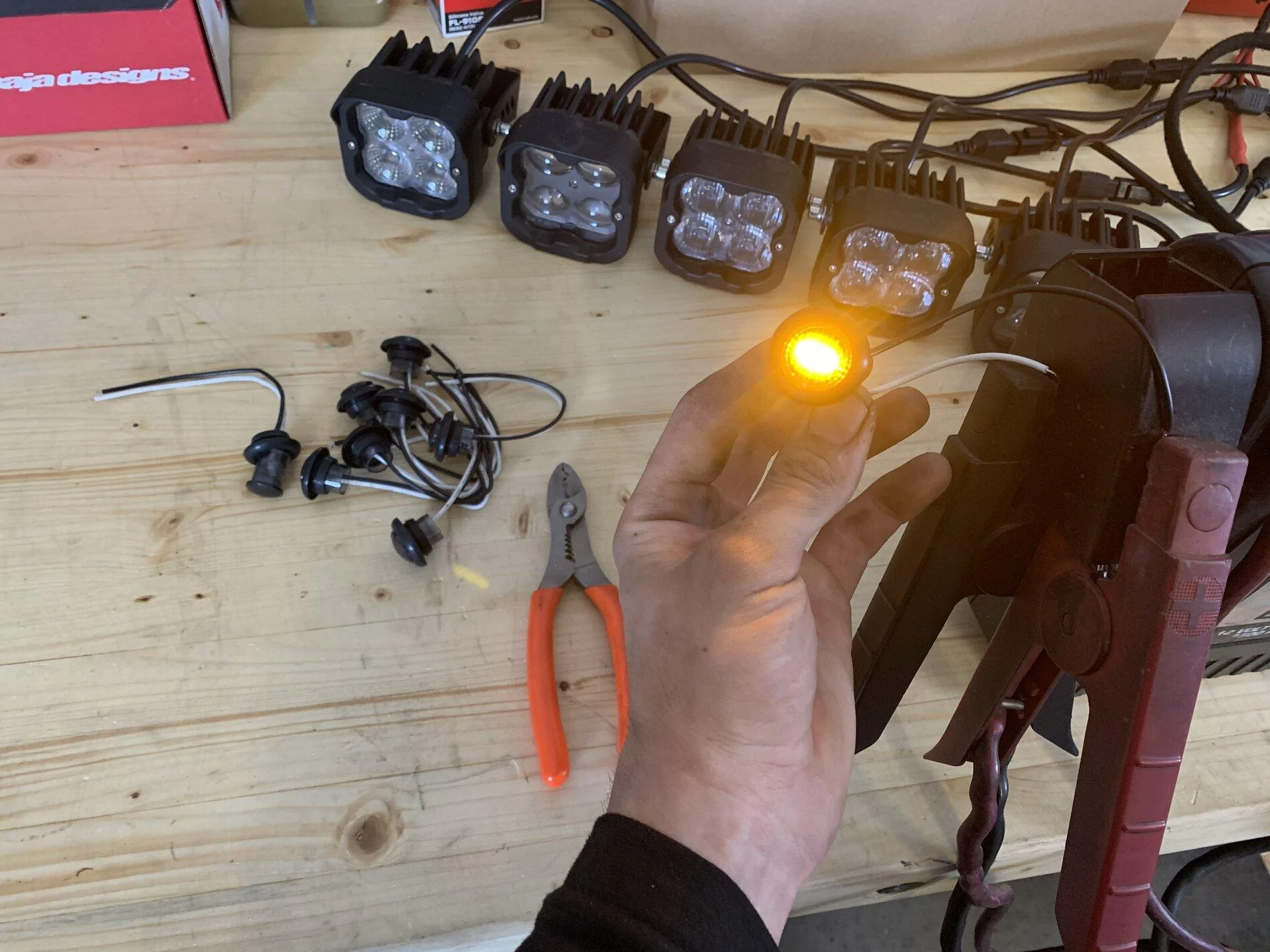

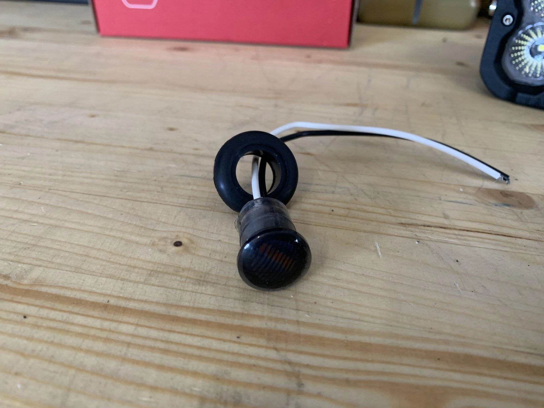

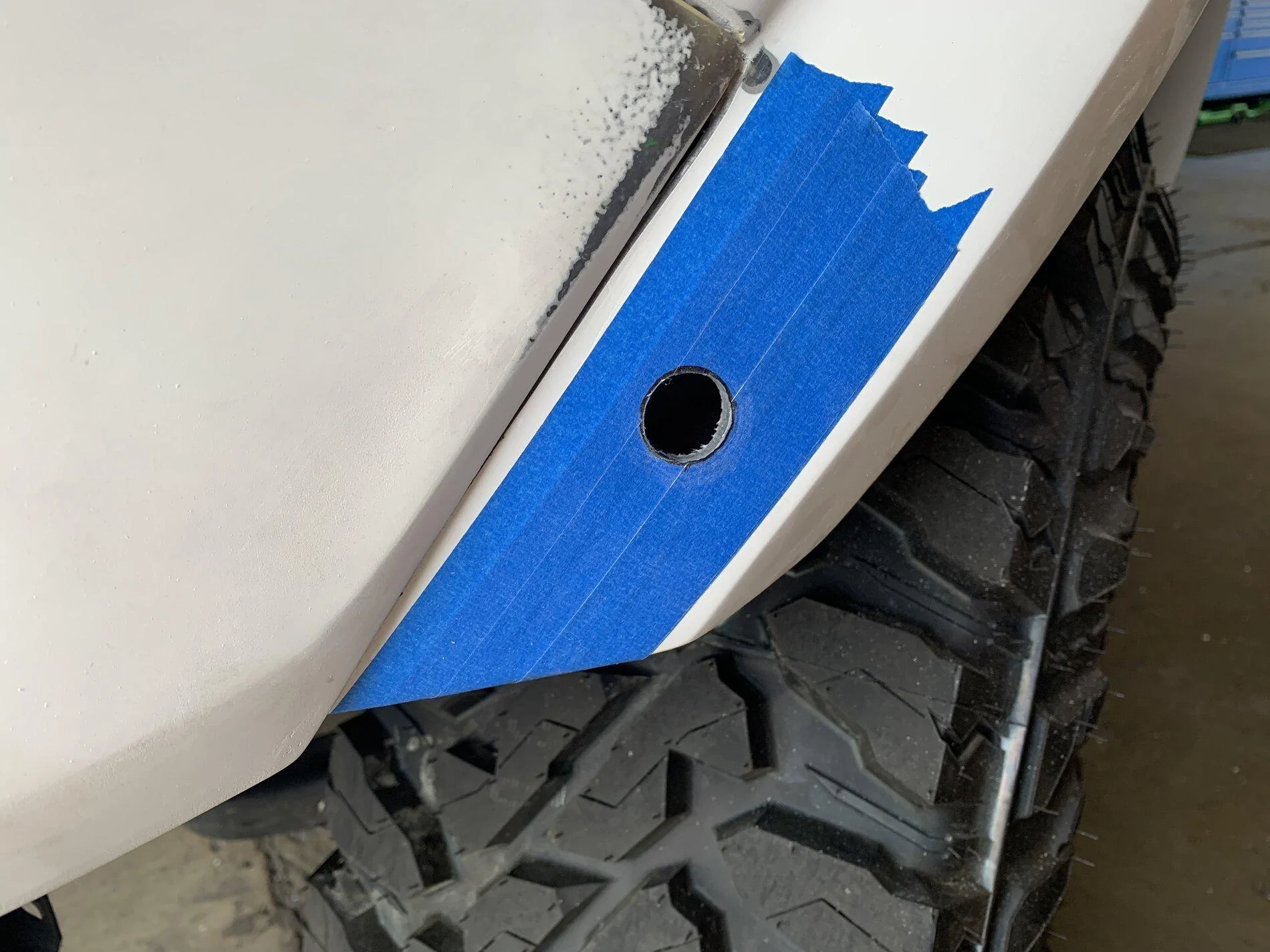

Im waiting for my paint appointment and came up with a little idea. Since the side marker lights wont work with these fenders. I had a bunch of little smoked amber lights left over from a previous project. I drilled a pilot hole then used a grinding bit and made a circle to match the diameter of the rubber insulator that holds the led. I will wire them to the original harness plug. Since im getting it wrapped a dark gray color it will match pretty good.

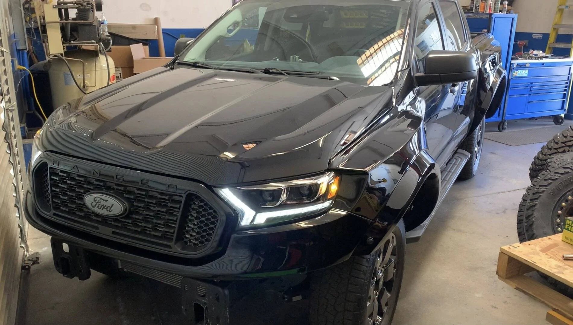

Yep ill figure it out thanks! I finally got my truck painted and installed the headlights. Over the weekend i will kill the suspension and finally drive it. It has been a minute ?

Sweet! Alpha rex's?
