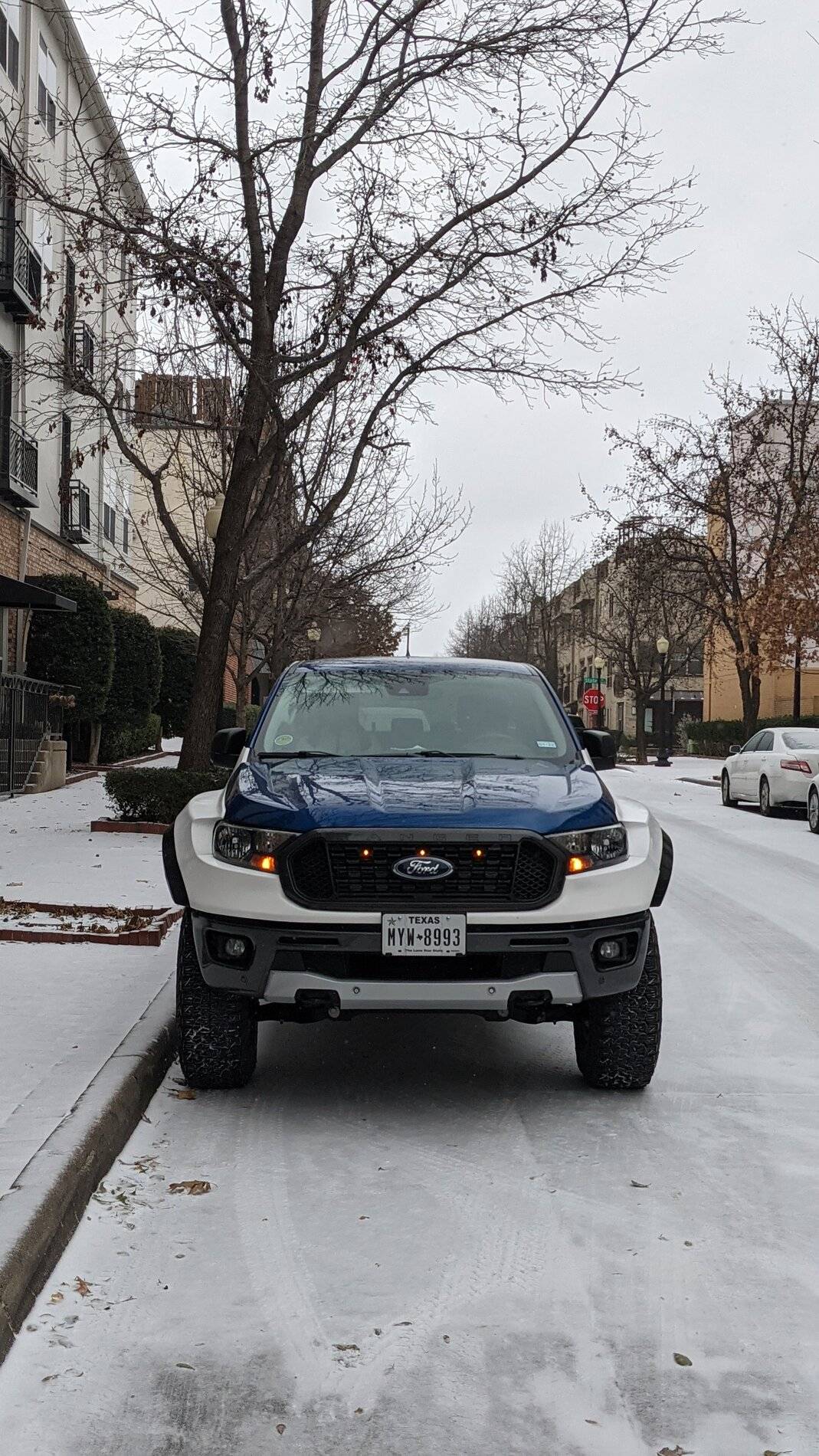

Just wanted to show a picture of the truck with the adv fenders and valence installed in relation to the stock front bumper.
These are 0 offset wheels wrapped in 33'" tires for reference.

I honestly like the look of the front bumper with just an aftermarket Skid plate or the smaller tube stuff like westin or so. The fiberglass is definitley on my list after reading through your guys posts. Thanks for sharing btw.
