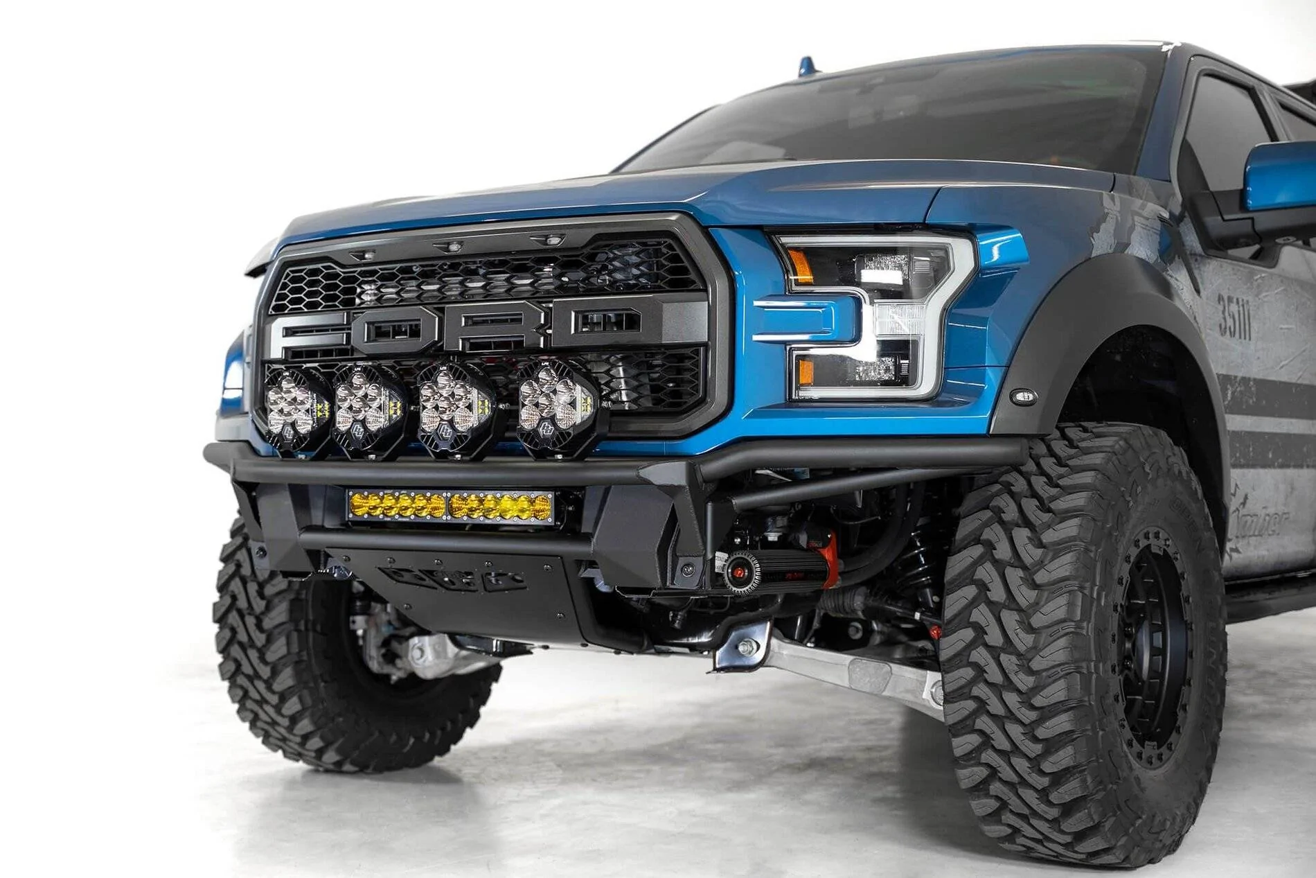

Its has been 2 months and 2 weeks now since i ordered a ADD 2020 raptor bumper for 1600$ i really like that style and they don't make that for the ranger. The ends will most likely need to be shortened an inch or 2 but the way the bumper is made it will be pretty easy to do so. I measured the frame rails on the raptor and they are not to far off compared to the ranger. So i will fab my own rail mounts and trim the fiberglass front valance under the headlights so it sits with the body lines like it does around the grill if the f-150. Should ship at the end of this month according to them. I cant wait i have my pods and everything ready to slap into the bumper.

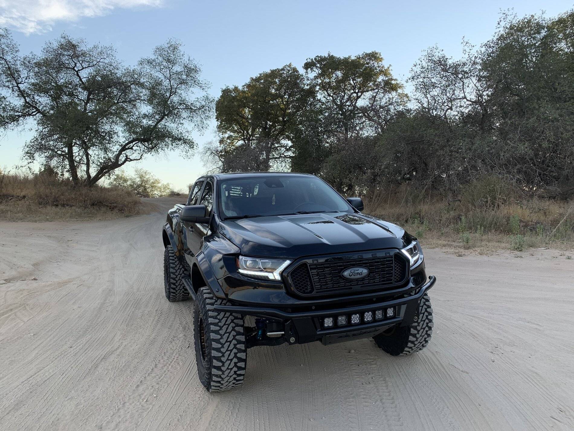

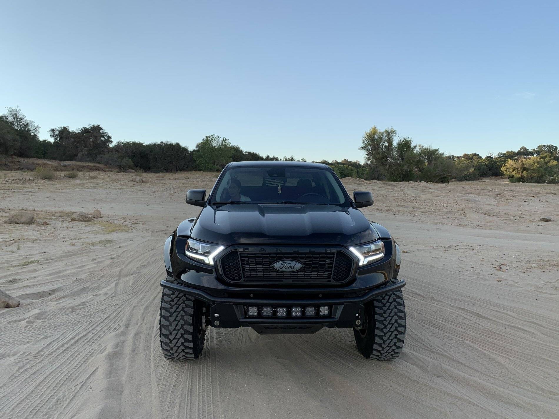

Ok other than the wrap, i have completed building my MALL RUNNER™️
That things looks so sweet! The bumper is such a nice touch. Looks similar to the SVC bumper for the Ranger but that one would have come up short with the fiberglass.

Thanks man! Yep i looked at the SVC and if i didint have the fiberglass i would probably have run it instead

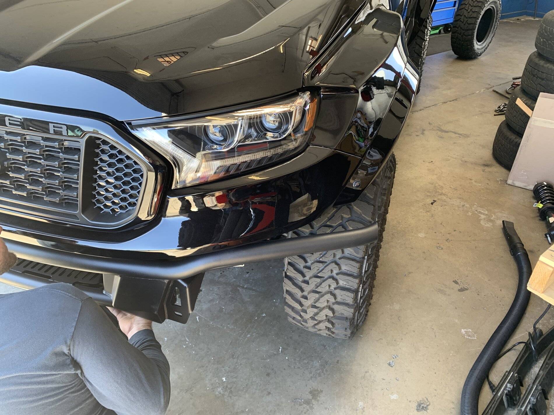

How did the front bumper install go? You should post a thread on it! I'm sure others would be interested.

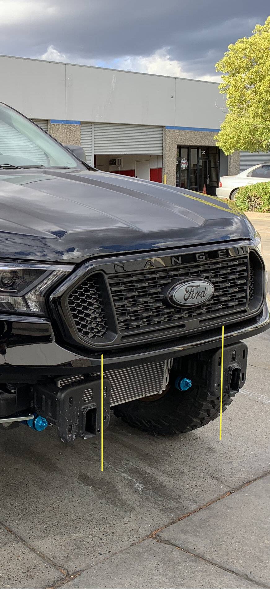

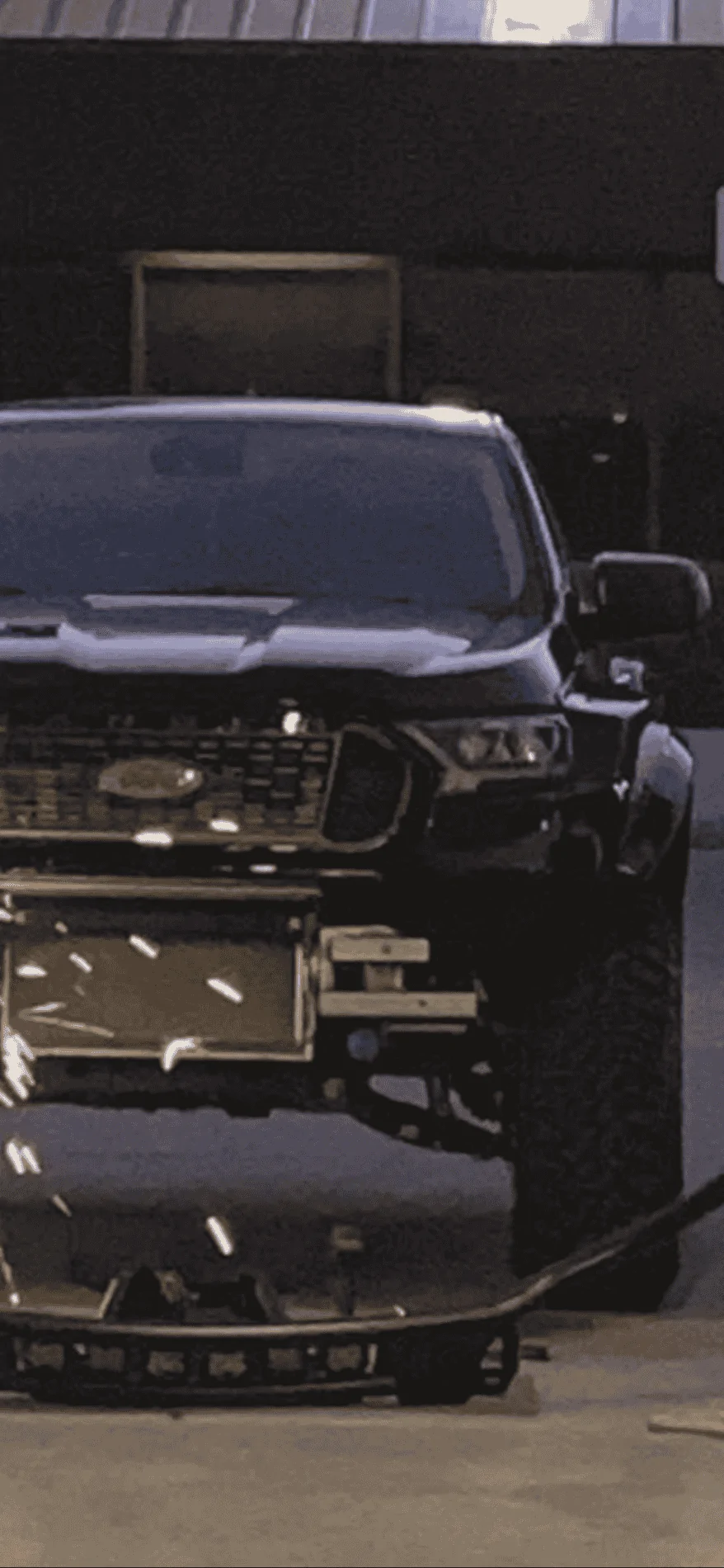

It needed some work to make it sit. I thought about doing a write up but im not sure if people will want to go that route. The face of the raptor is more squared compared to the ranger round face. So when i mocked up the bumper the ends weren’t following the curve. I have a pipe bender so i bent the edges in ( i didint go in too much because i wanted the bumper to take impact before reaching the glass ) them i had trim the rails a bit for the bumper to clear then i welded some thick square tubing to make new mounting points.
I mean I'm interested just to learn some fab work that pertains to the 5G Ranger!

Thats cool! The square tubing did all what was necessary it was used as a mounting surface and also to space the bumper out forward more. And i chose a thick one so it wouldn't buckle when tightening

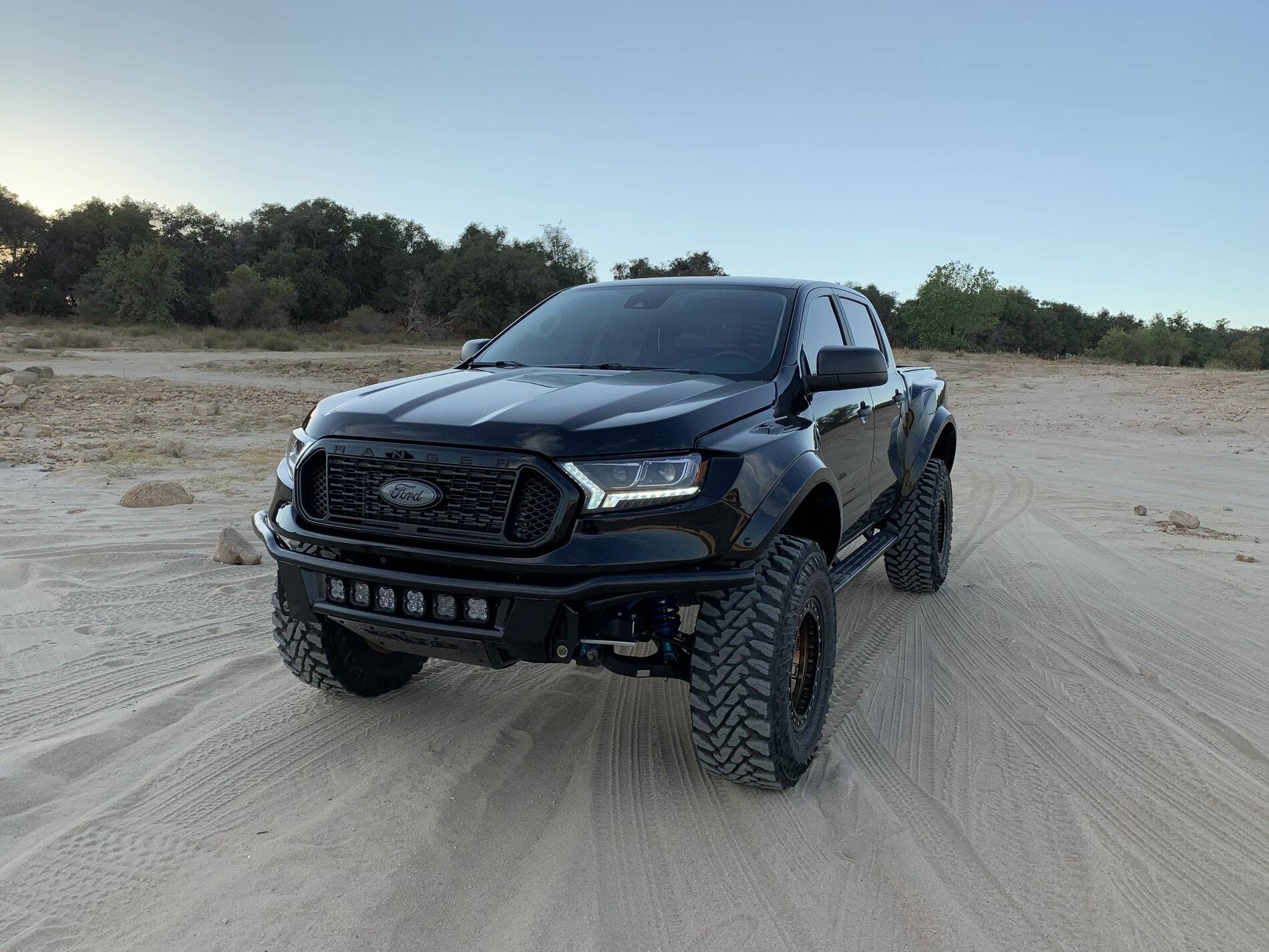

Wow, that's an awesome looking Ranger. Bad ass Ranger!!!
Can you tell us what else you did to your suspension? Tire and Wheel size?

Thanks! Wheels are 17” KMC Tank Beadlock -38 offset. Tires are 35x12.5r17 Yokohama Geolander. King 2.5 shocks. Upper control arms Icon leaf springs
