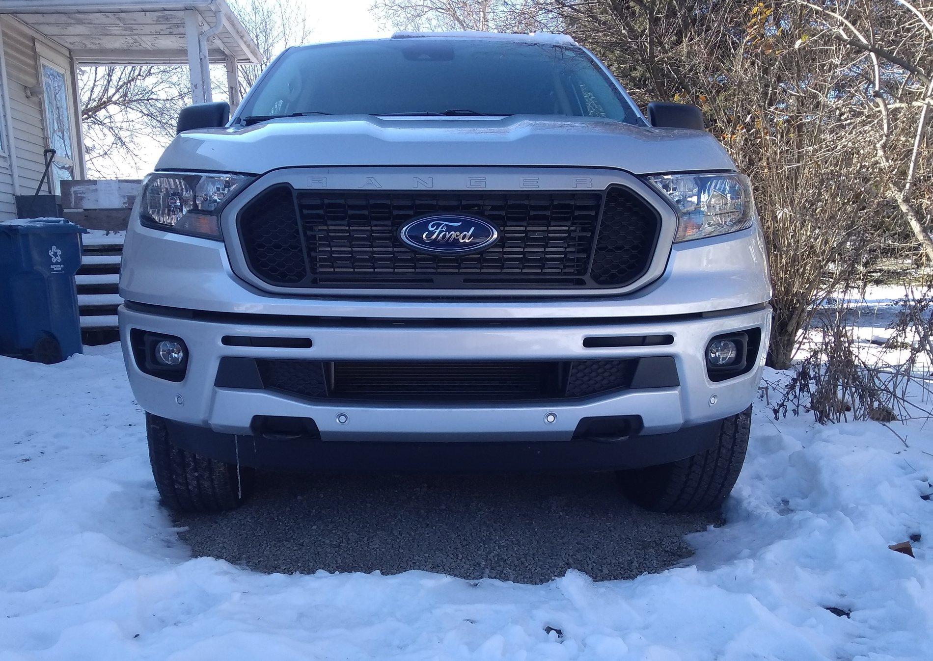

The gap between my front fascia and header panel is uneven. It is wider on the passenger side then it is on the driver side. I'm sure my dealer will tell me "its within spec" or "what gap?" I haven't crawled underneath yet to see how to adjust this, but assume it would be the main bolts that hold the fascia reinforcement to the frame. Anyone else have this issue or know if my assumption on the bolts are correct, or a better way to even this gap?
Did you ever correct this? Mine is the opposite..bigger gap on the driver's side, but obviously it will be the same procedure to correct. Thanks

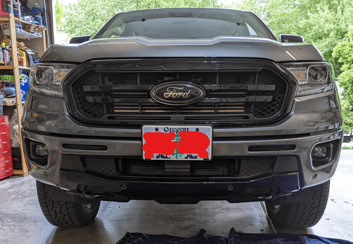

I corrected my uneven bumper gap this evening. My truck is 1.5 years old. The uneven bumper has always bothered me. See this thread for the instructions to get to the 6x bolts that hold the bumper:
https://www.ranger5g.com/forum/threads/2019-ford-ranger-bumper-removal.3489/
I corrected it about 50-70% better, not perfect. To get it better than that, I would have to loosen the bolts on the other side more than I want. I think that would cause that side to droop and then it would be a PITA to get it all even again.
Note that the bolts holding the bottom of the plastic fascia are 10mm, not 11mm as stated in the PDF on the above thread. That plastic fascia removal was the most time consuming. I was worried about breaking it. I had to reinstall most of the metal clips on the fascia side in order to re-install it.
Here is the after picture.
