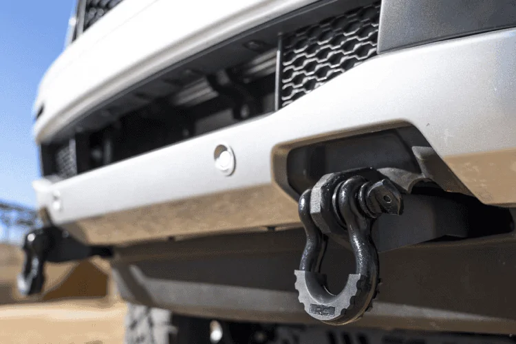

I'm useless with this forum's search and I'm sure this has been covered many times but ...
I have '22 4X2 XL 101A with a tow package. Nothing else (except carpet). So what do I need to add front tow hooks? Not for off-road recovery but possible snow and ditch (preferably helping others, in cars, that have slid off the road).
It looks like I need the hooks, a different front valence, and some rubber inserts?
I saw this thread but I'm not sure that'll work for me and if that's all I need.
https://www.ranger5g.com/forum/thre...-fact-ford-deleted-the-front-tow-hooks.14683/
I would also like to pull from the rear, is the receiver sufficient? It doesn't seem like that would have enough strength.
Thanks!

I use that...THE best option IMO...
Nice and how was the install (apart from those of us needing to cut the valence).
Looks like it should go smoothly (except the getting on the ground part, I may not get up!). =D
9,234
28,611
NWO Robot Polisher
It was super easy...just unbolt the original tow hook and replace with the new bracket and attach your choice of shackle...I bought mine on Ebay...
