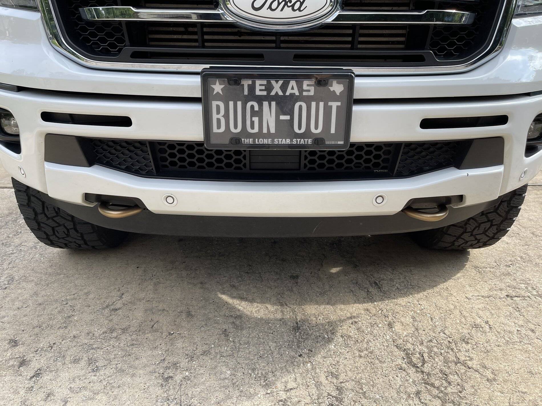

Bummer, they were stock on my 2019 Lariat 2WD. Not sure, but maybe they were included in the tow package which I have. I painted mine to match my matte bronze wheel color.

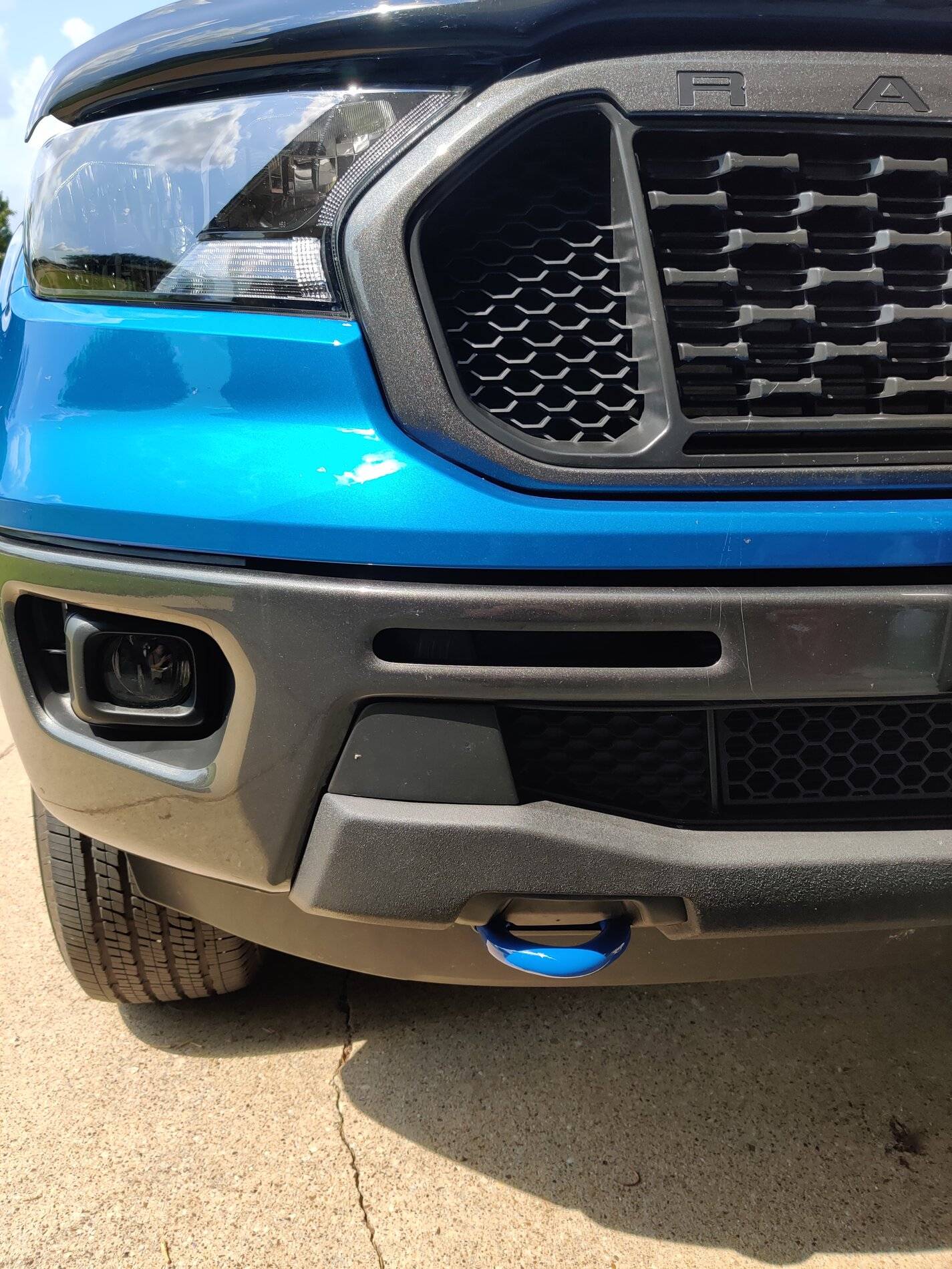

You can add them, I just did on my 21 xlt. I just ordered a new front valance with the cutouts $140, sprayed it with truck bedliner $16, blue tow hooks $105, 4 bolts and the two rubber inserts that go around them $50. Used my Ford reward points from the purchase, Only out of pocket about $100. I can get you the part numbers if needed. The bolts and rubber inserts were the hardest numbers to find.

yes if you can provide part numbers please! Thank you.

The valance comes primed and will need to be painted or coated in liner or plastidip.
Valance with hooks and front parking sensors: KB3Z-17626-DAPTM
Valance with hooks, No front parking sensors: KB3Z-17626-CAPTM
Tow hook bolts, you'll need 4.: W720626-S900
Blue hooks I have : M-18954-RAB
Red hooks:M-18954-RA
Rubber inserts around the hook:
Left/Drivers: KB3Z-2101927-B
Right/Pass: KB3Z-2101926-B
They also have chrome hooks and black hooks, but I don't have the part number for those.

Thank you! Very much appreciated

It's much cheaper to get black tow hooks and repaint them with epoxy paint than to buy them in blue/red. The black ones are nearly 1/2 the price of the red ones.

is yours a 2wd? Ive been reading more online and have seen that there is no place to mount the hooks?

Mine is 2wd, the threaded holes were there to mount the hooks.
