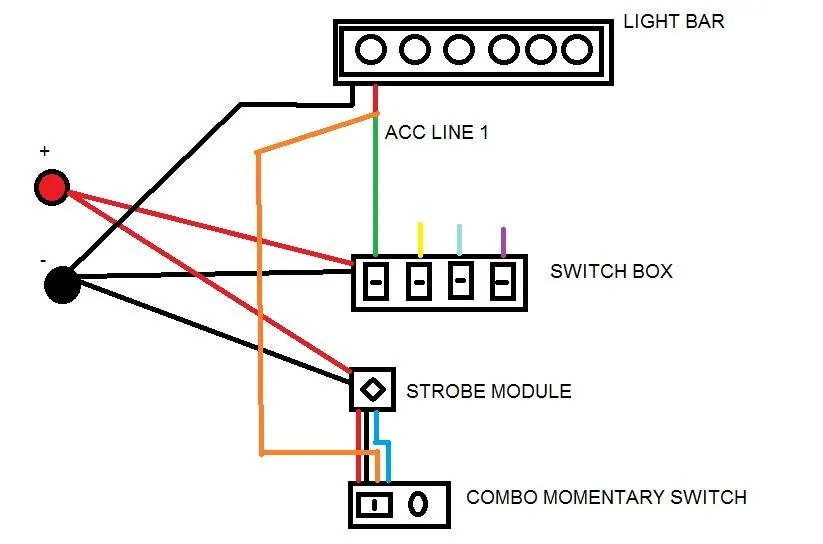

I want to wire the ability for my various lighting equipment to strobe. My question is not so much about strobe modules themselves, but in my specific case I want my switches physically separated while also retaining constant on ability. Yes I know there are all sorts of fancy systems out there, but my system are rocker switch in style as I'm trying to KISS and avoiding any wireless or fancy lighted buttons.
In usual fashion I have crafted a masterful schematic using MSPaint.
Basically I have my standard switch box for standard on/off. Then I have a different switch in a different location to feed power and then momentary capability to cycle patterns.
Is this wired correctly or did I botch something simple?

Looks legit to me, but what happens if you accidentally throw both switches? Aren't you an LEO? Could you run it by the guys that outfit your cars?

The way you have it drawn out...it ain't gonna work.
From your drawing and your explanation in the preceeding posts, you're trying to strobe your marker lights and an auxiliary amber. Unless you have a strobe module that works specifically with CAN BUS vehicle lighting sytems, you will likely backfeed voltage into a module not designed for that.
Assuming you have all the correct components, if you connect everything as you show, all current flowing to both the strobe module and your lightbar will flow through your switch. If you're ok with this, you need to make sure your switch panel (and all wiring) is rated to handle the amperage(current) flowing through it. Ideally, you should switch the circuit with a relay.
The momentary switch should be connected to the wire from the strobe module that controls pattern selection which usually requires either a voltage or a groung signal to switch patterns. Not to the lights.
In this case, the KISS rule necessitates purchasing the correct equipment and utilizing correct implementation processes for the task at hand. It'll save you time and money in the long run.
When I refer to marker lights I mean ones I am installing on my roof platform, not the factory marker lights.
My current system is walled behind proper relays and fuses. The drawing is for basic troubleshooting, it is not my literal setup.
Sorry that was an error in my drawing - I am looking at combo switches where the third line is internally built in (aka why it is a combo of a switch and a push button. However this is still a third line which I believe is going to be your ACC connection.

I might just say screw it and get a Feniex Flasher module. Trusted enough for emergency vehicle use so I may just have to go the practical route.
Hi Jack,
As other said...I was concerned with back feeding and what we call sneak path. Sneak path analysis of a wiring loom is sophisticated but ids areas of problem not readily available to a visual wiring diagram. Airline industry is a leader in sneak path analysis as it is critical. I thought about your wiring diagram and instead of an immediate response I pondered maybe installing diodes and then concluded that this would not work either. Probably better to take the Feniex route...
