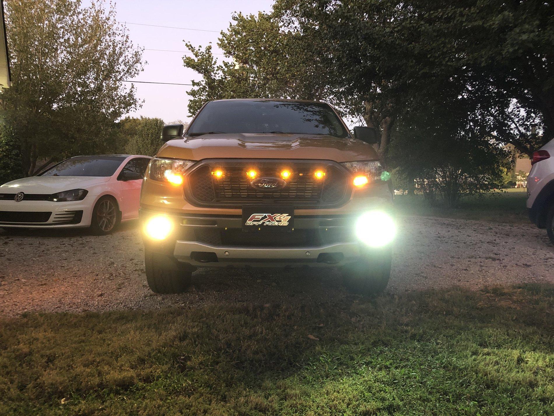

Since adding LED fogs I have not been flashed. I could see low beam LED’s being an issue.
LED fogs do help with seeing objects, even without fog.

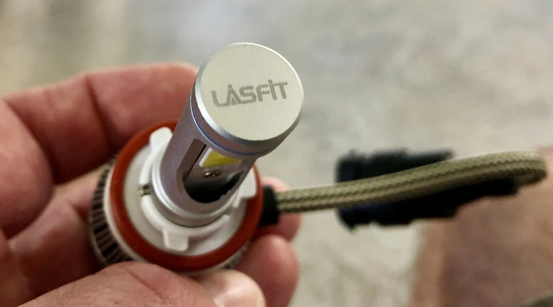

Share? Since my wife has stopped using the fog lights, she hasn't reported anyone flashing her. Also, when I installed the bulbs in the low beams, I adjusted them down a touch to put the beam back where the halogens were ( it was a very slight adjustment ). In my case, I think its a difference in shielded vs unshielded housings and the fog lights are not. Some led's have a sort of shield on the end of the bulb, mine do not and I think this is causing some of the issue.

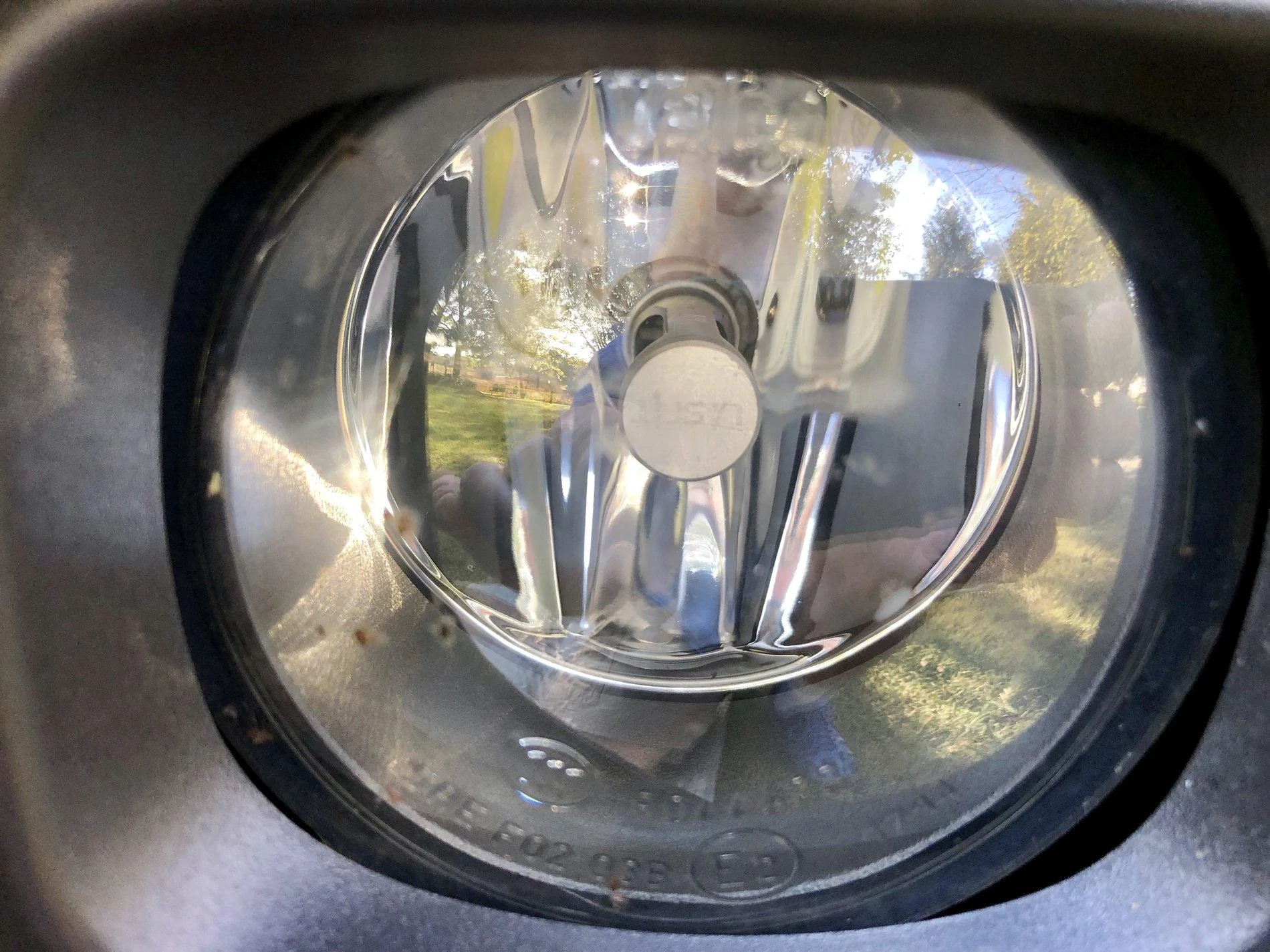

BTW, I still haven't found a piece of flat level ground to check the beams. Joys of rural living.
Share was for instructions on adjusting fogs as you stated.
My fogs have flat front and project left and right as reflectors are designed to receive this way.
