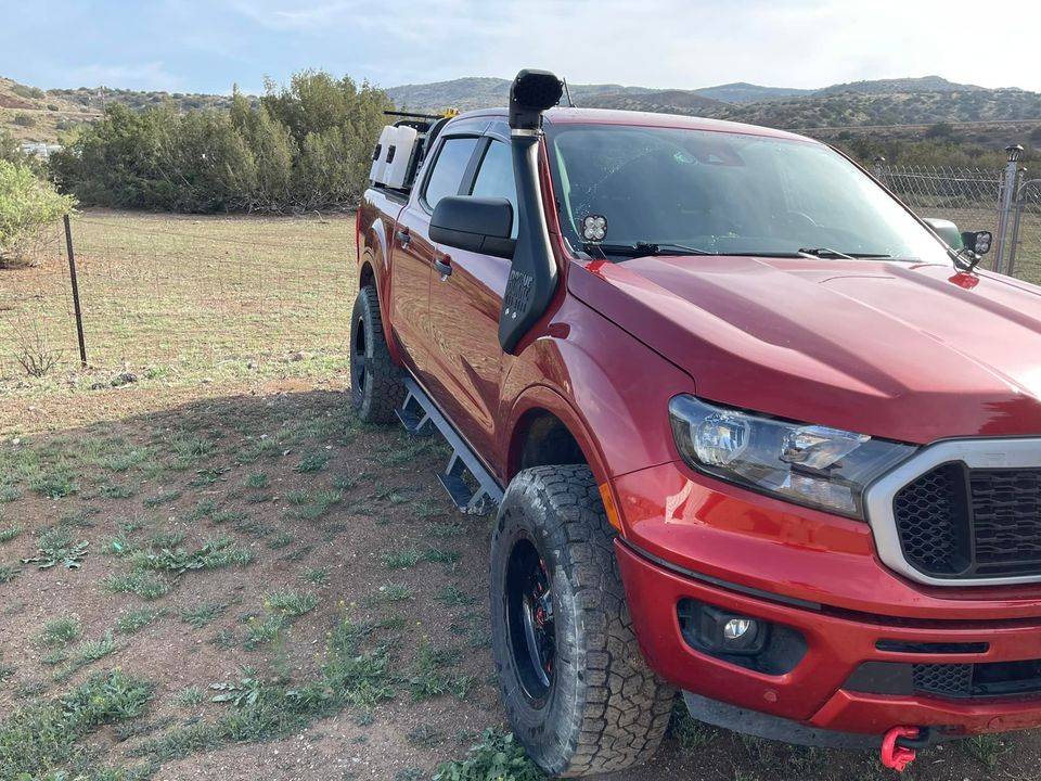

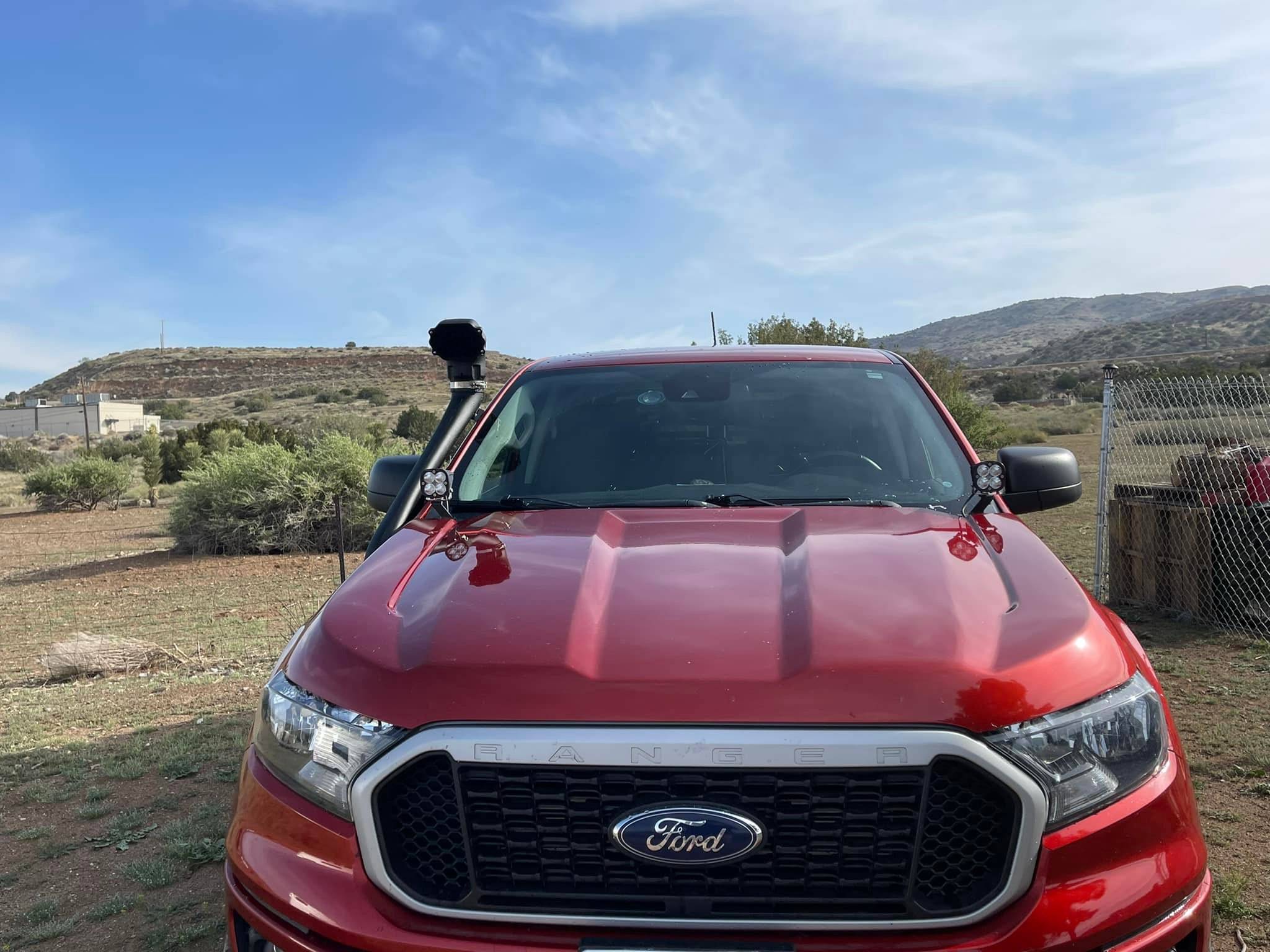

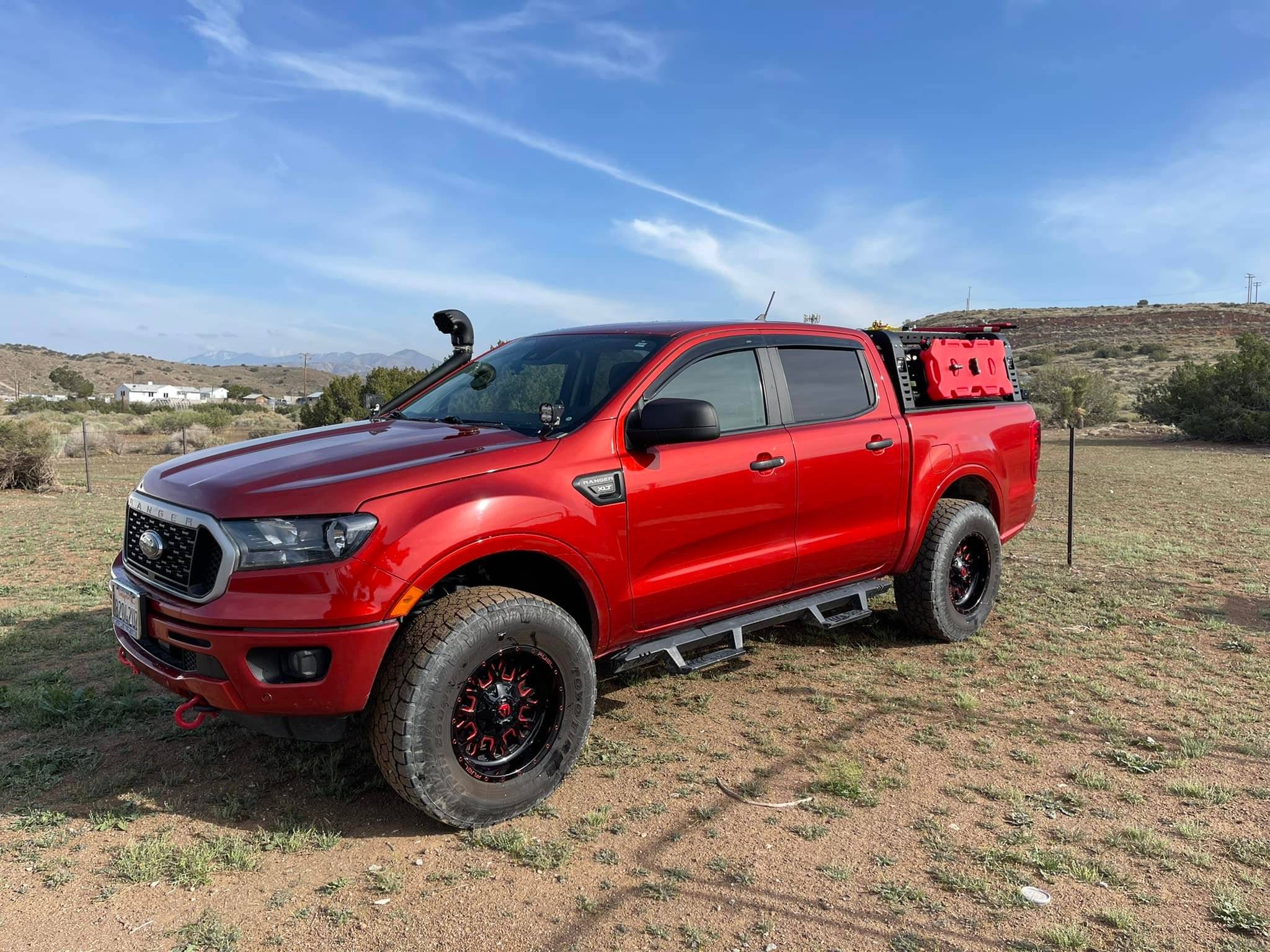

Added a Mishimoto, Borne Off-Road Snorkel
Sketch
Sketch

QUOTE=["Aonarch, post: 401968, member: 13318"]
How is the fit and finish?
[/QUOTE]
Very good and solid. I had to make a few adjustments in terms of hardware. Mainly due to the foam gasket that seals the snorkel to the outside fender. It's about 1/2" thick and the included M6 bolts were just too short to grab a thread, even with applying compression to the snorkel. I went and got some bolts that were 1/4" longer and that did the trick.

Notice any difference in MPG/power/sound?
Sketch
Sketch
Danny
Jun 16, 2020
56
216
Palmdale CA
2019 Ranger XLT 4X4
Public Affairs
MPG - The jury is still out on that since I've only driven it two or three times since install. We are heading for a camping trip in the wilds Utah next week, so I'll have a better idea at least in Hwy MPG.
Power - No idea, I always drive conservatively and don't put my foot into it unless absolutely necessary. Maybe I can say more after going offroad next week.
Sound - With the windows up, no difference in sound. With the windows you can definitely hear a deeper, throaty sound and the turbo is noticeable.
