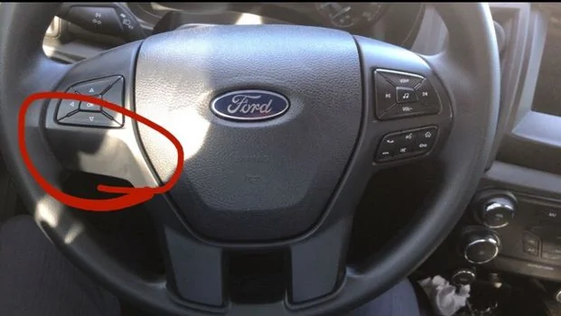

Hello! I am from Brazil. I have a 2022 Ford Ranger XLS 4x2. There is no cruise control on the steering wheel. Installing a steering wheel with controls or only controls on the steering wheel, I managed to activate.
I made the following changes in forscan and it worked:
PCM - Adjustable Speed Limiter: 2 - With ASL, Less ISA (enables ASL limiter)
SCCM (as-built format) 724-03-01 - X5XX XXXX (enable cruise and ASL limiter command)
IPC (format as built) 720 01-01 - XX5X XXXX XX (enable ASL limiter)
BCM (as built format) 726 13 01 - XXX8 XXXX XX (active cruise)
In my vehicle:
SCCM (as-built format) 724-03-01 - 1543 0000 (enable cruise commands and ASL limiter)
IPC (format as built) 720 01-01 - 0459 1464 60 (enable ASL limiter)
BCM (as built format) 726 13 01 - 4108 2025 00 (active cruise)
It is important to do the Checksum Calc as your vehicle's checks may be different. I used the following link:
https://compulsioncode.com/Project_AsBuiltCompare.aspx
Before:
After:
