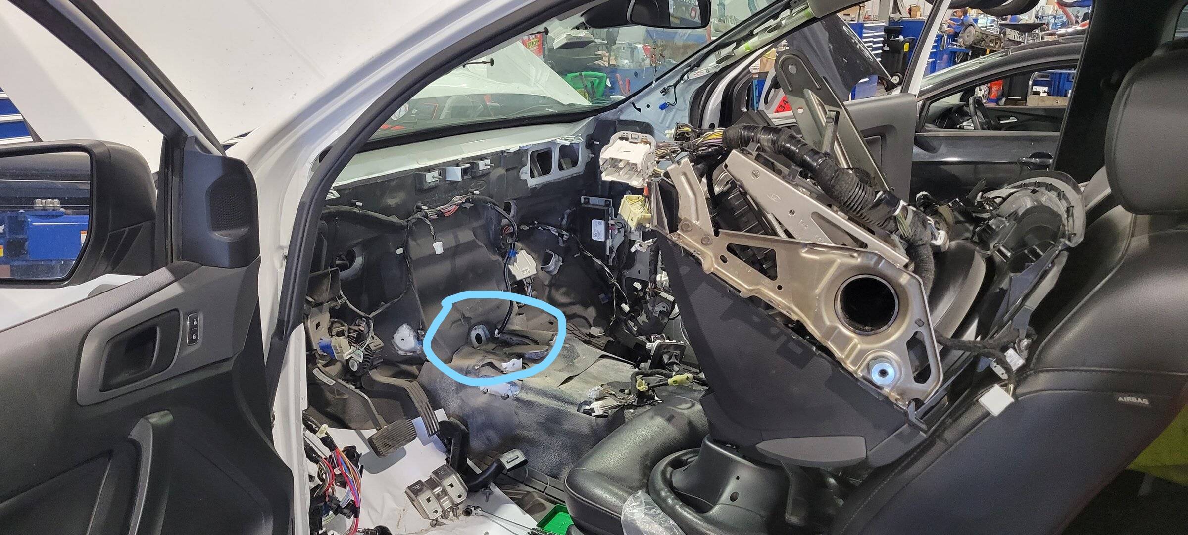

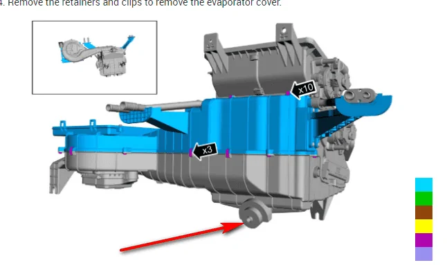

I am guessing here, but by using this borrowed pic, and other descriptions of it draining on top of the tranny. I believe the circled area is for the drain.
This may help in locating it from underneath.
The manuals only mention ensure no blockage, but no location of any kind is given.

Ok thanks, I have friends that I've ask and they say that they see their's draining. But I due run mine in the recirculate mode.....thats a great help with the picture.
