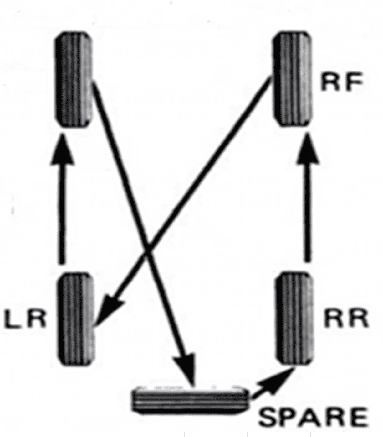

of note, the dealer rep and the mechanic thought a 5 tire rotation was the craziest thing they had ever heard of and had to have it explained 8 times. here is the recommended rearward cross 5 wheel pattern for a 4wd truck:

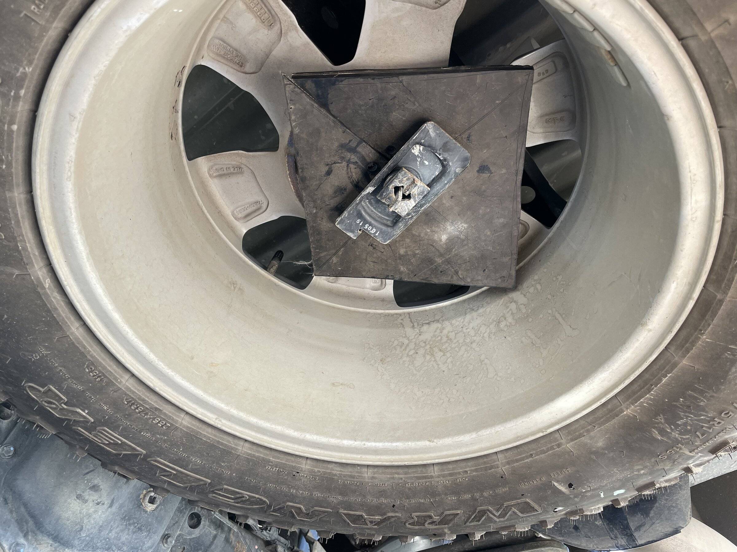

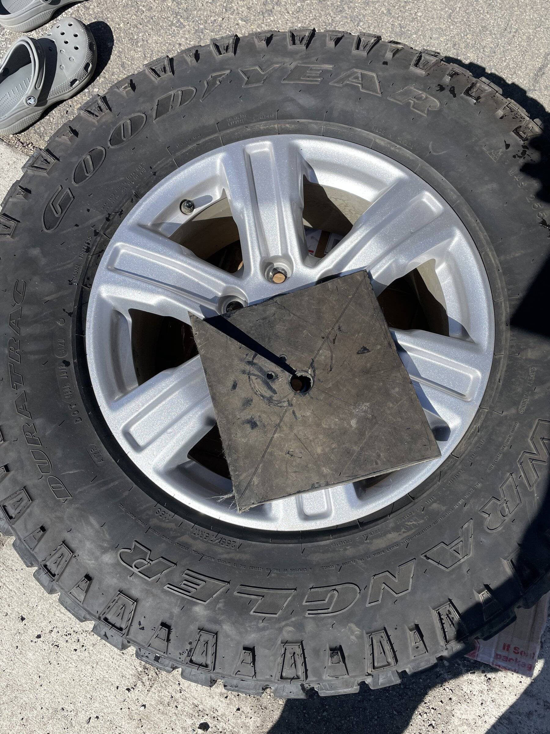

to protect the spare wheel from damage, i have it mounted upside down (no access to the valve). this puts the aluminum face away from the road debris so it might not get dinged offroading. i dont care about no valve access because our truck always has an air compressor in it so i dont need to check tire pressure or top off while just living life. to protect the aluminum from the steel bar holding it in place, i have a square of hard rubber (a scrap of conveyor belt) that i cut a hole and s slot in to protect the aluminum from the steel. hopefully this will result in less scratching and less corrosion.
