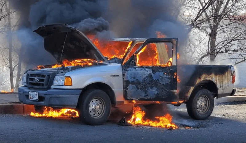

I'm getting NHTSA ads while reading this thread for recalls... time to check the 'fuel in my oil' thread
Flambé Ford Ranger ? ?
