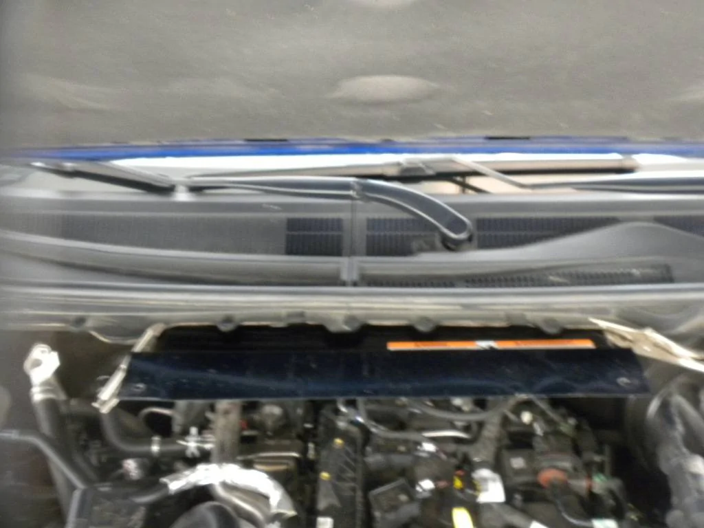

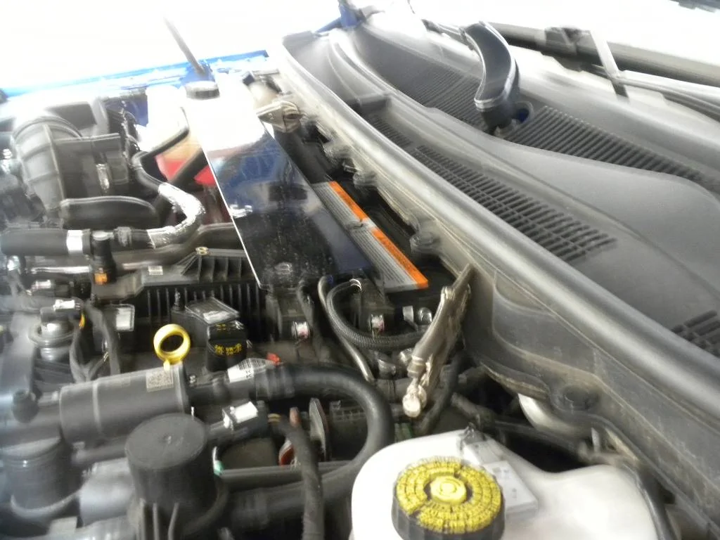

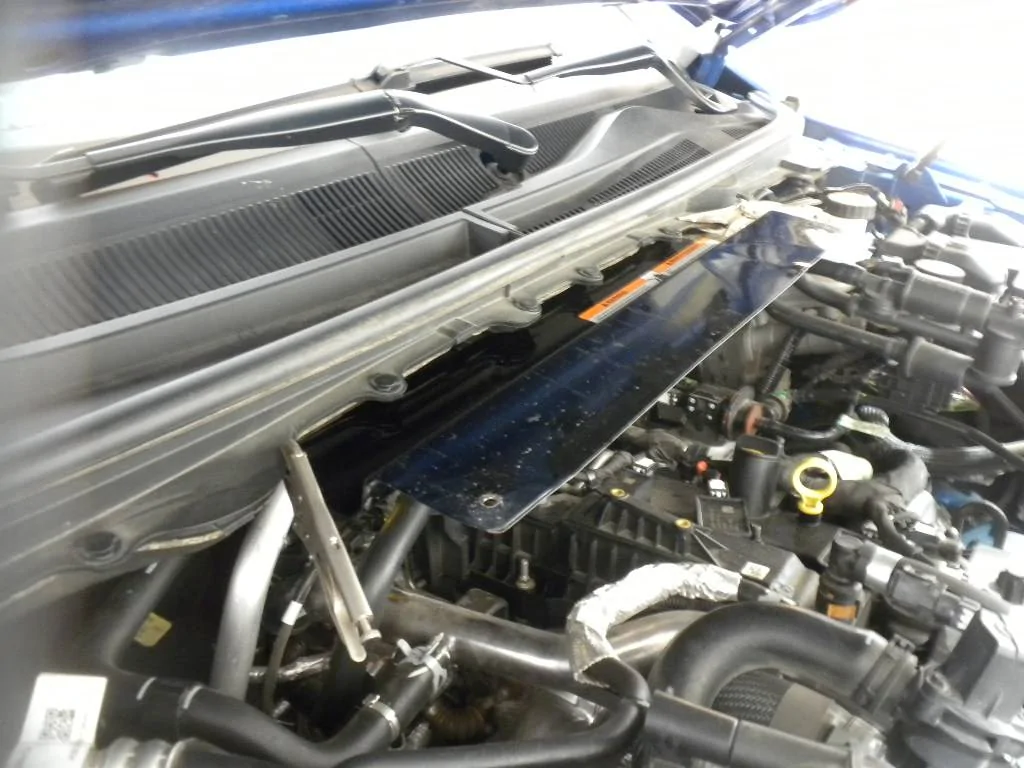

I presently do not have that issue, but since I recently acquired a piece of material that when I saw it I said this has a purpose. The photos are of the first time just stick it up to get the idea. Much refining to do, but it might work. I think this is how Mike (FitzStick) started. 🤔

Needs a lip around the edges to channel the water in the direction you want it to drain but you're onto something

Looks like it will redirect right into plug #3
