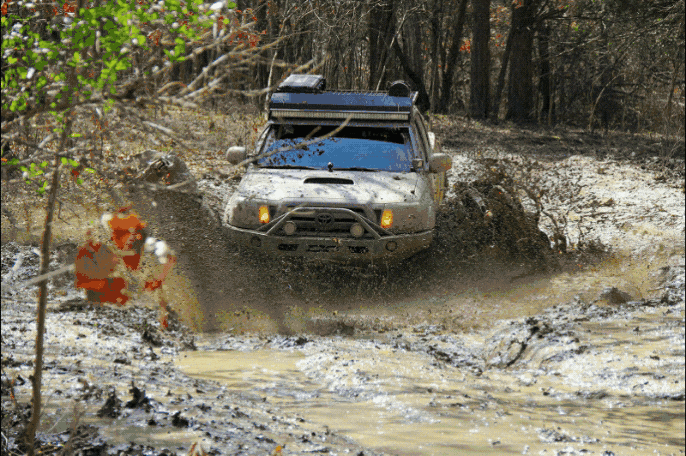

As stated above, it is recommended you try not to pass the center line of the wheel.
Now I have gone well beyond that and been fine, but every situation will be different. I can tell you I did a couple water crossings in Osceola National Forest that swallowed up the wheels. Biggest thing too is clear water vs muddy water that can really gunk stuff up.
As you can see in the pictures, the water depth was deeper than recommended by the factory. And that's with me staying away from the center of the pit.

I had the luxury of my brother going first in his Power Wagon , so I had an idea as to what parts to avoid. Though the pictures may show otherwise, I did enter the waterhole at a slow speed, and then got going once I was committed. The sand was very, very soft and I did not want to get stranded halfway through and really get stuck.
Take plenty of pictures, I have been wanting to take a trip out to Big Cypress.
