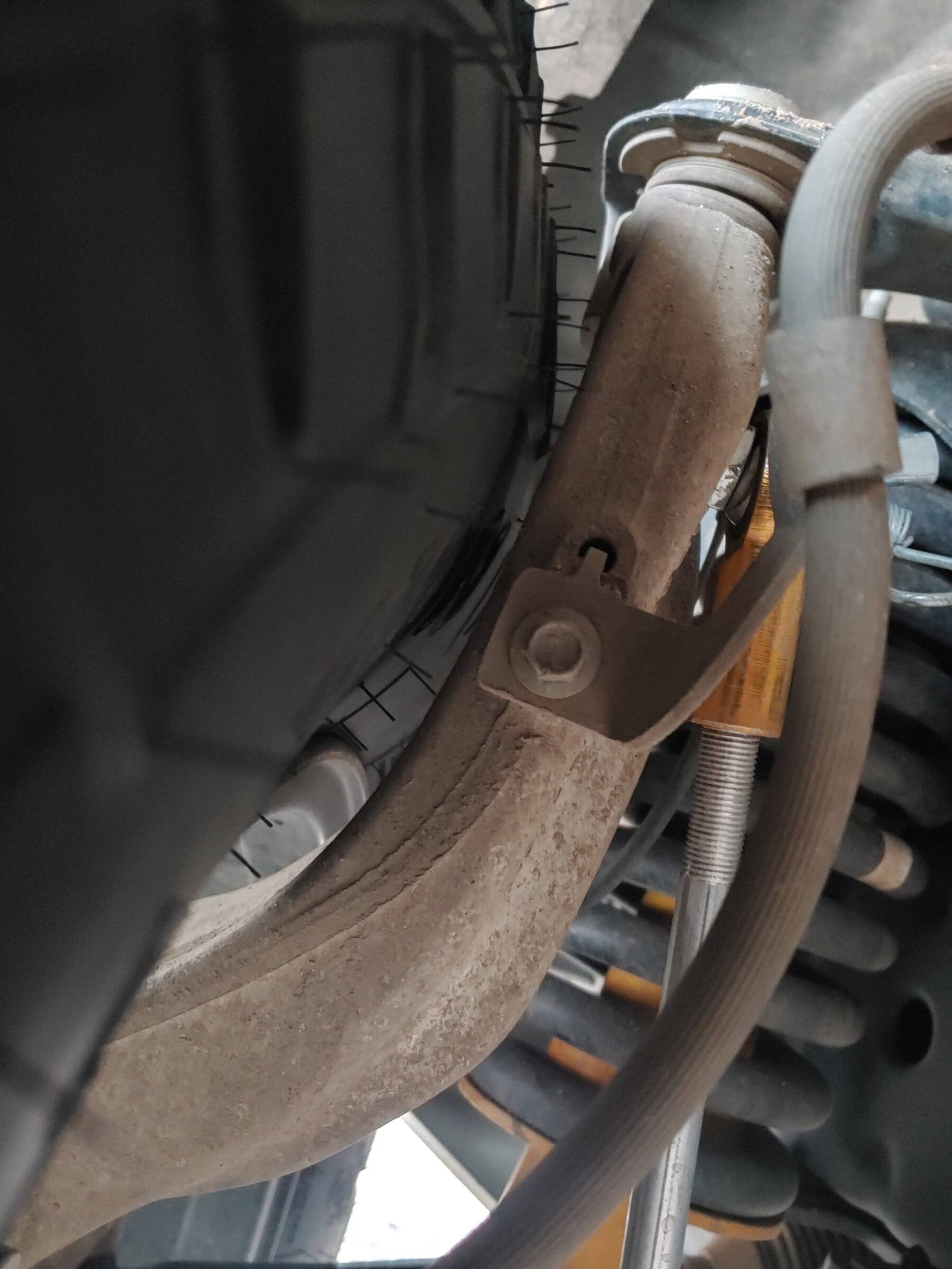

Just want to add on the crash bar thing. Depending on tires and setup crash bars may not need to be messed with. If you look at mine I simply have the plastic cover removed and the bars pushed forward. Nice and easy in my opinion
