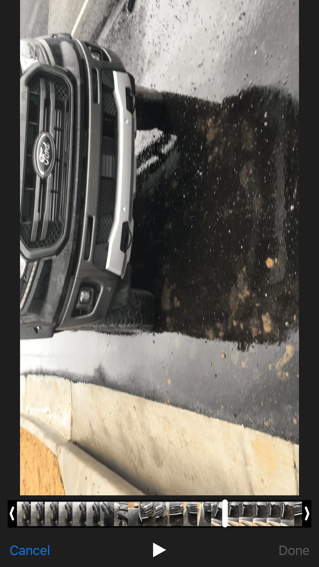

Pics of the lift, or the problem with the leveling kit? I have pics of the lift and a video of the level issues with the Nyloc nut coming loose. Not sure if the video will upload but I will try. It’s not very educational, mostly just me being p*#^ed.
The video is apparently too big for the site to allow me to upload.
And by the way, as far as “pics or it didn’t happen”, you can believe it or not, that’s on you. At first I was wasting time trying to figure out how to post the video or a still shot and then I realized, “wait, I’m a grown man trying to help folks and share info, slow down, drink your coffee and go to work.
