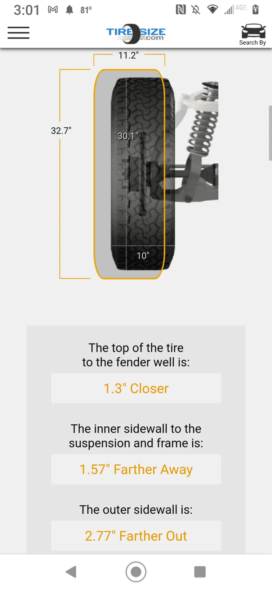

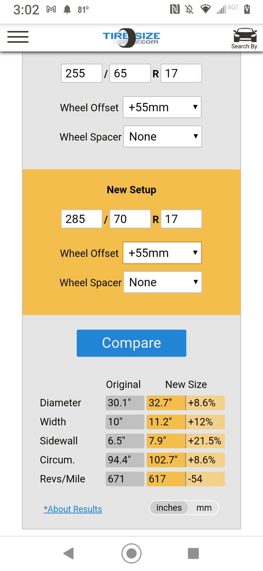

Well here's the set up with just bigger tires. They stick out almost 3 inches!
That's just too far!

Our stock wheels are a +55mm offset. That means the center of the wheel sits 55mm (2.16") inboard from where it bolts up. A -19mm wheel means that the center of the wheel sits 19mm (.75") outboard from where it bolts up. This means that the new wheel would stick out over 2.75" from where the stock wheel is right now.

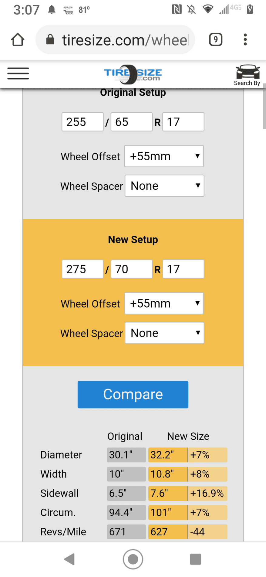

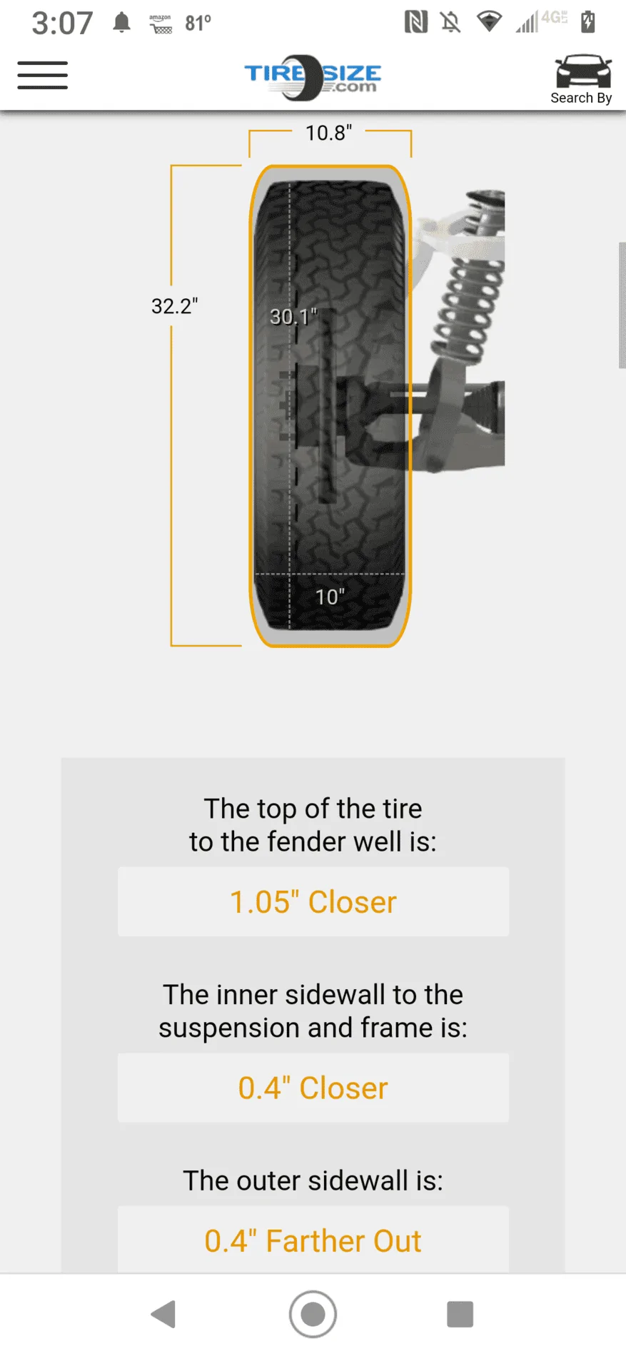

The way go, looks like for me, is with 275's and the problem is solved. 3" would mean fender flares. Not gonna do that.
Just keep in mind that the only tires available in that size are load range E. They are heavier and some here have complained about the mileage hit and ride. Others, didn't mind. I'm not trying to rain on your parade - really! :) It's just that I've read so many posts here about people who jumped into buying a certain tire size or wheel and then regretted it later when they didn't gather all the information they needed.
If it's the height you want, an LT255/75R17/c K02 is the same height as the 275, but 1/2" narrower. It's also 9 lbs. lighter.

The serious off road people tend to gravitate towards the load range E tires for a variety of reasons. Maybe they would be good fit for you?
