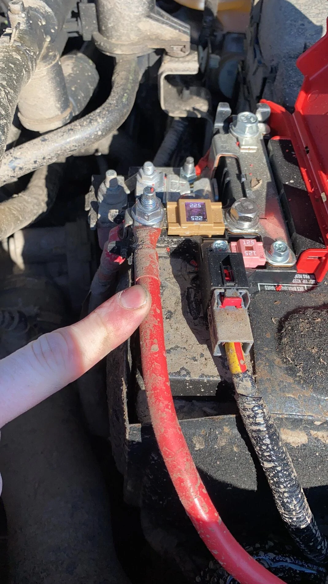

So I guess out of all 3 spots on the - , where should I attach for a winch ? From what I’m reading , the nut to the right of th post ?
Or the one that is connected to the chassis ? It shouldn’t be this hard
Ok I believe I figured this out, for ALL questions. The negative post for winches or jump start is this terminal where my thumb is at , or pinky , either will be fine. Attaching before this box at the main WILL send a spike to your your truck .

Who has been successfully running their winch and/or air compressor negative ground to the location indicated by the little finger above?
Mine is attached at the thumb , and I’ve had 0 issues . Haven’t tried the pinky spot yet

I've looked around and haven't found any documentation that limits this circuit grounding definition. The manual specifically shows jump start chassis grounding so short term amperage doesn't seem to be a problem.
