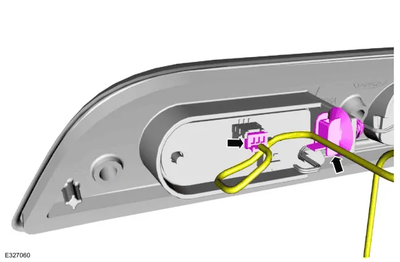

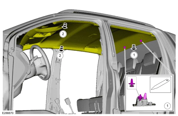

I have not done this, but from the diagram it appears that you have 2 -clips holding up the liner at the window.
Now you may have to pull the side pillar trim off to get the liner down far enough to get access to the connector, do this as a precaution as to not crease or bend the liner when you try pulling down on it as I do not know how much flex the liner will allow.
You do not need to drop the whole liner, just get the rear lowered enough to get your hands on the connector.
This step - APPEARS not to be required if you have OEM Led Light Assembly

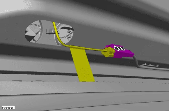

This is what you need to get access to:
If the OEM = (non-LED Bulbs)
If OEM = LED Bulbs, it appears that all you have to do is remove the light assy to get to the connector, thus the liner does not require to be lowered.
