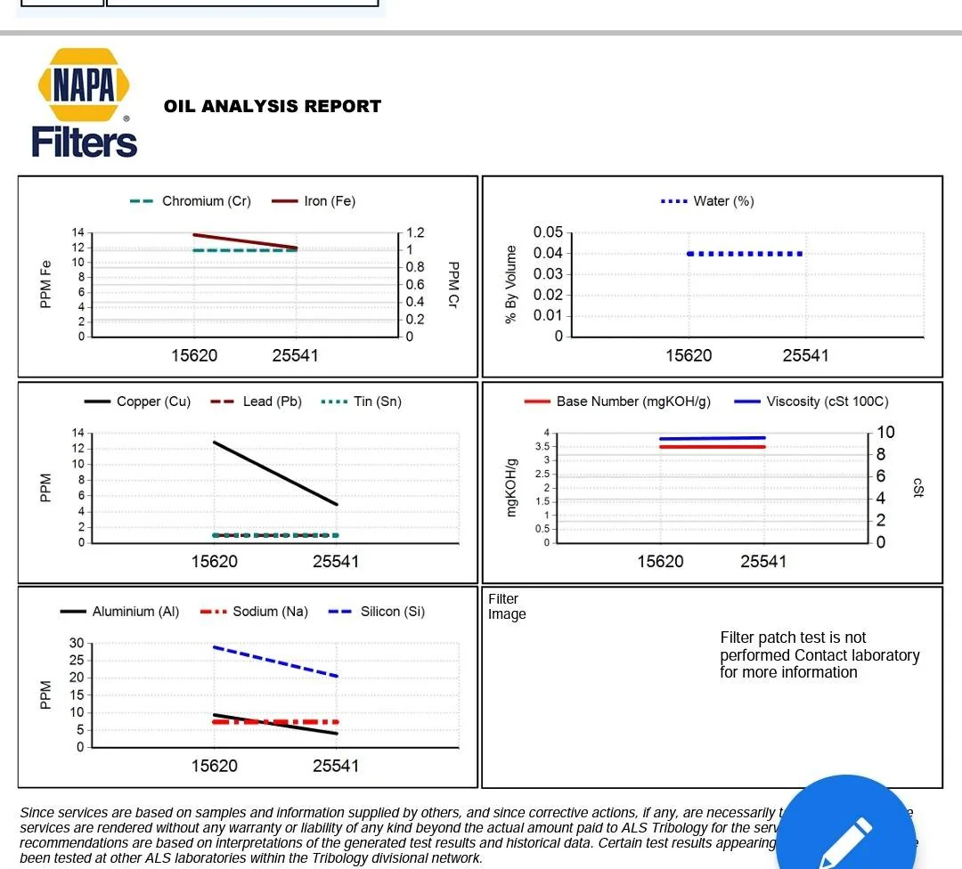

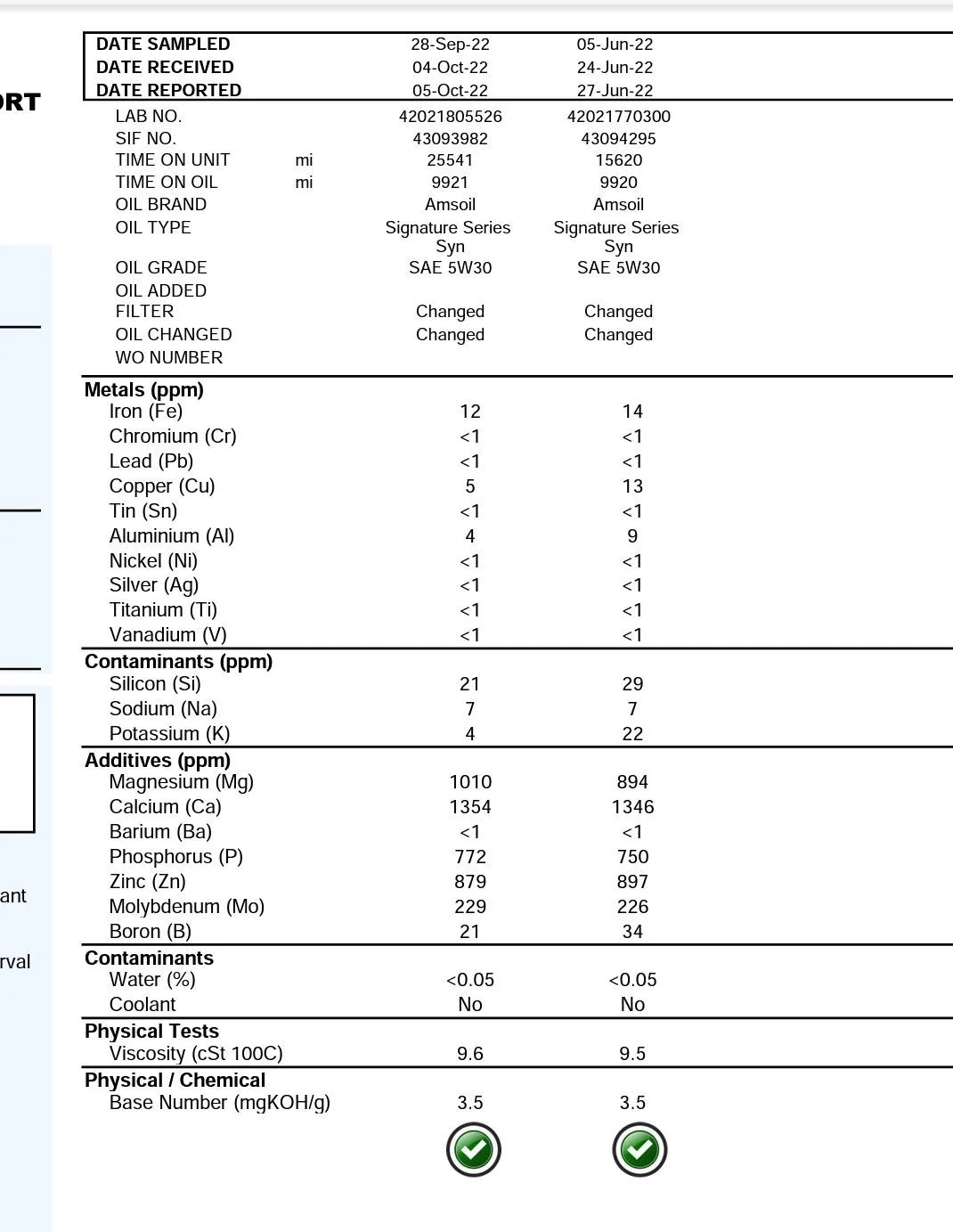

Another 9900 oil change using Amsoil Signature Series 5w30 and a wix XP filter. Results are great and the pottasium that I was worried about has considerably went down. What I completely dismissed was thier range for water and coolant was zero...all that worrying for nothing. I'm going to assume the potassium was something in there from the factory...who knows.
The oil change for my next run, I am using the same oil but will be using the Amsoil filter now that its back in stock. I dont think the results will be any different to be honest.
Link to my last oil analysis
https://www.ranger5g.com/forum/threads/2021-ford-ranger-oil-analysis.20459/

I had potassium read high on one of my reports. The folks from Blackstone said while potassium can be a marker for coolant, they didn't suspect a leak because sodium (another coolant marker) stayed low. In my report, aluminum was also on the high side, and they said that potassium and aluminum together on a youngish engine is suggestive of a harmless bit of intercooler flux working its way into the oil. It looks like your previous report showed the same trend (high potassium, normal sodium, and somewhat elevated aluminum), so I'm going to guess that we're both just breaking in our engines.

Man I wish I knew that a couple weeks ago when I was all nervous about it. Lol..
